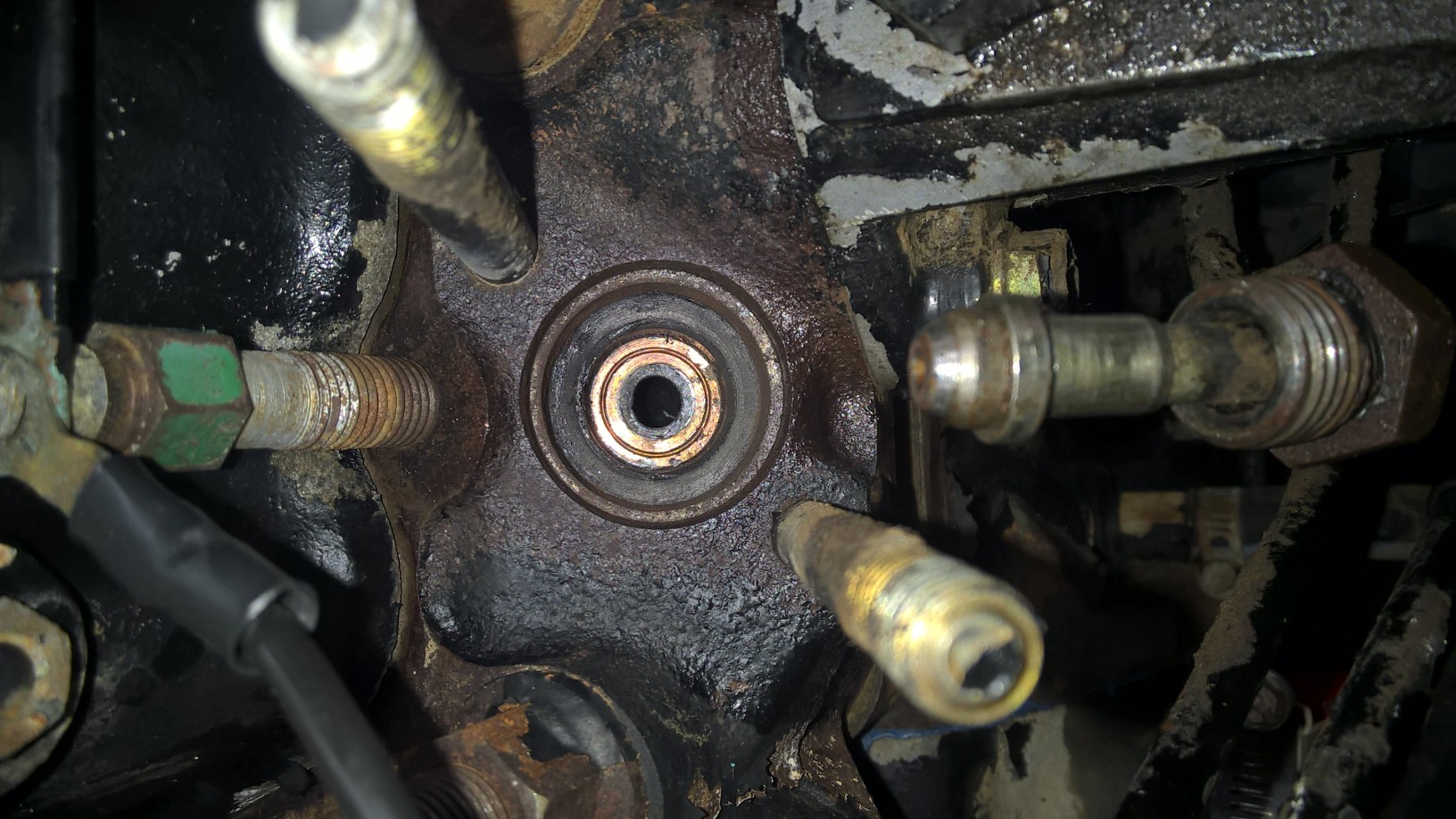

Yeah between the injector and head. When I squirt some brakecleen down there it coughs and carries on so am guessing they were never replaced/installed.
There are 2 copper washers, 1 fiber washer, & 2 chambers (upper & lower). It's unlikely they're not unstalled, since the lower chamber gives the injected fuel its spray pattern.

sounds like he was just using the fluid to detect changes in the engine sound at the injector that was sucking air. I don't think anyone here actually uses the stuff on a regular basis for starting their engine.

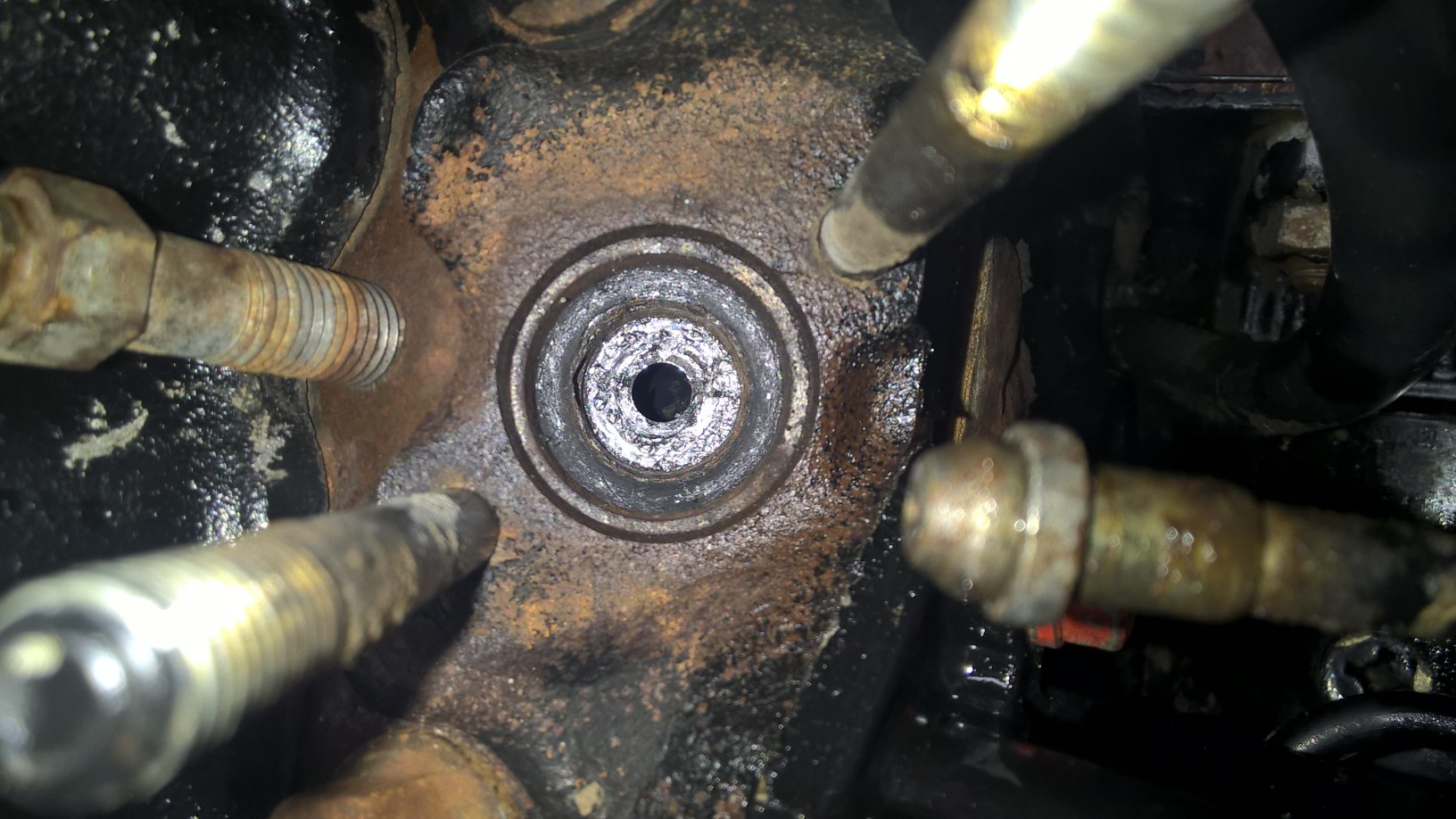

Correct, just to locate the problem area. I did pull it out to find one cylinder had 1 copper washer and nothing else, the other gooed up with something?

The seat on the second pic appears to be fairly well damaged from possibly chipping the old one away.... don't know but it's pretty well scratched up. Just going to have to seal it up again with some goop and see how it goes.

Yeah I will, checked the valve clearances too and they were OK.

I used thick copper washers for injectors seals and refitted with some high temp heavy bodied anti seize. It still runs the same. No better or worse.

It appears you need an upper injector chamber. Hoye shows out of stock.
