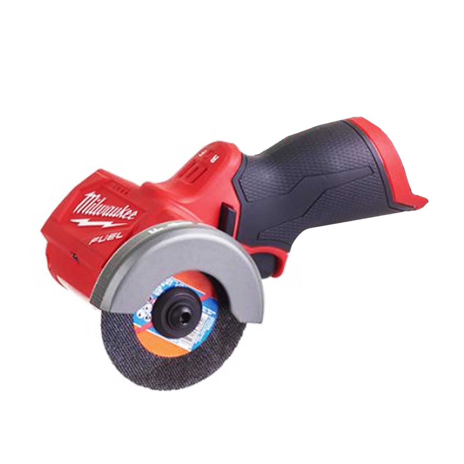

I have a bunch of crows foot wrenches, up to 50mm, but I could not find my 17mm. The 15mm is slightly smaller, and I prob would never use that size. So I ground it out with a Milwaukee M12 3" reversible angle grinder (nice tool!), and finished it with a file.
The body of the 17mm crows foot would likely be too big for the tight spot I was trying to access.
Is this the angle grinder? What is the benefit of it being reversable? s-l1600 MILWAUKEE.jpg

That's it, yes. Reversible allows abrasive cutting in confined spaces when the spin direction really matters. Come with diamond blade as well as cutoff wheel and shoe. Uses standard 3/8" hole, 3" diameter discs.
