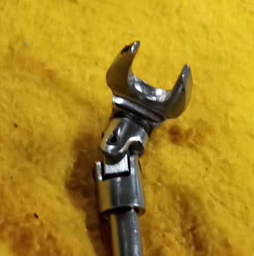

If you need to remove hydraulic lines from the stack valve, you may need a 17mm crows foot. I had to buy the entire set just to get the 17. really helped to get the lines off.
Funny you mention the crows foot wrench.
I took a 15mm crows foot wrench and ground it to be 17mm. It is still a very tight fit on one of the hose fittings. And I needed a universal link for the ratchet. I was going to post in a Repairs thread.
As for stack valves, I have had some where you must remove outside hoses before you can get to ones in the middle (my Bulgarian backhoe attachment). Fortunately my XN08 was not too bad.
Good job.
Good job.
Just to make sure I understand, you ground the inside of 15 to make a 17mm??. Thats quite an idea. Never would have thought of that one. Did you have a machine to do the work?
I allowed myself 30 minutes for the ISO to SAE swap. Took about 3 hours with a few breaks in between. The swap
was simple, but not easy.

I pulled the sheet metal off when I switched controls, which made it fairly simple. Pulling the sheet metal off was a bit more work.
I thought removing the access panel would give me plenty of room to get the lines swapped. about half way thru I considered removing the entire column, but I finally got it switched.

You know you're in a tight spot when you need a Crows Foot, on a Swivel, on an Extension!!crows_ft_17.jpg
I have a bunch of crows foot wrenches, up to 50mm, but I could not find my 17mm. The 15mm is slightly smaller, and I prob would never use that size. So I ground it out with a Milwaukee M12 3" reversible angle grinder (nice tool!), and finished it with a file.
The body of the 17mm crows foot would likely be too big for the tight spot I was trying to access.
Hopefully I will remember that trick if I ever need it. I had a complete set of SAE and several duplicates. a few metric, but no 17. I am not familiar with the Milwaukee you mentioned, I will check it out. Always looking for another useful tool.
50mm.. Thats gotta be expensive and hard to find.
