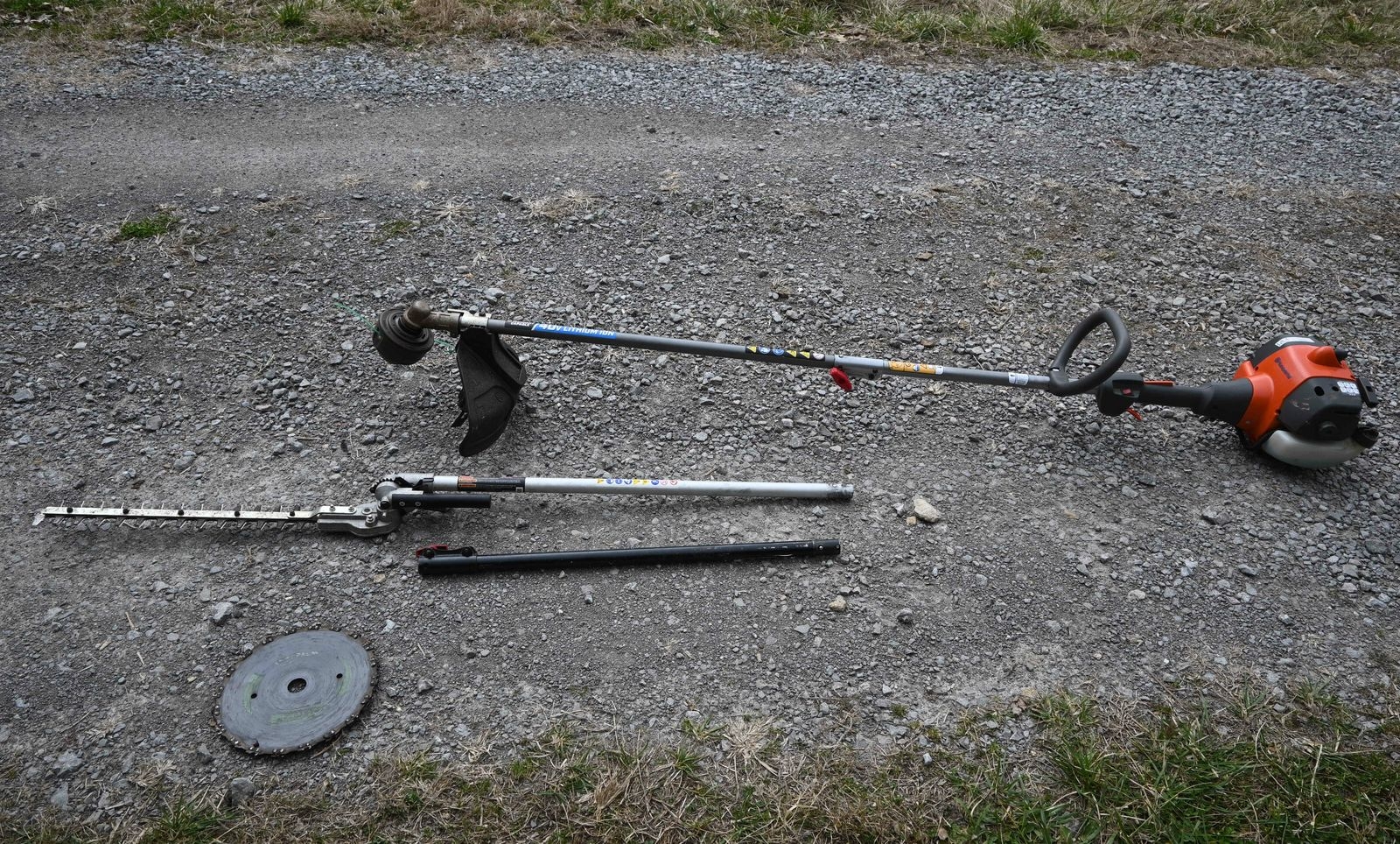

Until he puts some kind of cutter on the hydraulic motor, I don't know what the actual cutting performance will be.
I suspect there is enough power to run a hedge trimmer cutting head, but I wonder if it wouldn't be cheaper just to attach a two cycle trimmer and use the minix hydraulics to adjust the cutting angle as needed. You could have a pretty long reach provided you didn't get too aggressive and end up bending the trimmer shaft.
I've used a hedge trimmer attachment on a 2 cycle trimmer to mow briars and some light brush. It works, but it is tiring to wield the thing by hand for very long. It not only works, but it is very effective at chopping up a briar patch as well as vines. The minix hydraulics are certainly powerful enough to hold this kind of a cutter all day.
I'm not sure that the hydraulics could spin up a spinning cutter head enough for this kind of work, and it could throw debris at the operator where the hedge trimmer wouldn't do that.

Hedge trimmers are very efficient cutters. It's very nice to use them on a gas trimmer that puts me at some distance from the thorns, but the weight and leverage of the cutting head tires me out.
I would think it wouldn't be that hard to fabricate something to attach a trimmer to the bucket and then be able to tilt the trimmer to the appropriate angle. This style of cutter also has a ratchet head at the cutter that can also be adjusted for angle.
One possible attachment method would be to use a tube that can be pivoted and locked into position, and then insert the shaft of the trimmer into the tube. The tube could also protect the trimmer shaft from bending. You could also experiment with using extensions on the shaft.
The "slow" forward travel speed of the miniX may in this case be ideal for running a hedge trimmer type cutter. Fast enough to make progress, but not so fast that the travel speed overwhelms the cutting speed.
Once you get the miniX carrying the weight, it wouldn't be that hard or expensive to see how this would work in reality. Most people already have some kind of trimmer that accepts these trimmer attachments, and the hedge trimmer attachment itself is something like $80 on Amazon.

You may be on to something! I can see how this may work without a lot of $$. Maybe a small hyd motor could replace the 2cycle powerhead.
A small displacement motor direct-driving a carbide-tipped miter saw blade (10 or 12") would work here. For woody stems. For grassy stuff, I would go for the metal swing-blade trimmer head.
Surplus Center has a 0.8 ci motor for sale now for $30 plus ship and tax. It would give you just over 1000 RPM at 4GPM. Not a ton of torque (300 in-lb), but it would work. A 0.5 ci motor would be better, but hoo boy, prices are way up.
