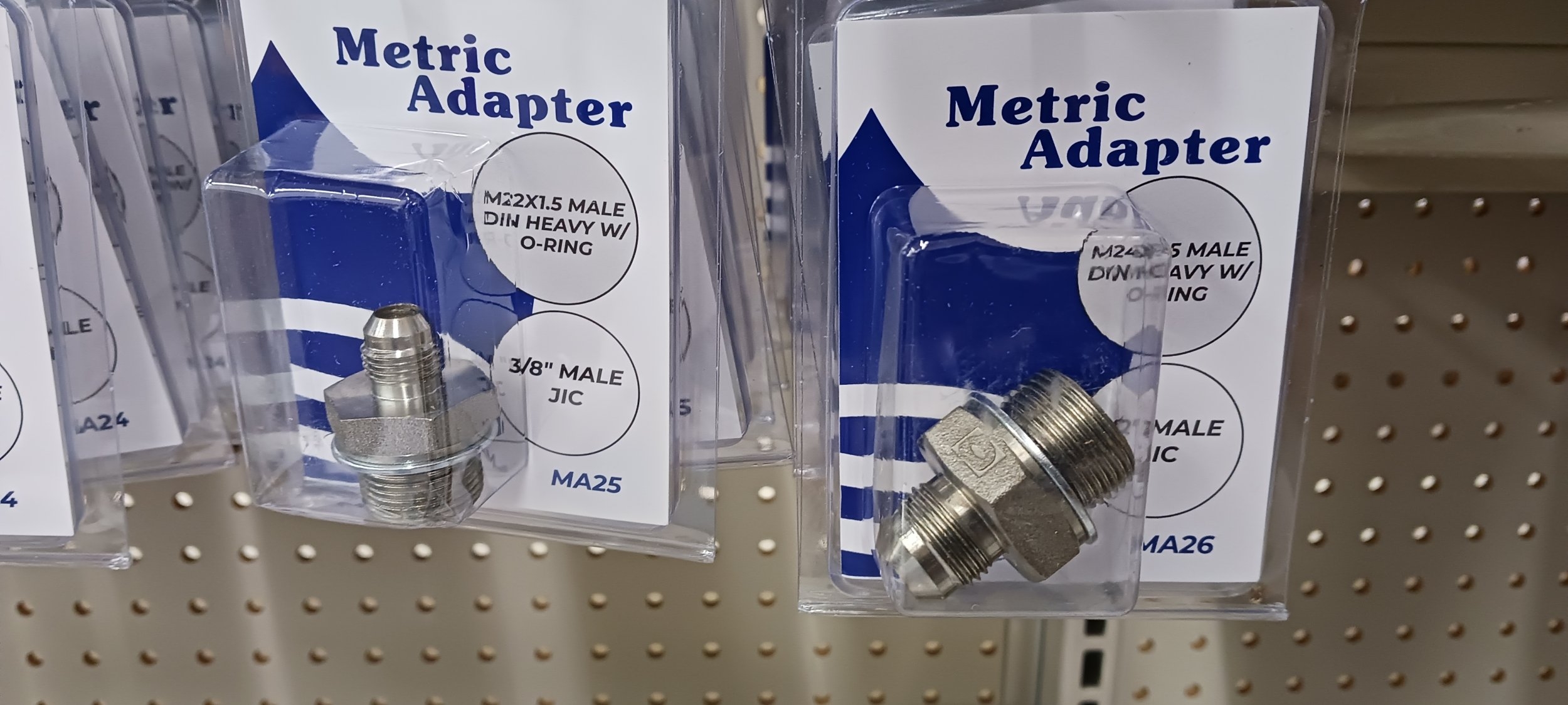

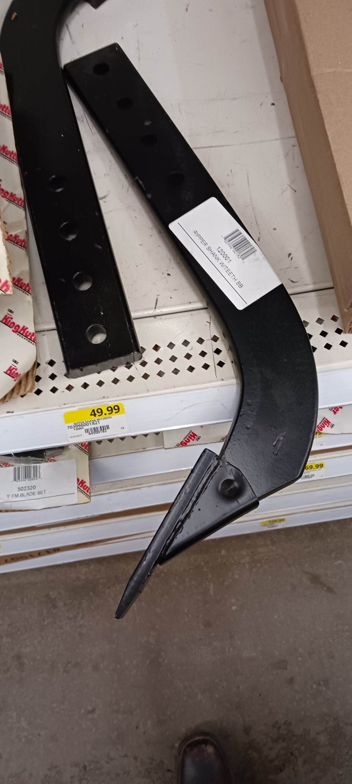

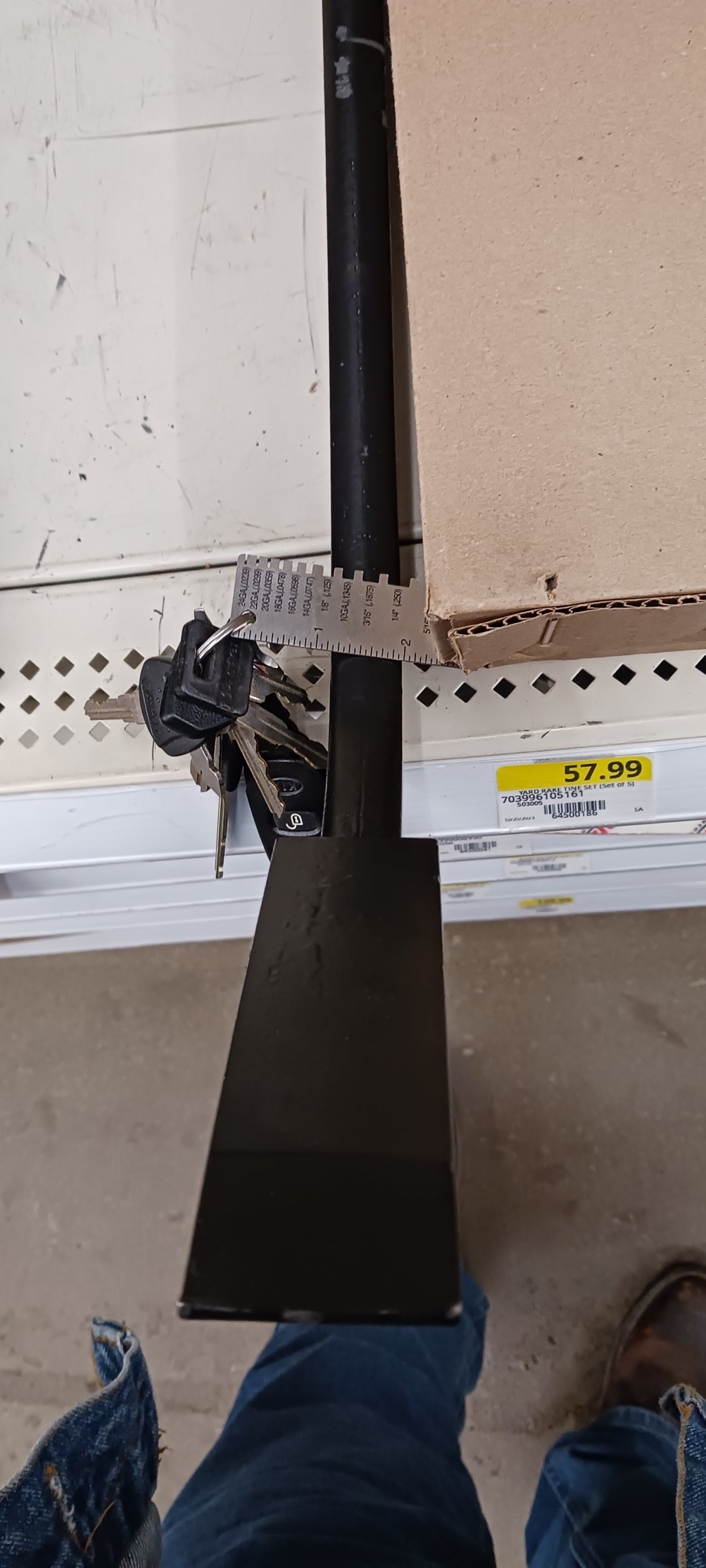

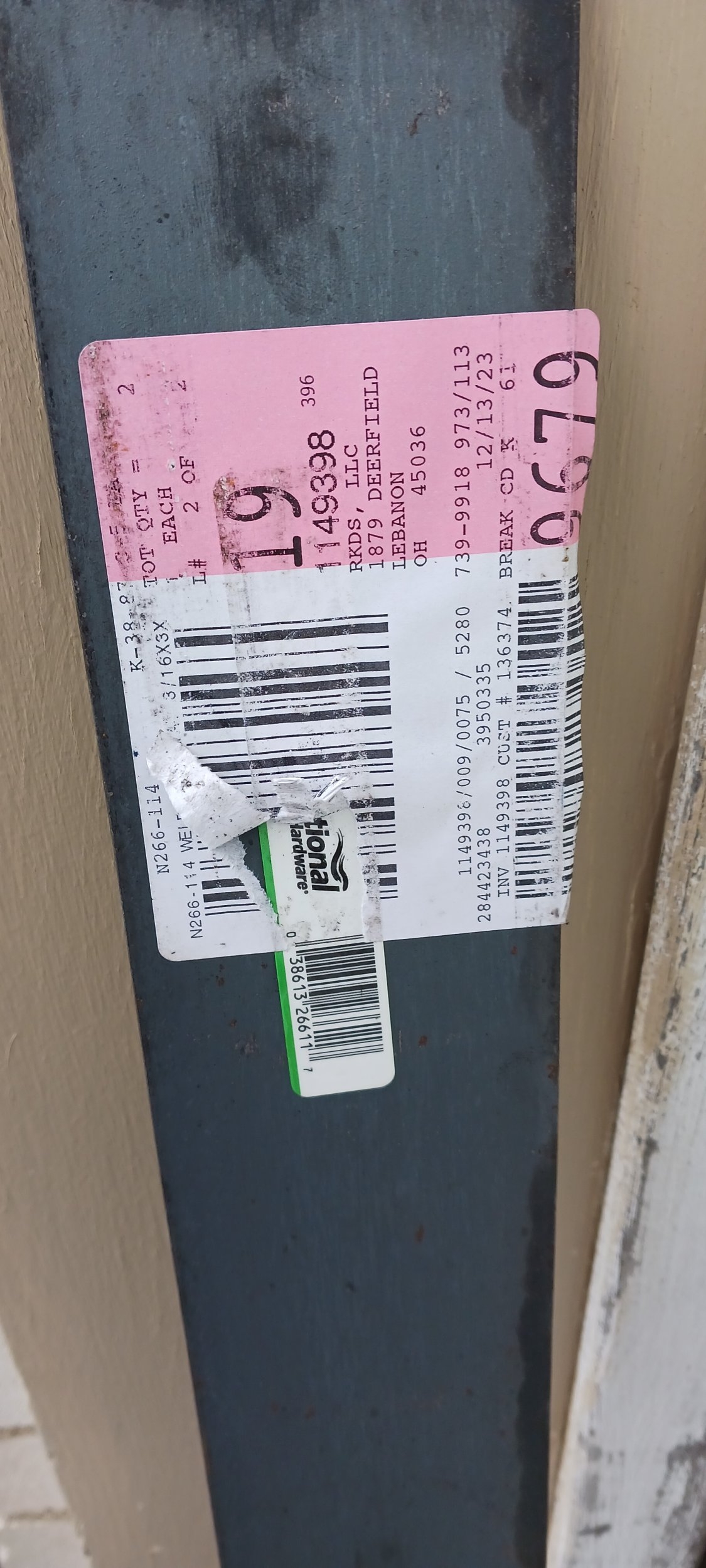

Today was too wet to get the baby-x out, so I went to Rural King and bought a few things for the next mods. no 1/4" flat steel, so I bought 3/16x3"x48". I want to take off the side cutters and weld on a strip of steel as a reinforcement. then I am going to weld a strip across the bucket and attach the d-ring and or chain hook. I also bought the hyd filter base and looked at the adaptors. The only metric adaptors I found are 20231229_130246.jpg DIN to JIC. Maybe I will need 2 adapters on each side of the base. DIN to JIC then JIC to 3/4" FNPT..I also looked at something maybe I could use to make a ripper.20231229_102114.jpg20231229_102015.jpg20231229_100712.jpg
