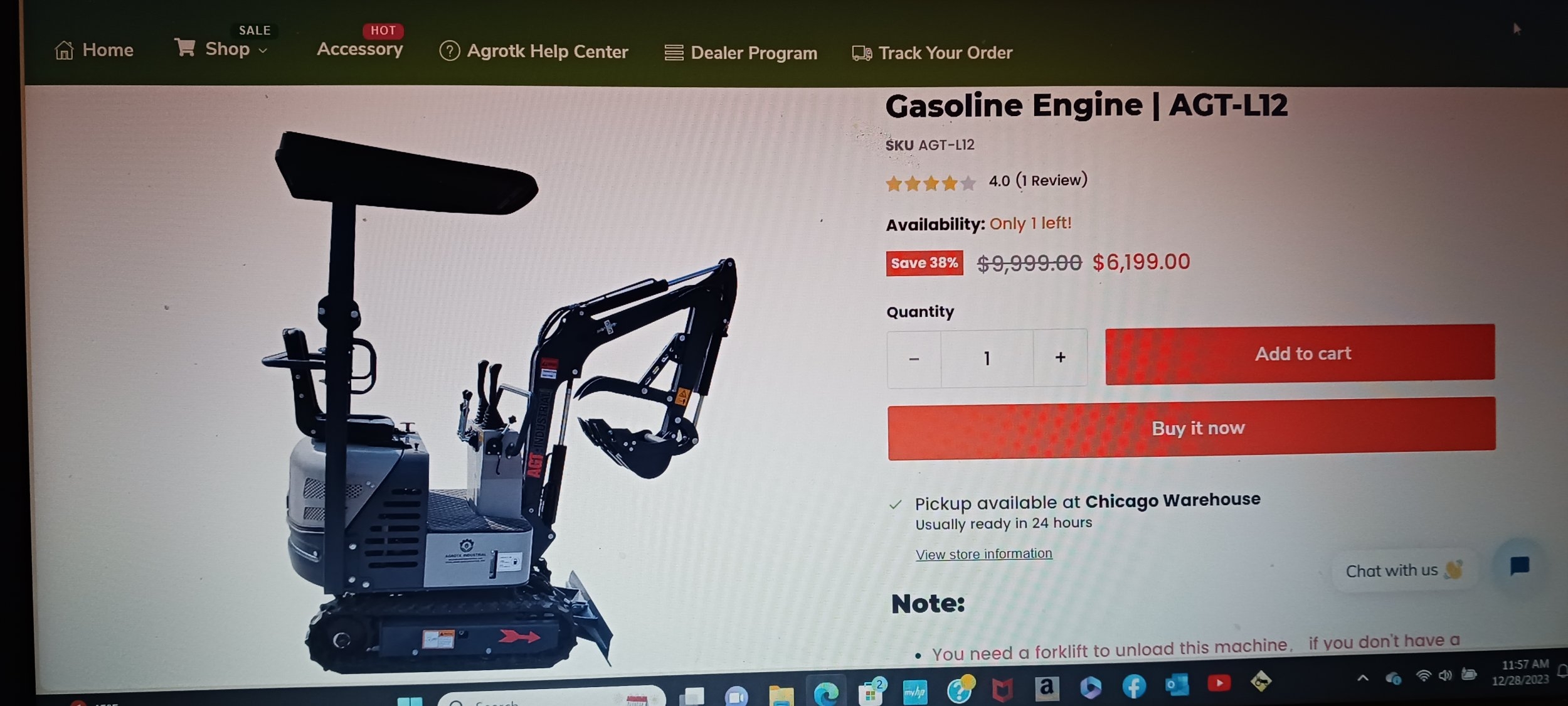

Sounds like you have a good plan. If I had the option to have the hydraulic thumb installed when I purchased my L12, I would have done it.. Its nice that you have a dealer close to you. there is a newer model of the L12 and it appears to be better than mine. My L12 has the cooler and fan for the hydraulics but not the hyd filter. the filter is necessary for longer life of the hydraulic components. I will be adding 1 when I can. If the L12 your dealer has is grey or black, its probably the newer model. either way this site will be here to help you if needed.View attachment 841090
The dealer near me doesn't have any grey or black. He has red ones like yours and yellow ones that say Agrotk.

Agrotk has a sale on the DY14. may be better and heavier than the L12. 6999. very nice looking machine.
