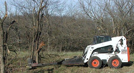

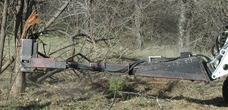

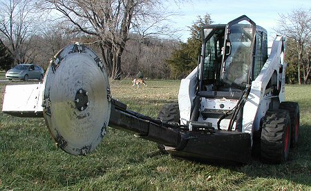

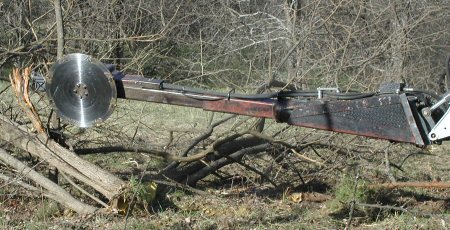

I cleared 5 acres of hedge, locust and cedar trees last Fall. I found a guy in our area (Kansas) who had a fantastic tree saw to drop the trees. He could cut anything up to 24" in diameter almost quicker than I can tell you about it. Incredible machine, pictures attached. He'd limb the trees first. I would follow behind him with my tractor and grapple and move the brushy tops to a pile then he'd return and drop the tree at or below ground level. His machine didn't mulch anything, but I wanted the wood for both fence posts and firewood. He charge $70/hr. which I think is a bargain. He cut 5 acres of trees in less than 2 1/2 days . . .This method gives you an excuse to buy a grapple . . .a remarkably versatile and useful tool.
