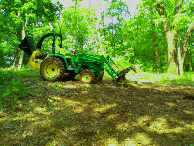

I agree with Soundguy. I had a few acres along with a mile of trails cleared two years ago by a Linkbelt (161?) excavator and a JD 450(?) dozer. All my maple and birch trees were stacked in piles. After I cut the stumps off they buried the stumps in holes. Nice and level, where possible, and free of boulders and stumps. They even leveled out my hilltop forest trail and moved many boulders hald the size of a VW bug.
It took them two days and only cost me $2300 cash. With the price of fuel I am sure it would cost $3000+ to do it today.
It was a mess at first (see pictures) but it all grew in nicely. You will get an idea of the grade and hill size in the last picture. That's my house (w/red metal roof) way down there at the bottom of the hill.
