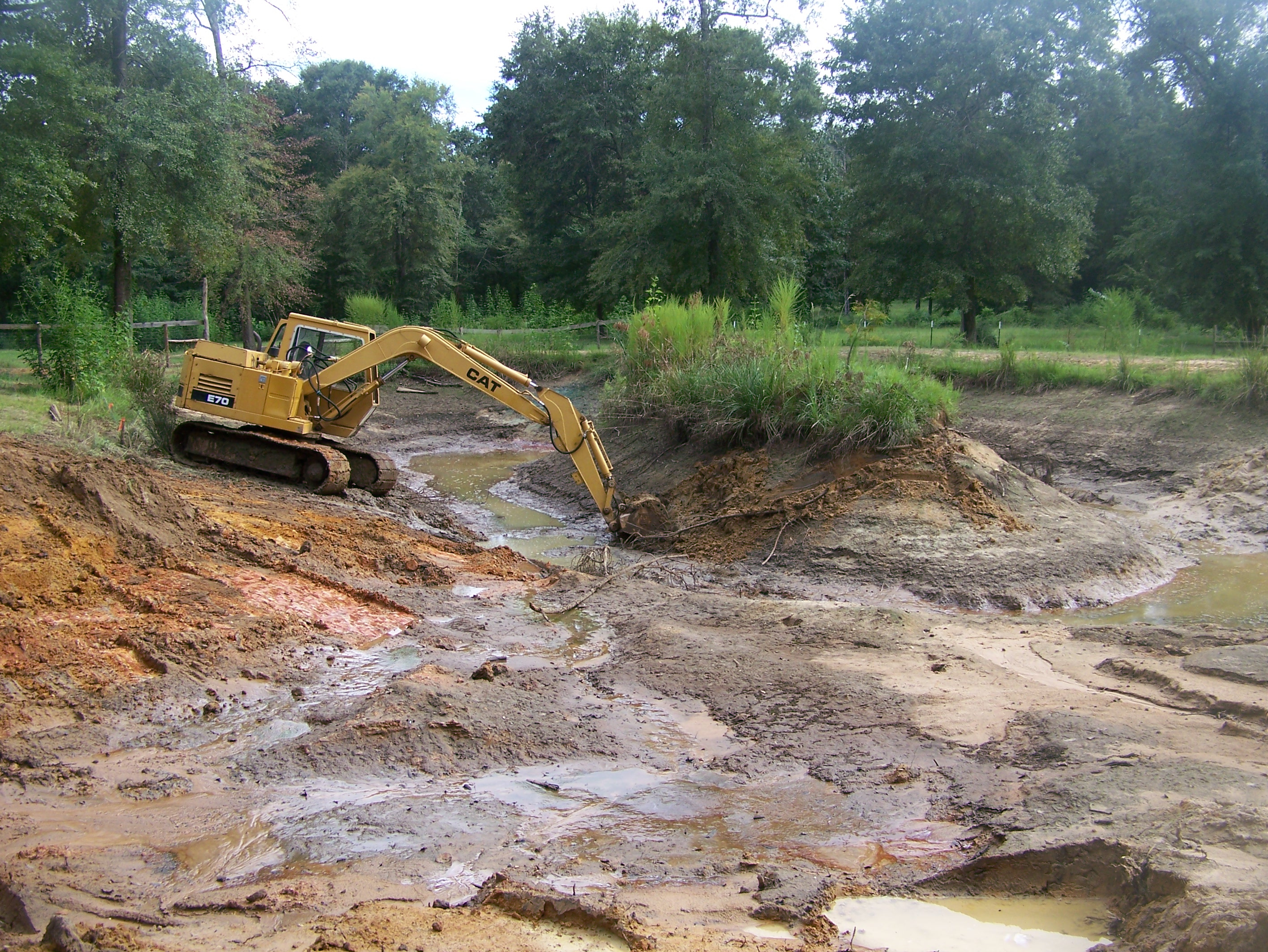

Glad you stopped Brandi, that would have been a scary slide
Yeah, the island stopped me. The fresh clay marks on the end of the island are from the bucket. The boom kinda wrapped around the end of the island.

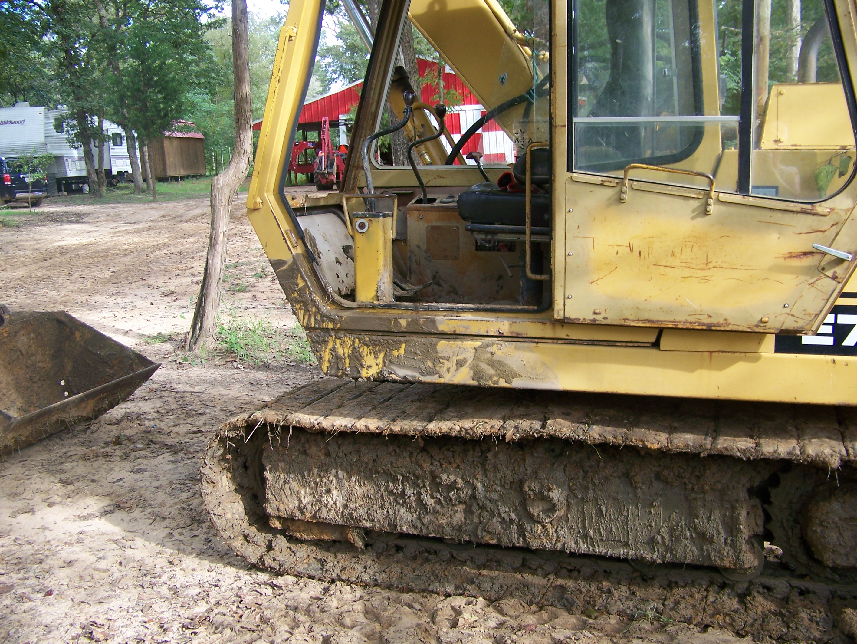

The cab corner slide down into the water and muck.
I was too shaken to get a photo of it stuck in the bottom. I just stepped out the door onto the island after sliding to a stop. It happens way fast.

An excavator is made to dig lifting up, from the pics to dig out the island ?? I would have made a dry level spot and clean the the mud off between that island the dug any good dry dirt and filled it in hole I dried up and walked out on it and did my thing. If you have no dry dirt to set on you need matts or some trees to place under you. NO ONE will try to dig with a hoe down hill in the mud, you created your own hell. From the pics we have no idea what you were scratching around for and what you were trying to do...I would guess trying to remove the island? dressing up would be the last part, all you did was make more mud and a mess.
Hill billy pads are common place in steep hilly country, when you need shoulder harness to keep you in the seat. and you are tied off to a dozer with a winch thats in a nest. BTW that is what the eye is for on the track frame. You sure don't need any thing special for working flat.... jim

Goes to show you can't write assumptions from one photo. I was just back grading the bank in that photo. When I took out the island, I made myself a causeway and added mud matts when I was taking the island out. Maybe you need to read this thread, then you can come back here and chastise me. You can also see, after my slide, I build perches. So go get over yourself.
You can start reading at post #393 where I took out the island, or read the whole 48 page thread to see how I moved the dam. Your choice. Instant Pond
