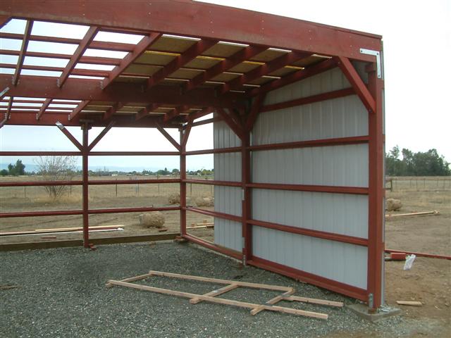

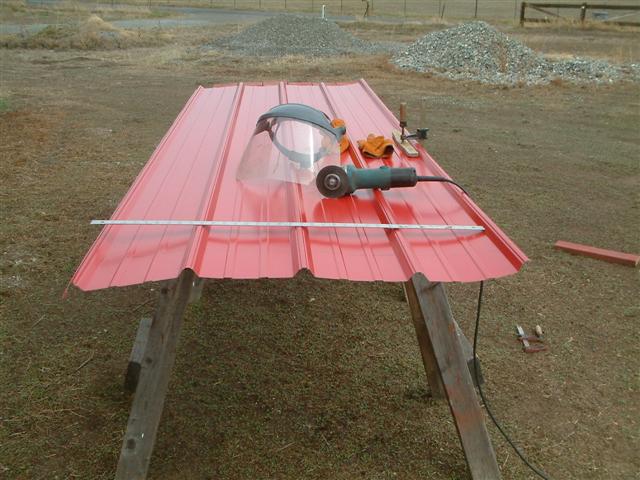

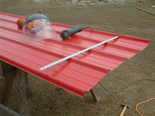

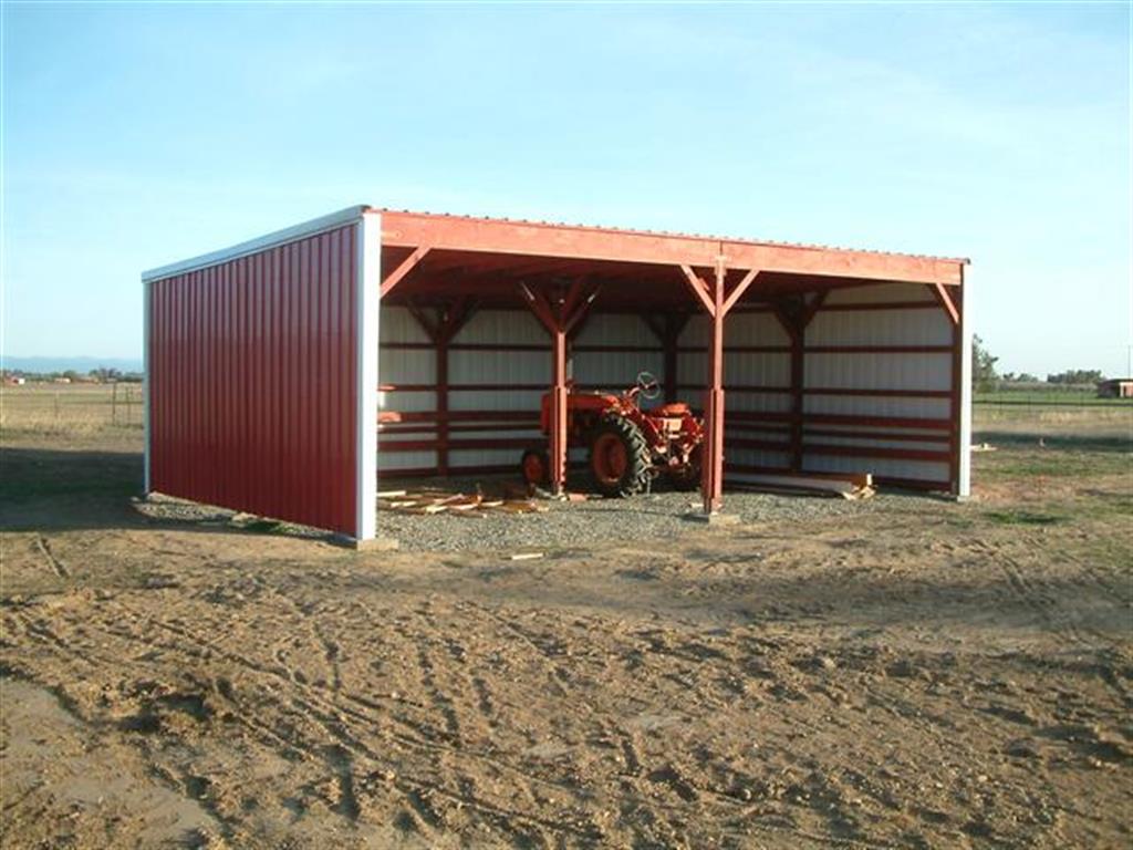

I used a 4.5" angle grinder with cutoff blades to cut the metal panels for my equipment shed.
Equip shed finished-1 (Medium).JPGEquip shed-3.JPGEquip shed-2.JPGEquip shed-1 (1).JPG
Good luck
I thought about that too, but I'm not sure I can cut a straight line that way.
