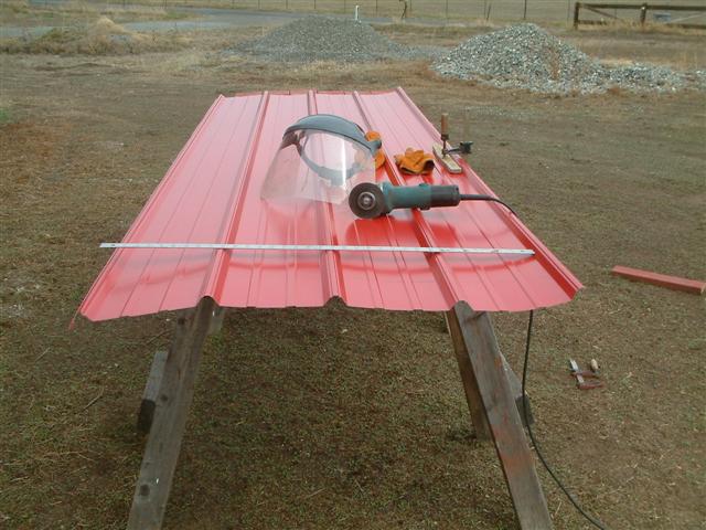

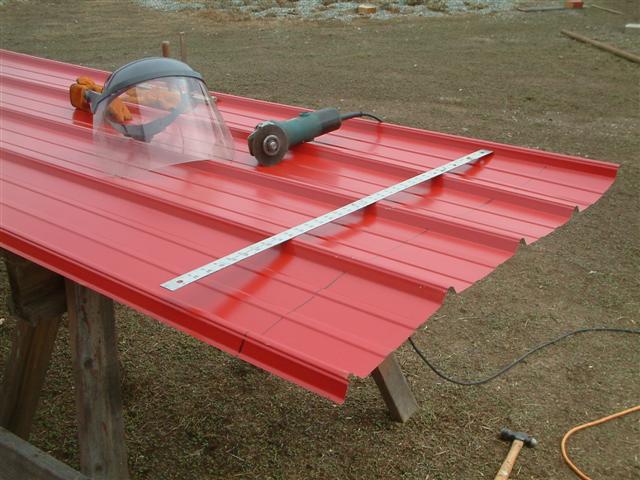

I
Well, it does burn the cut edges a bit, but I'm not sure why it would be an issue for areas of the panel not cut. Then again, shears and nibblers leave an open metal edge too.
When i was considering doing a metal roof, i went directly to the factory for Metal Sales (a major manufacturer/supplier of metal panels in this area). One of their tech guys was kind enough to walk me through the general installation procedures and one of his key points was never to use any sort of saw to cut panels (shear/nibbler only). The dust or chips that come off hot end up embedding in the paint and damaging it, causing rust. And that was not covered by warranty. So I would agree with what the previous poster said about teh paint warranty. Now if it's a barn or shed and you don't care, then go crazy...
