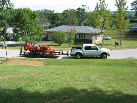

never rolled my 23, this is my front yard, about 70 feet and steep. I cut this either up and down or diagonally. While i have gone side to side with the 23, this not something I want to do regularly.
Got stuck once when the dipstick operator ran over a drive way border in the snow, it was either down hill and no control or dig it out, put in boards and drive backwards.
