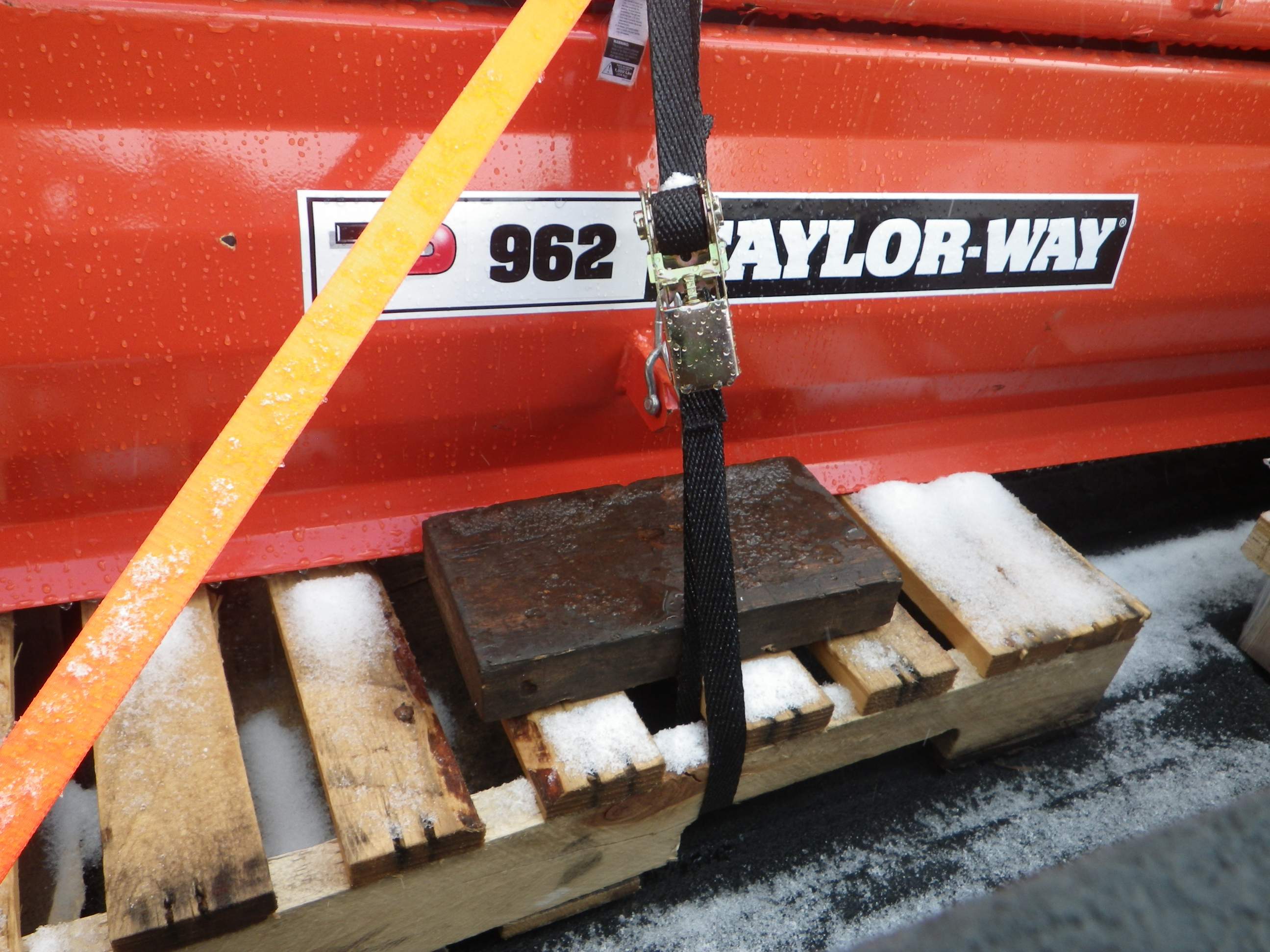

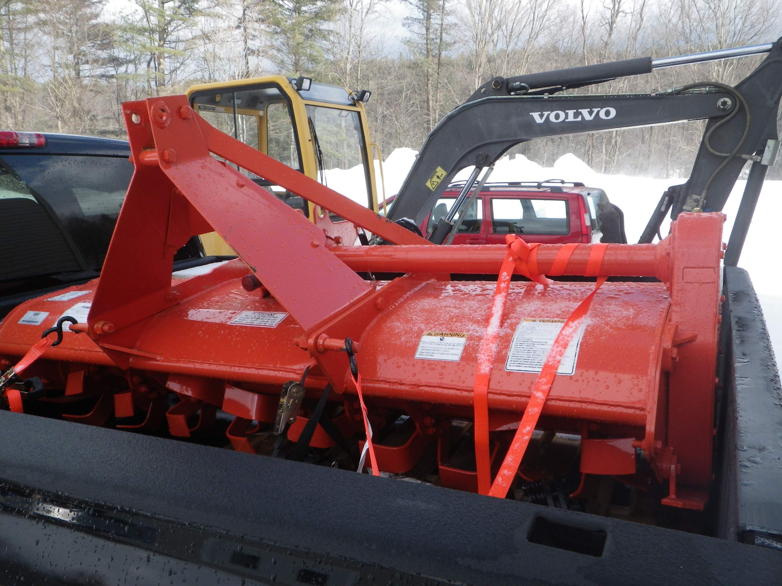

This Summer I will try to advance the timing a couple degrees and see what happens, have not been impressed with this machine. Picked up a 6 foot Taylorway 962 tiller yesterday I hope the machine runs it well.
