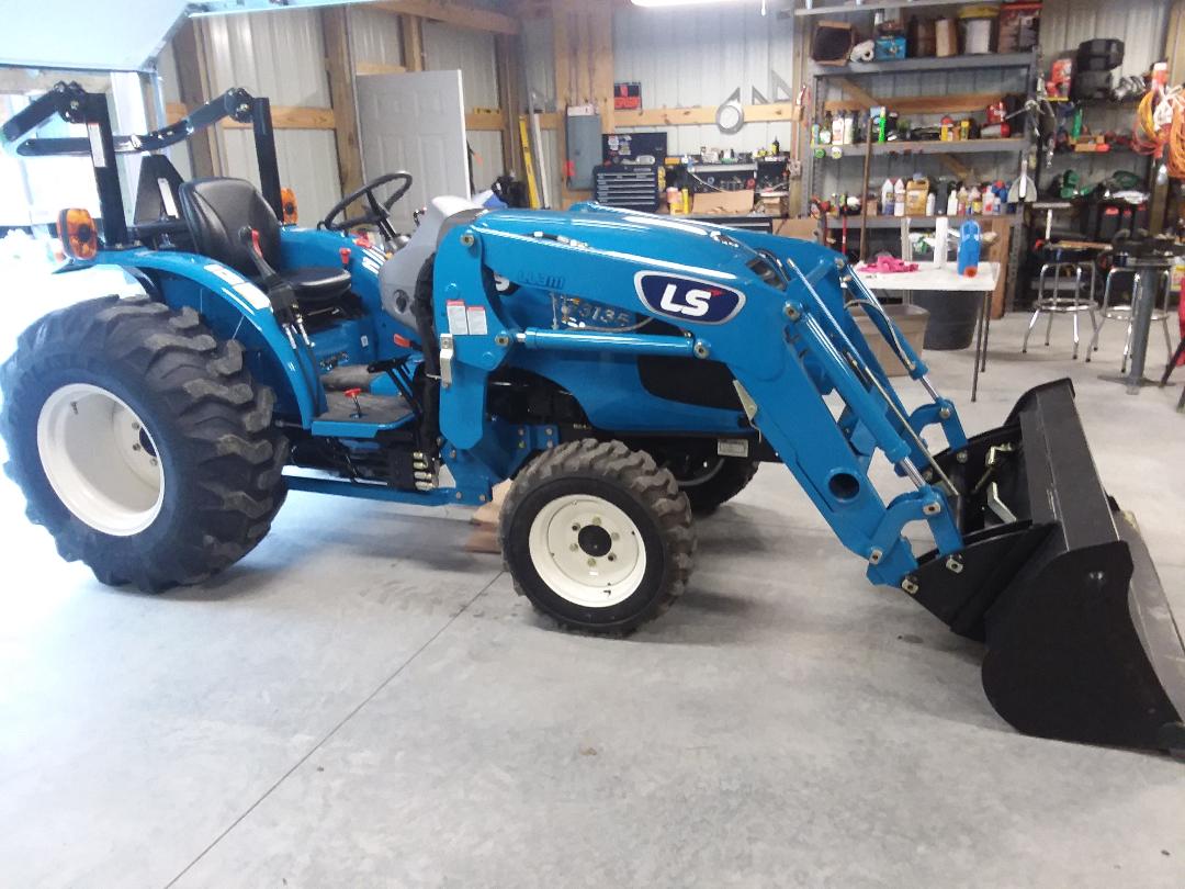

I have a 2018 XG3135 Shuttle shift. I just turned 40 hours on it. So far I have done lots of loader work. Some bush hogging and some other small projects. I have a small 19 acre tree farm on middle Tennessee. So I needed a tractor and so far its been great. Only problem I have had is my 3-point shudders a little when I raise it slowly. I have read where others also had this and it goes away in time. Most likely air in the system. What I don't like about it most is the lack of rear remotes. I should have negotiated those in during the purchase. Oh also mine has gone though regen twice already. 21 hours and 31 hours. Apparently I idle too much. Got to keep the RPMS up over 2000 to extend the regen cycle. If you have any questions let me know.

Try adjusting that black knob below your seat.

What's the idle speed on these new engines, the L3C19-T...??
I don't know about Tractor Diesels but on my Cummins........ They like to be run. Starting and stopping them a lot, they don't like, especially when they're cold. The DPF fills up and needs burnt off.
Do you check your oil to make sure the oil isn't 'growing'? On some of the older truck diesels (just a very few short years) the crankcases were filling up with fuel because the injector was kinda inefficient. It was why their OCI (oi change interval) was so short. What is the recommended OCI on your
I don't know how the regen mode in the new LS engine works. Does it squirt fuel into the combustion chamber on the exhaust stroke a'la Ford and Cummins (diluting crankcase on older models) or does it have a separate injector (the famous 9th injector) like on the GM (Isuzu) engines that shoots fuel into the system outside the combustion chamber?
On my Cummins, I take it out and make sure to run it long enough to make sure it gets hot enough to burn off the nasty in the DPF. I've never gotten the light that says I'm going through a regen but I know I do. I can smell it. Smells like burnt rubber. Once in a while, when I get out of the truck, I can catch that smell. Means I interrupted it while it was going through a regen. As soon as I get it back up to temperature next, it will complete the regen. Not a big deal. Is your diesel different than that?
