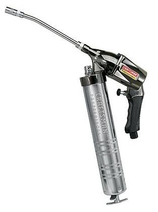

I've had this Craftsman air powered grease gun for 6 or 7 years and it's still working great...
Grease gun update.....
This gun is now in the scrap pile and I've replaced it with a conventional pump style...........:thumbsup:
