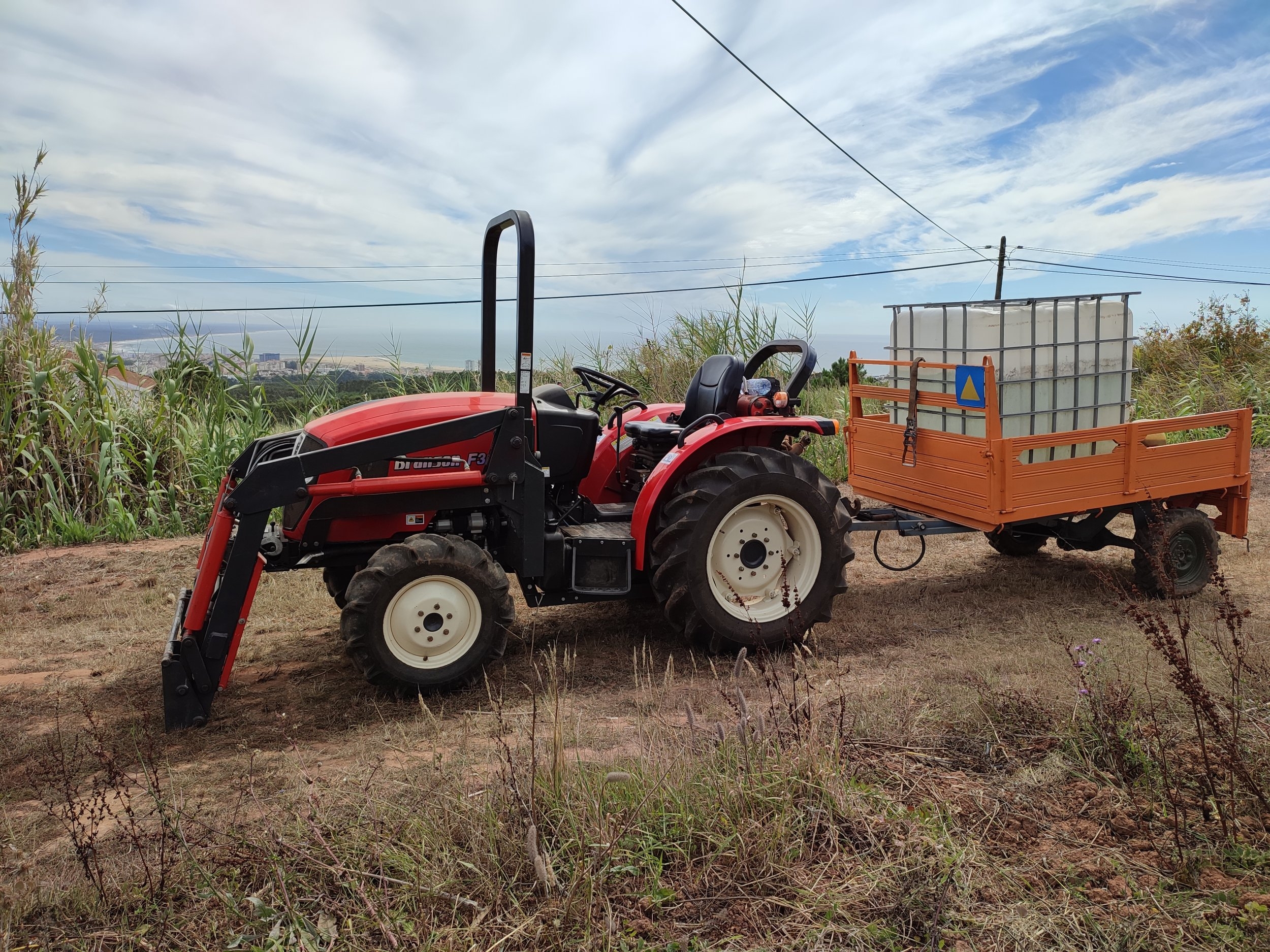

I've got a water tank trailer and a pump... but I haven't hooked it all up together yet, going to be some interesting plumbing and I need to procure some suction and discharge hoses...
I've been procrastinating too. Should have the setup ready 2 months ago. We already had a couple massive fires in the country, so far nothing in this area where I have the tractor but it's about due.

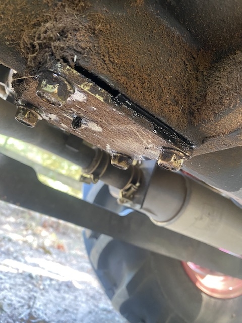

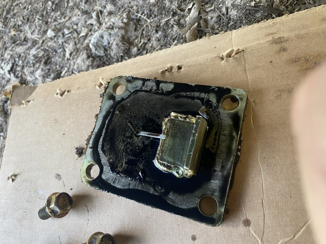

I removed the inspection plate and had a look around. Best I can tell it is the rear main seal. I also removed the starter and went between the flywheel and back of the motor with my camera but could not tell much as I was seeing more of the top side of the crankshaft. But I did go to the bottom of the bell housing and see some evidence of the leak.
Called dealer and they said is should be covered under the power train warranty. Hope they are correct. I will take it to them next Saturday.
Pic of the plate after I loosened the bolts.
Pic of oil on top of plate.

Well, it is at the dealer as of this morning so they can start the warranty process. It will be interesting to see what they come up with. Also will be interesting how well TYM supports the Branson line that was built before they purchased Kukje.
I expect this to be a long process if they approve the repair. I will keep everyone updated with any progress.
Update;
Got a call from the dealer and they suspect a leak on the front drive line seal. They are going to fix it under warranty so that is great. But I asked them to pull the bell housing cover and look at the top of it because I am almost certain that is motor oil. It is too black to be gear oil to me. They said they would look. So I may have more than one leak which is disappointing to say the least.
The tractor just has not been worked very hard at all. Mostly mowing in 2WD. Pulling the land plane to help my brother is the hardest it has ever worked and that was just a long day and should not have been an issue. But I was pulling in 4WD on that job.
I will say I feel very blessed to have a great dealer that is willing to help! So many times we hear of dealers failing their customers but mine is doing things the right way. More to come!
