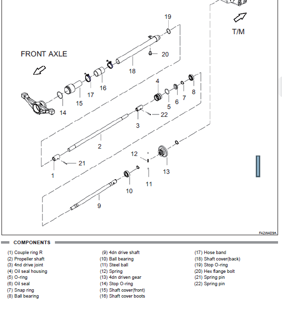

No, you don't. There two splined couplers that hold the driveshaft in place. You punch the roll pins out, slide the couplers back and you can pull the drive shaft out easily. Then just do the seal on the front axle in place.
The manual for the 2515 is available in the Bad Boy website, which is currently all messed up and can't get the link right now.
EDIT: Found it on another thread I had shared previously: https://badboymowers.com/images/tractors/manuals/2021_BBT_Service_Manual_40_Series.pdf
Just found the time too look in to it. Opened the bell /shroud of the coupler closest to the front deferential. Everything is as dry as a bone, so, the leak is not from the front deferential seal.
Any thoughts?
   / What have you done to your Branson today? #1,509
I think the #5 or #6 or both are the problem, not the front diff seal.
   / What have you done to your Branson today? #1,510
Any thoughts?
Ok, now pull the same plate on the other side of the driveshaft with 4 bolts. This will expose the coupling on the transmission side.
If the leaks happens to be the seal #6 or the o-ring #5, it's still an easy fix with the worst part being having to drain the transmission oil. Branson made it so you can just pull the drive shaft out, and the pop out a sleeve the has the seal #6 and o-ring #5 without having to split the tractor.
