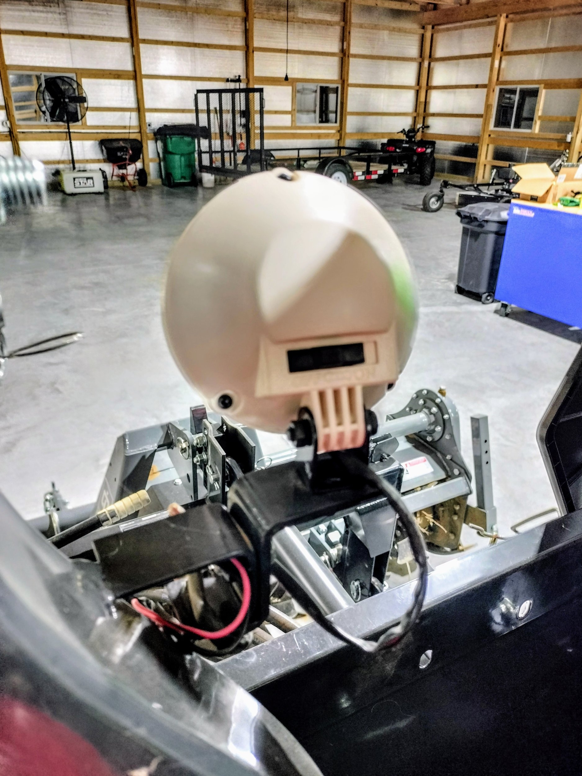

Planning to add an LED rear work light. The stock light is sad. In the summer I prefer doing work as the sun sets. Adding a waterproof box to mount the waterproof switch inside for a nice clean install. The OEM has a switch on the light, this one does not. But I should be able to work at night with no visibility issues!

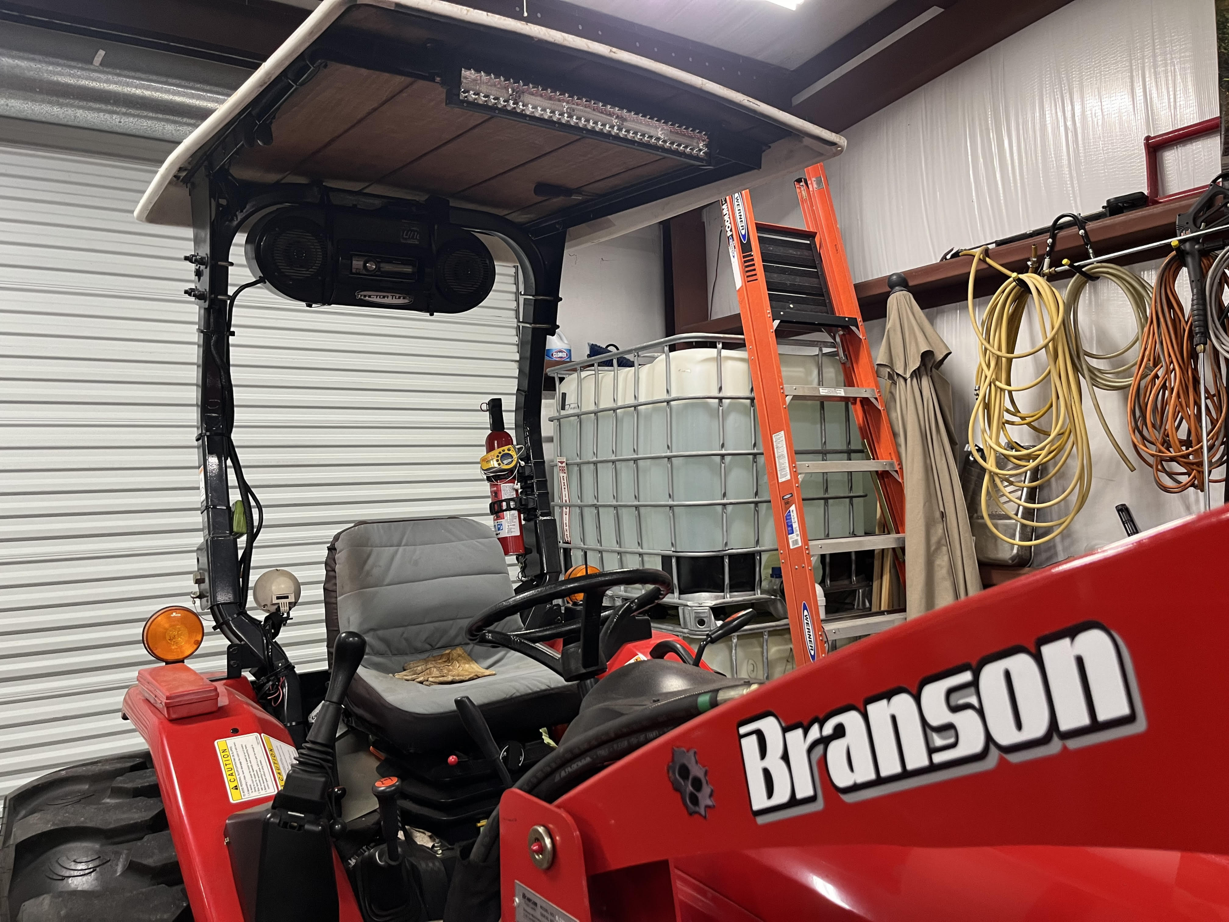

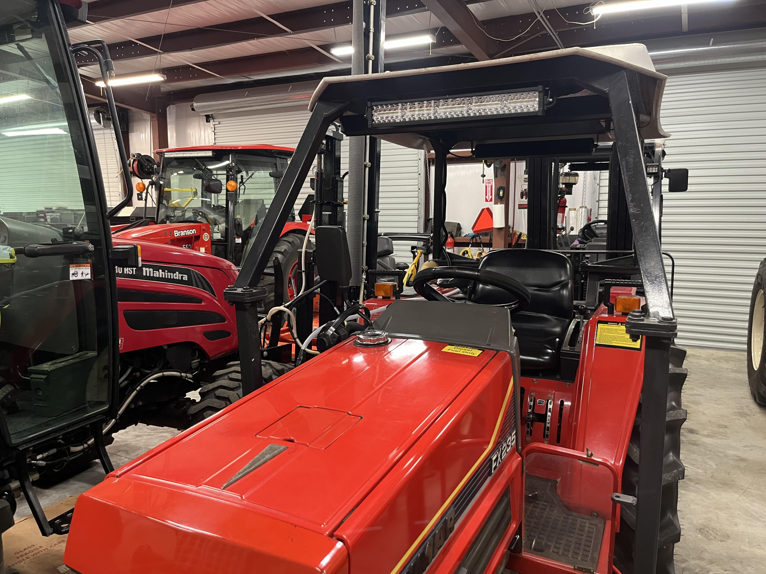

I mounted a couple 24" light bars on the ROPS, one facing forward, one backward. They've both gotten mashed into branches (while clearing land) so currently one is bungie'd on but it still works and is effective. I intend (sigh... such a long list) to re-mount them properly with a "real" switch box - they've got temporary switches that they came with (at least they did come with relays - pretty decent setup for the price) that come out of the dash at a joint for the moment - and adding a couple other lights on the verticals of the ROPS would be ideal to get more "flood" fill.
The forward-facing light bar gives great light for loader work - no complaints at all. As I said, side light would be good too so I don't feel too tunnel-visioned by the very bright area in front. The rear-facing light bar I use for maneuvering and also backhoe work; unfortunately the backhoe seat is up higher so my head intrudes into the light beam when it's pointing down at what I dig. If I dig at night I find myself leaning to one side or the other. Particuarly with backhoe work side-light is more important, because you may not always be digging straight back and you swing the boom to either side to dump buckets. Last time I needed to backhoe at night (three weeks ago) I actually wore a head lamp and it was surprisingly useful for side-lighting, but I'd prefer more big LEDs.
There are some curved light bars which seem pretty cool for better "flood" but IMO they're not curved enough to flood the immediate area; they're more for periphery lighting while driving at medium+ speeds.

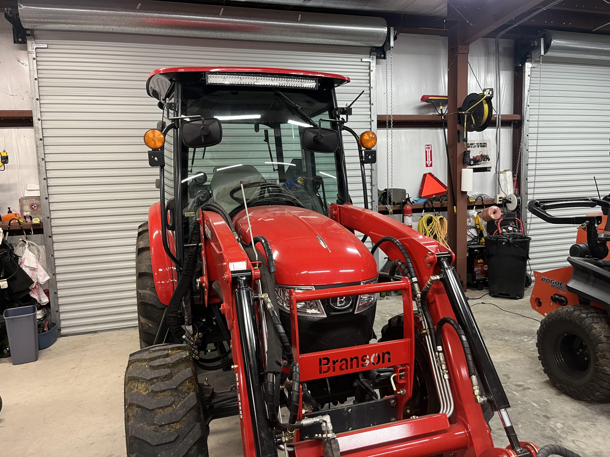

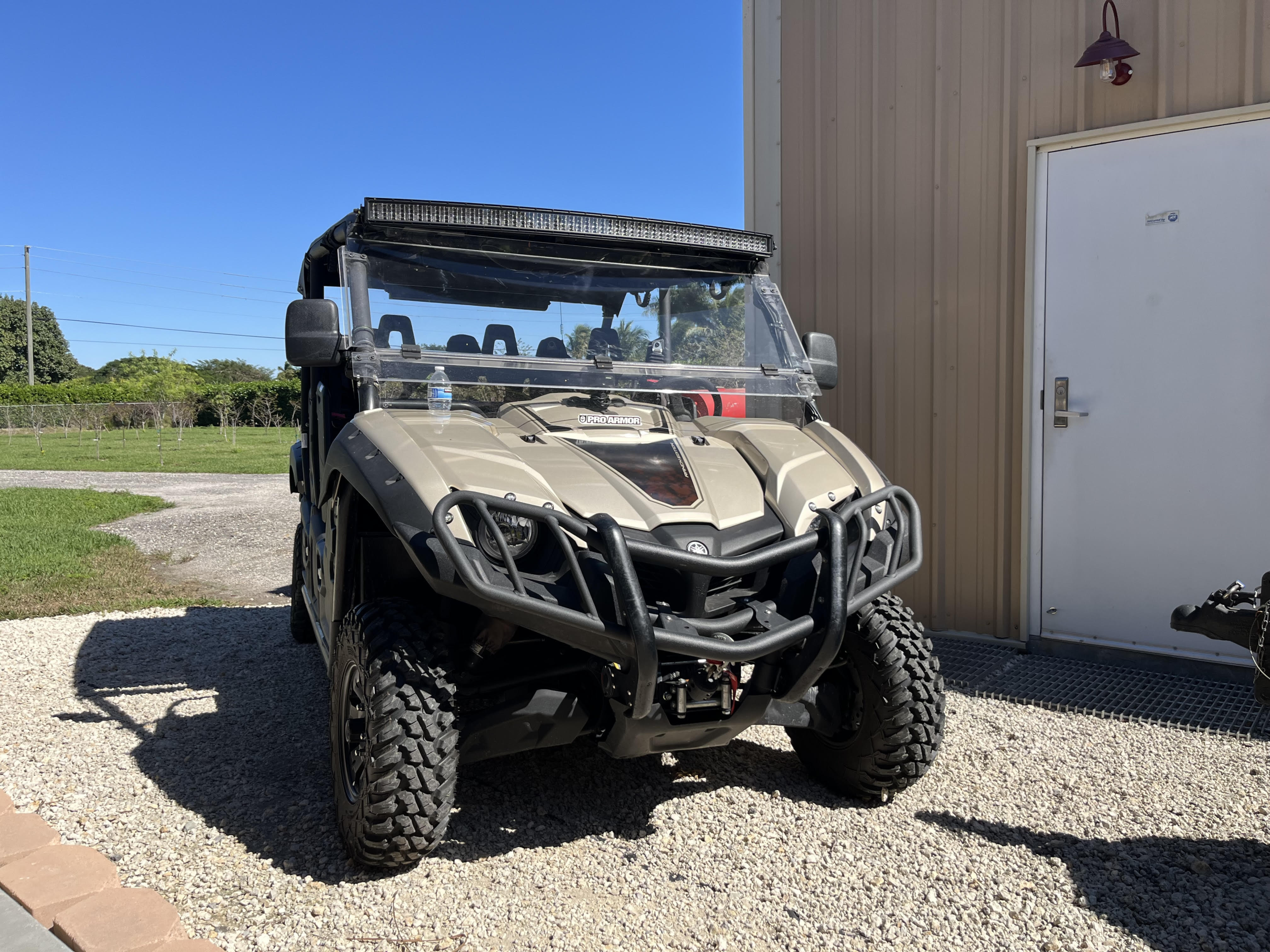

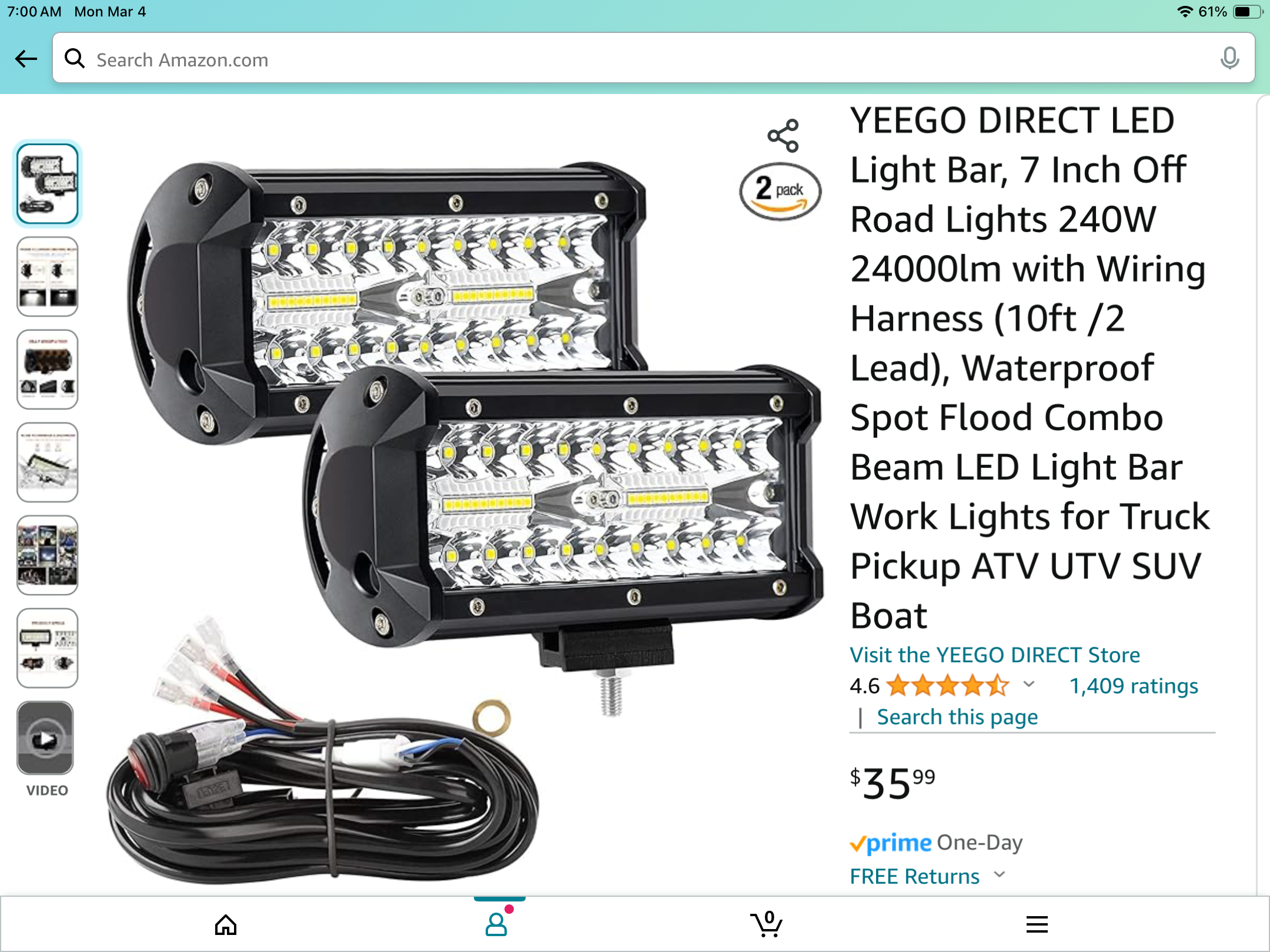

Did someone say light bars.... An old guy like me really needs them to see at night, they are very cheap on Ebay and easy to install.
