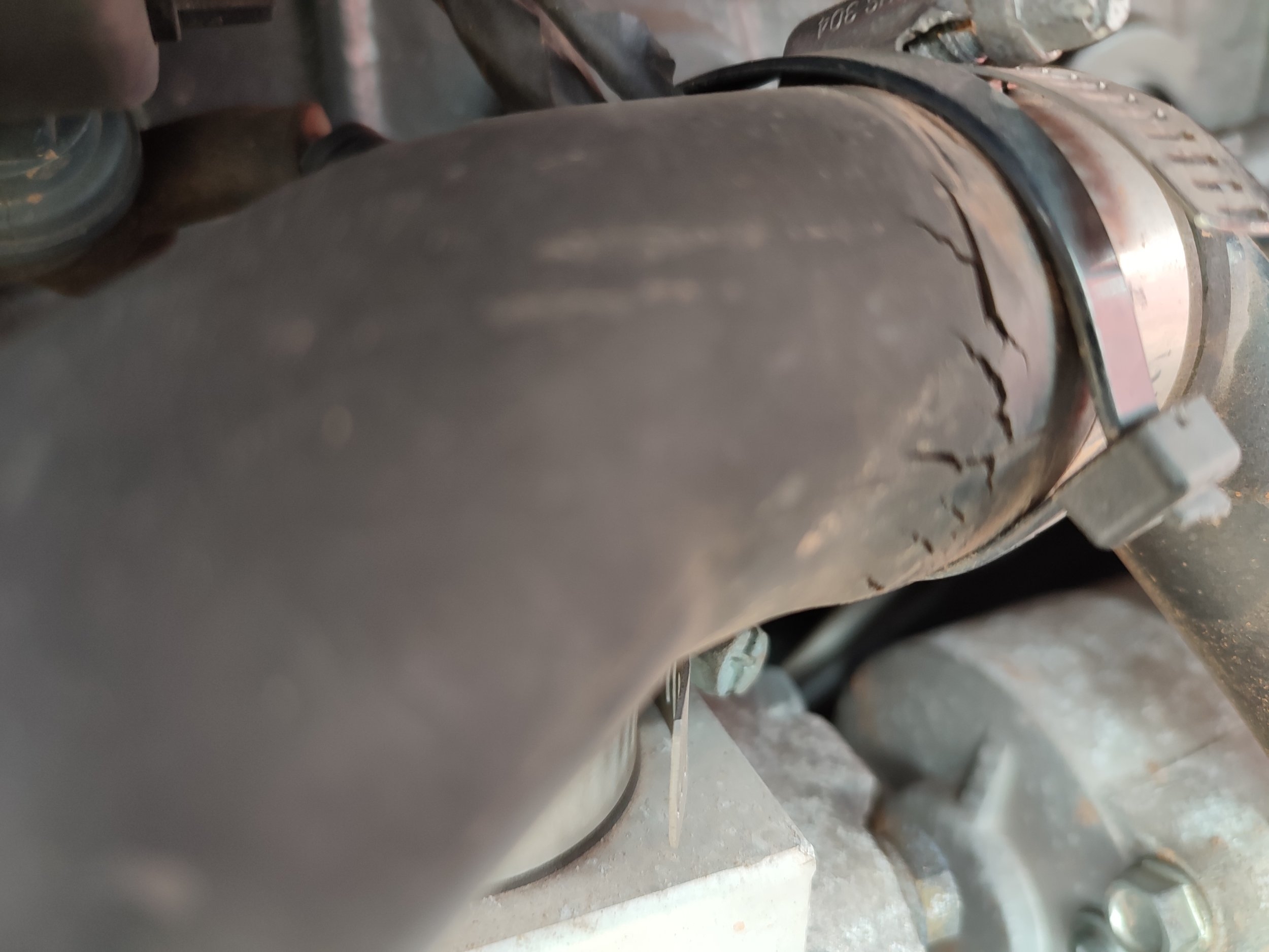

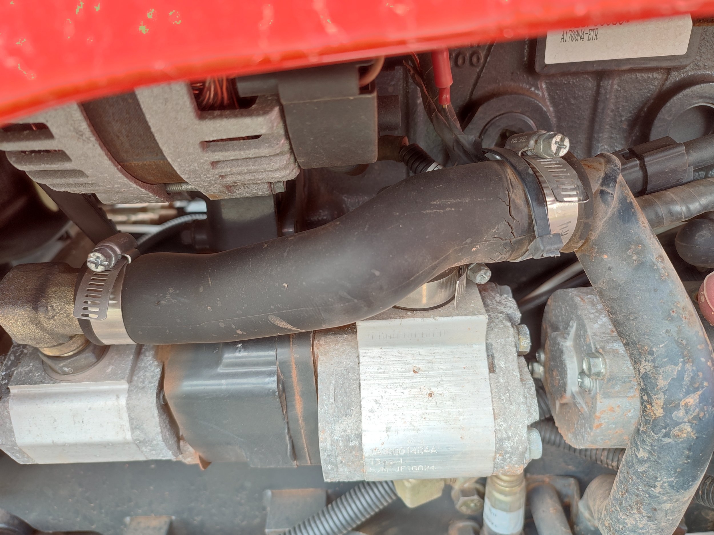

Friendly reminder for today: Check the condition of the hydraulic pumps suction hose friends.
I don't think mine cracked all the way through yet but it will happen eventually. Probably won't show as leak either since it's under suction.

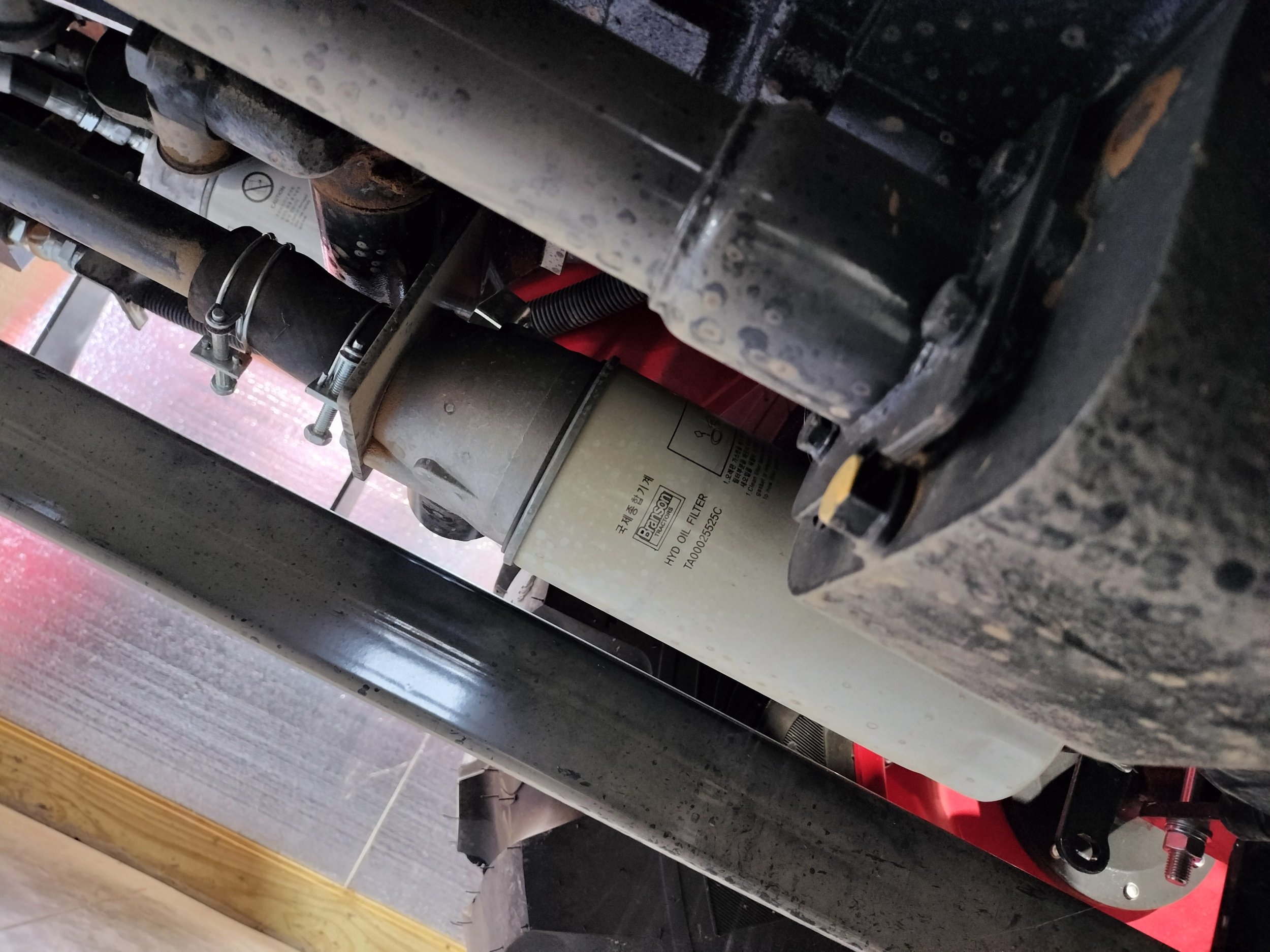

Your unit may also have a return hose down low near the rear transaxle and filter.
The other end of the suction pipe has a short straight piece of rubber hose. For the lack of better pictures at the moment, here is an older one from when I was building the loader. Note the hose in front of the hydraulic filter.
I believe the reason mine is going bad on the pipe side is because some time ago I tweaked the pipe, put a decent kink on it too. I pulled it out to get it straight again but couldn't quite remove a twitch on the 90 degree bent up top. So it kinda forces the rubber hose a little bit out of place.

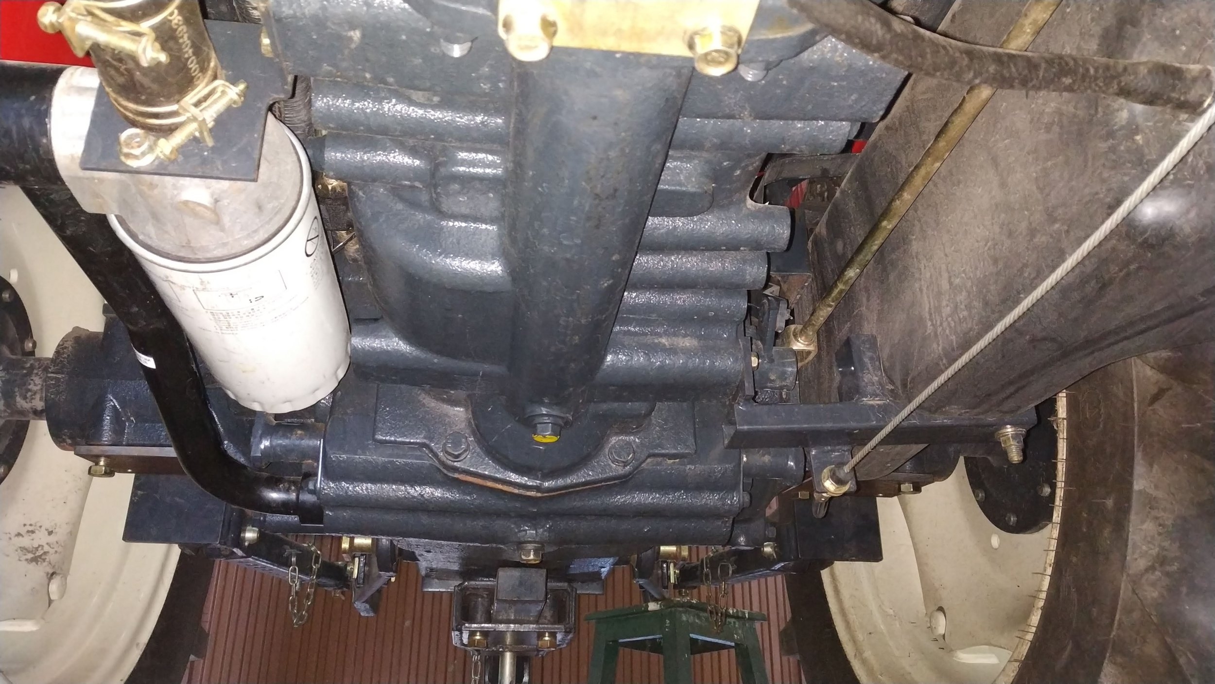

It's nice to see Branson didnt paint over all the filters like other brands

My filter/return design is different. My filter is located near the LR wheel and there is a short 90 hose to the axle housing, and a short straight to the return pipe. My 90 is more vulnerable to damage than your system if I ride over a small sapling and immediately back up.
The straight hose to the plastic tank on the right has the same vulnerabilities.
