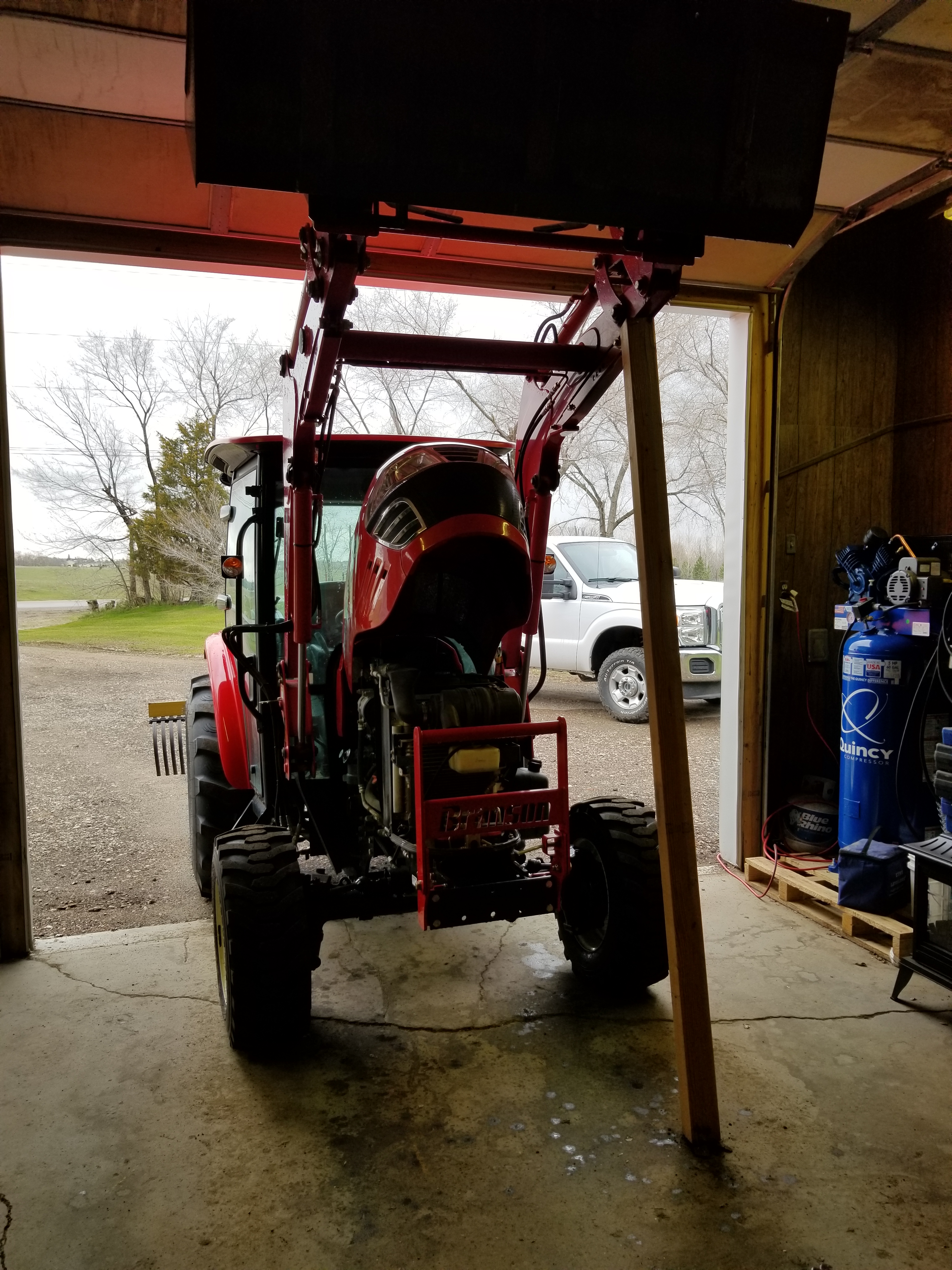

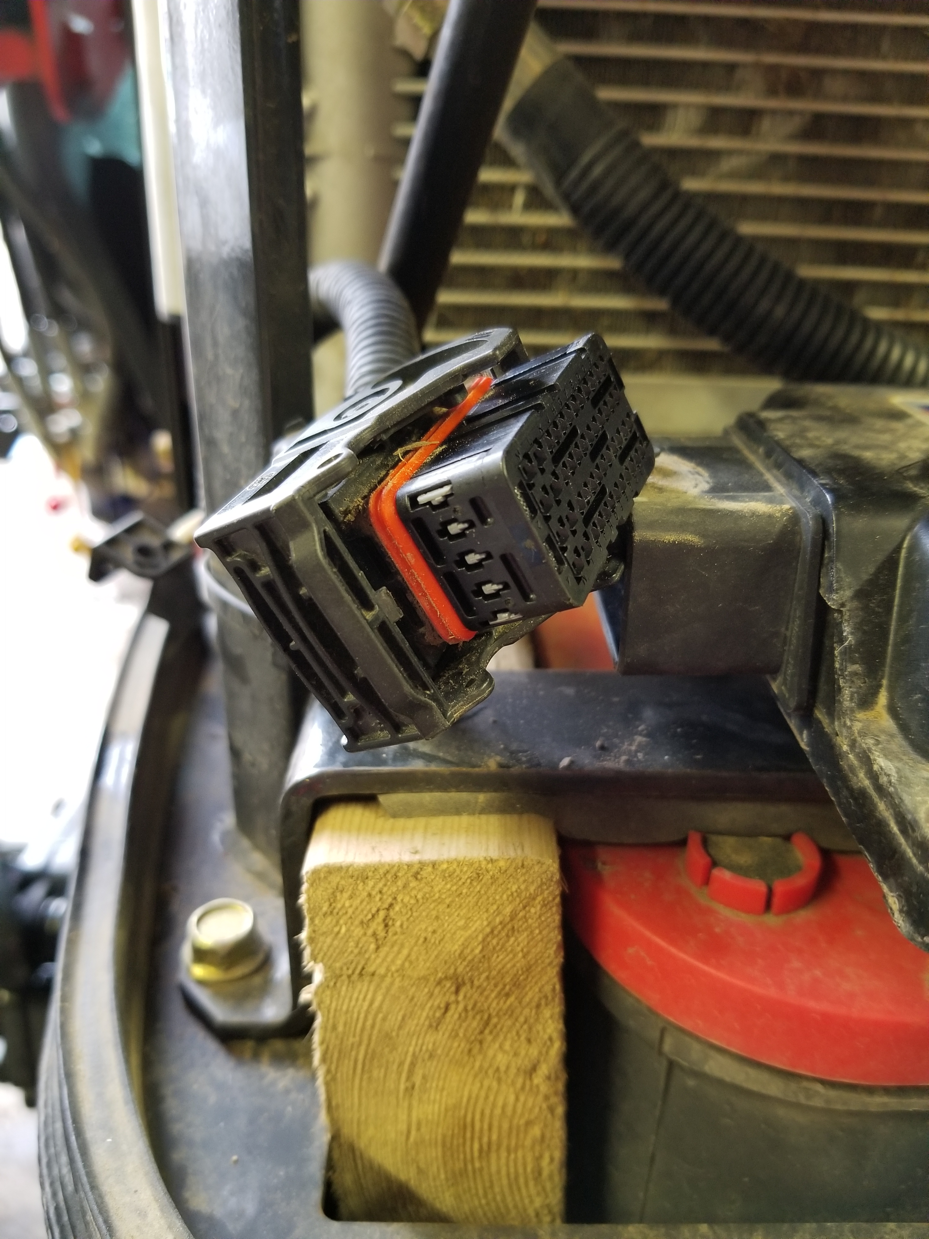

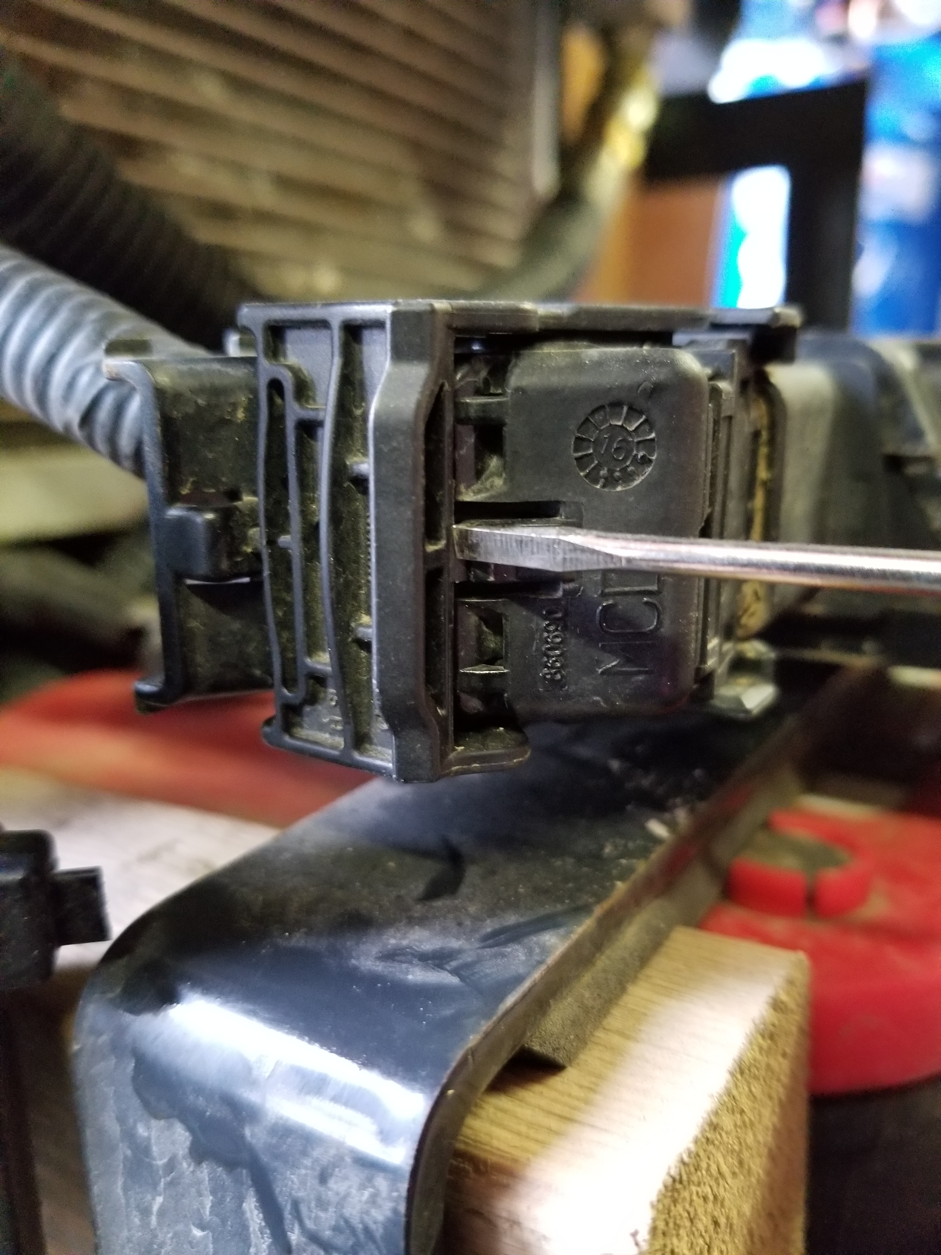

Weather was decent enough today to get a little work done on the Branson. I took the data logger off, after figuring out the retaining clip on the connector. Sadly, the mounting plate is welded to the battery hold down bracket. I was hoping to take that off as well. But, the data logger and it's mounting screws are sitting in a bag, on a shelf, right next to my dpf filter. I spent some time trying to figure out how to get the logger's wiring harness off. Unfortunately, it is actually woven into the main engine harness, and I just didn't feel like cutting the whole harness apart to remove the logger and sensor lines. So I wrapped the connector plug in plastic and taped it up. Hopefully it will stay clean in the plug.
Getting set up to work, FEL up and blocked...
This is the connector plug for the data logger...

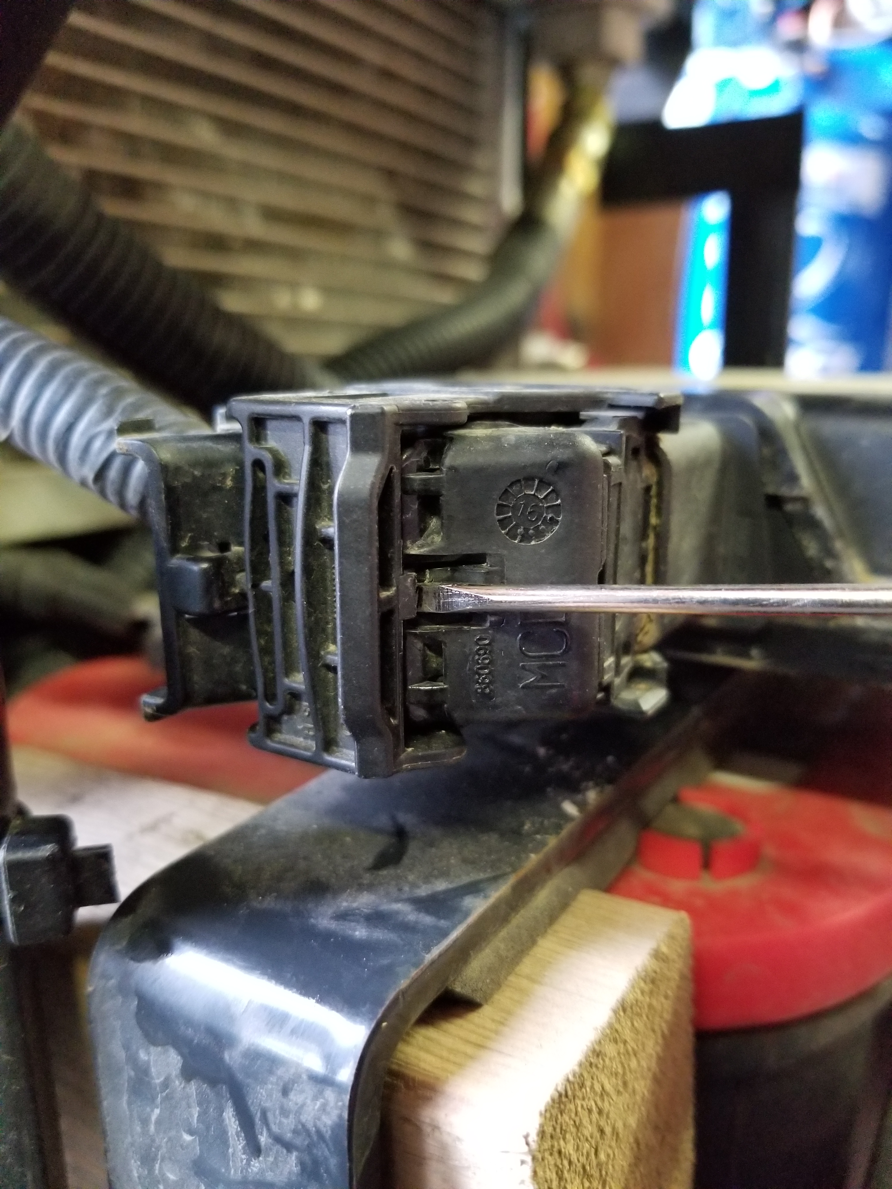

This is the retaining clip. I have the screwdriver underneath it, and just have to press in and (carefully) pull away...

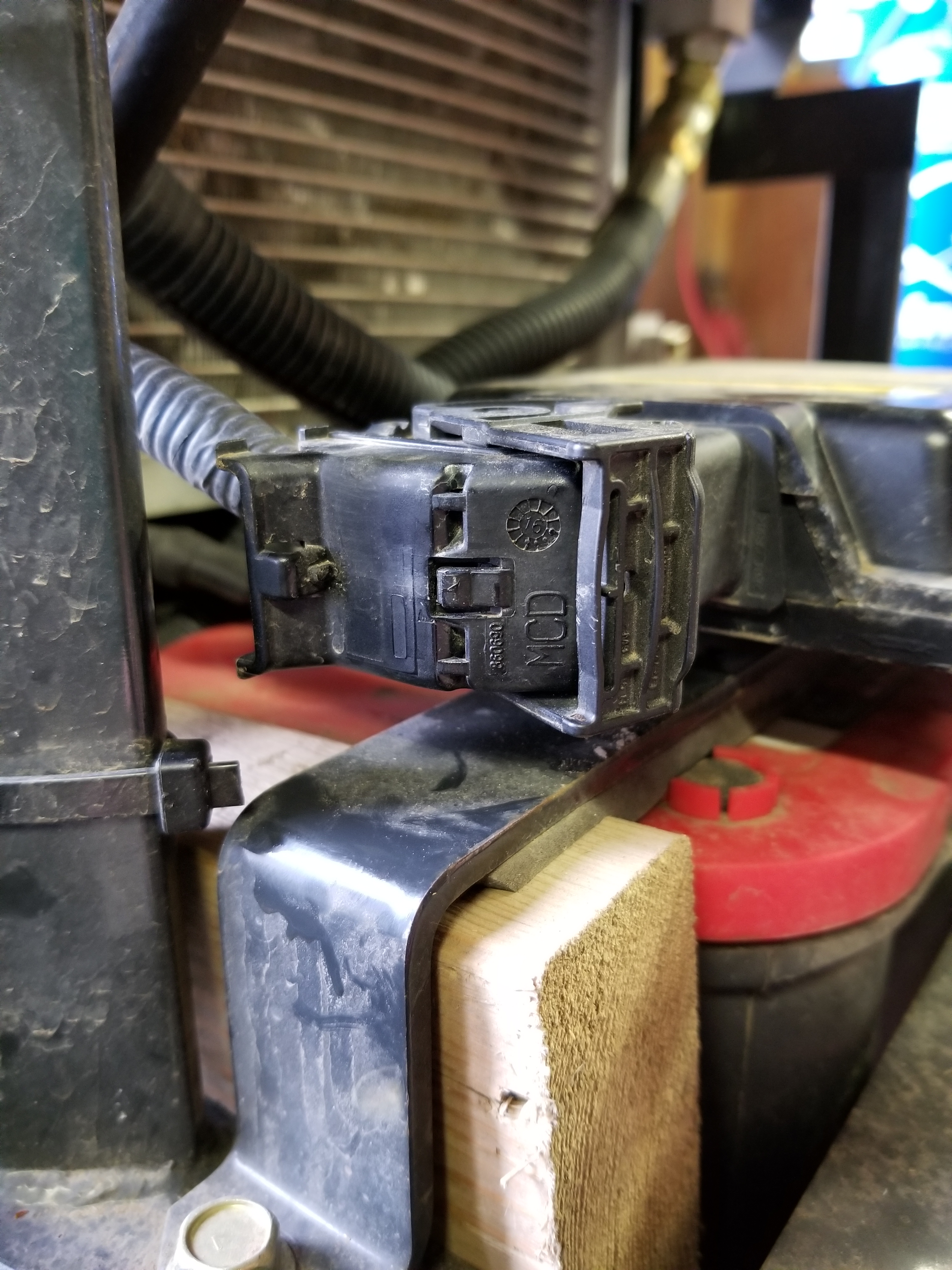

Once the clip is released, then the hasp (?) is just rotated towards the front of the tractor...
Now the connector can be pulled away from the data logger.

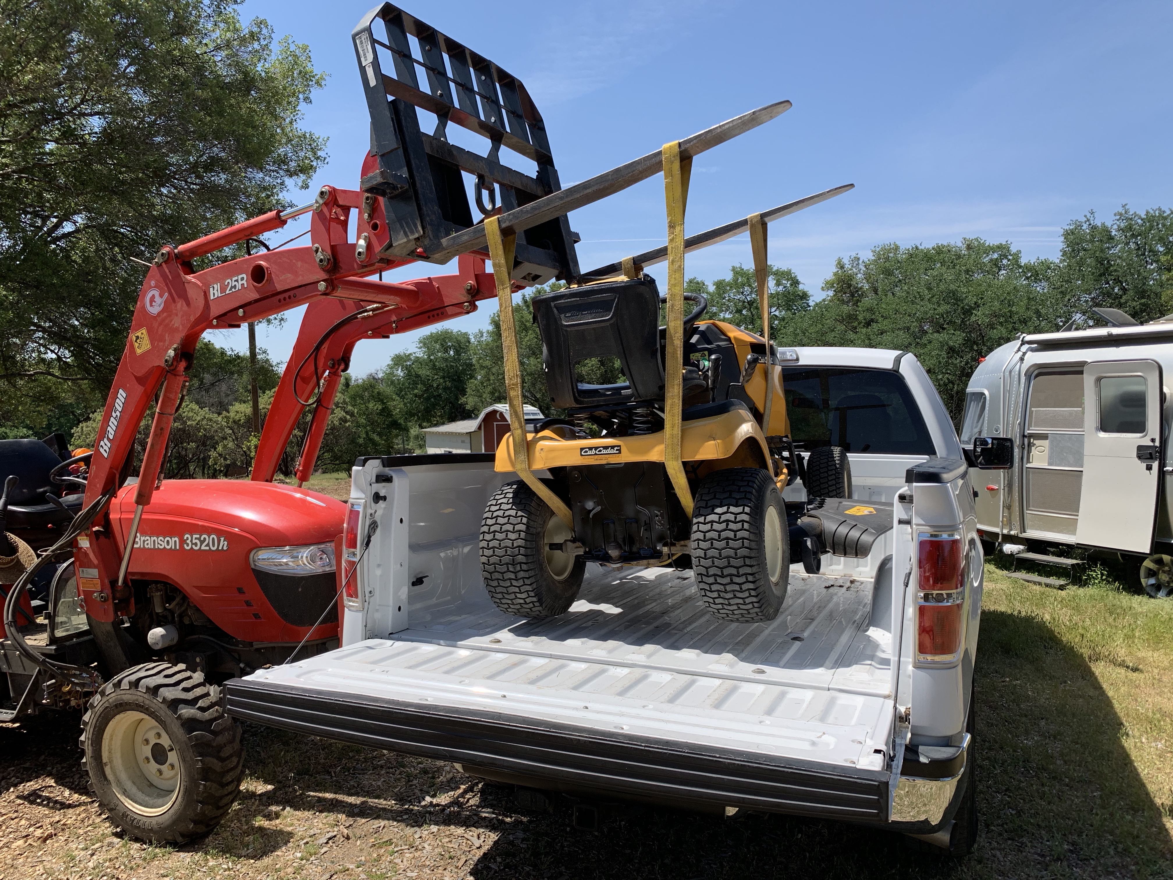

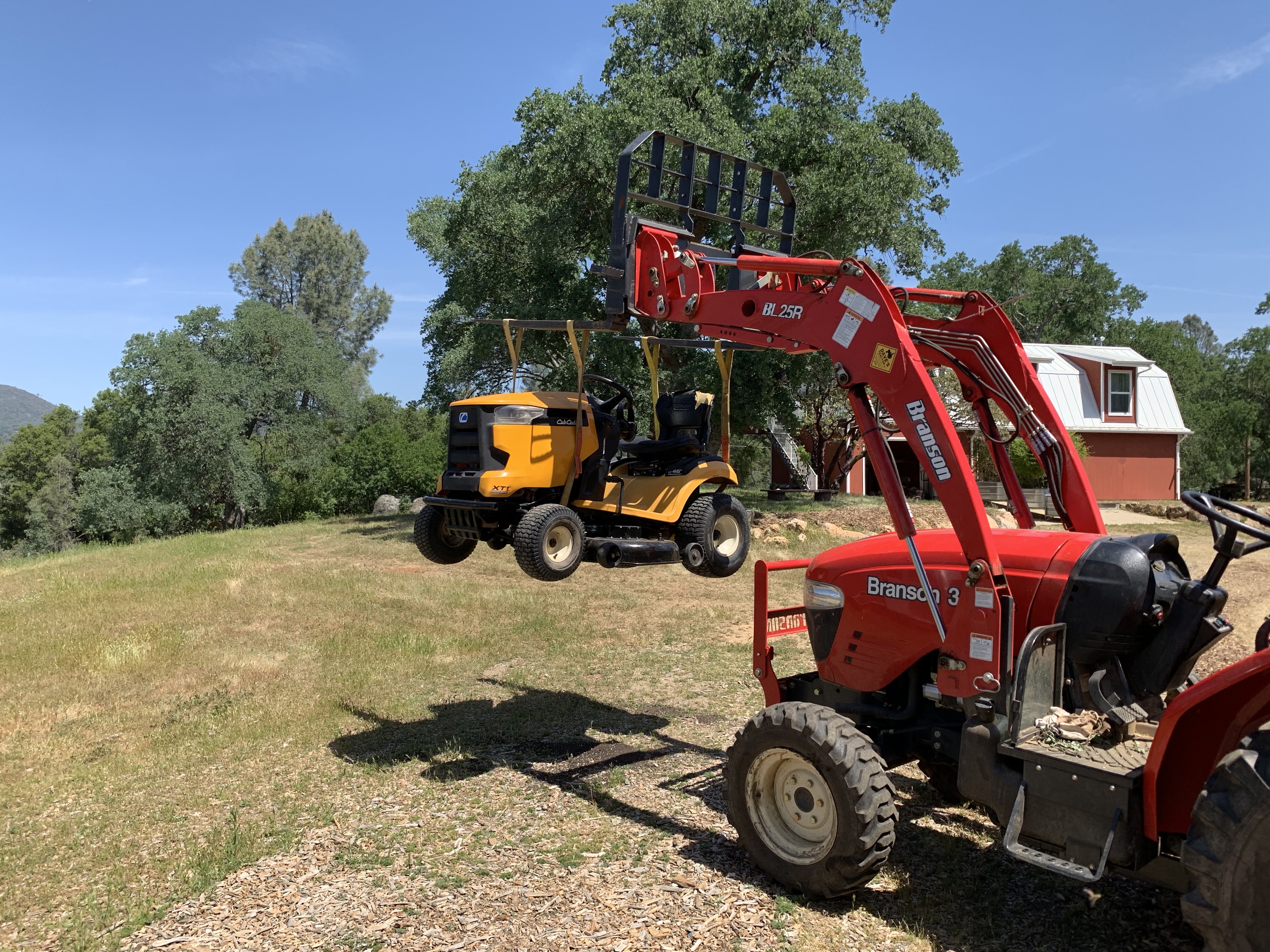

I broke down and bought a riding mower for the meadow (I refuse to call something I can lift off the ground a lawn "tractor"). It was needed but I hated to spend the money due to the fact that we only use it maybe 4 times in the spring before everything turns brown and stops growing. At any rate it's a 2-year old (100 hours) Cub Cadet XT1 and I got a killer deal... just $850... about half or less of a brand new one. One benefit beyond just mowing is that I have a small dump trailer that the Cub pulls for those jobs where the FEL is overkill and a wheelbarrow is not enough.

Nothing wrong with that Bob. I use my little dump cart behind my riding mower all season long. Very handy tool to have around.

Here are the pics, Slim. I won't show you the cart... the rust might be contagious.

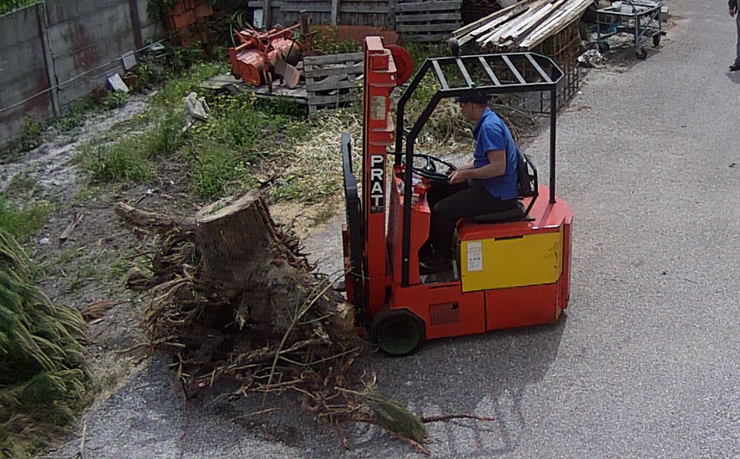

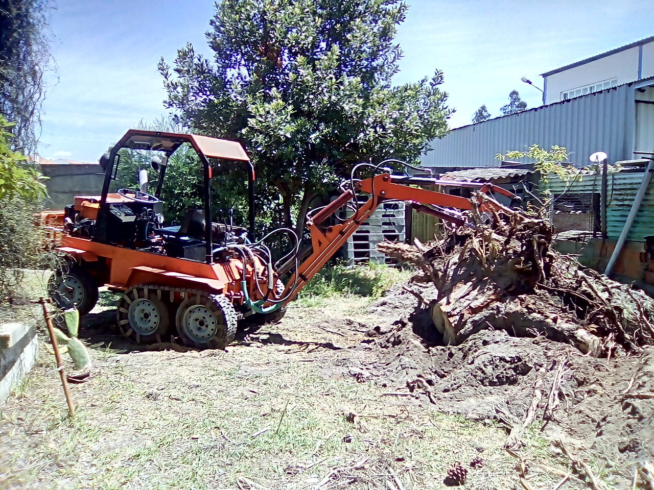

Had an interesting project this weekend that ended up taking all of my machinery.
First had to use my homemade backhoe to dig a 25+ years old pine tree stump that had the roots pinching the water supply line for the orchard irrigation system. Ended up breaking the swing cylinder mount, not once but twice. At least now I added enough steel to prevent this from happening again. But got the stump out anyway. It's massive, most likely to be over 1800 lbs.
Then I had to use the tractor with a 5/8" steel rope to pull the stump out of the garden, up to the driveway, so I could finally use the electric forklift to move it to the resting place where I'll cut it with the chainsaw eventually. No pictures of the tractor pulling the stump though.
