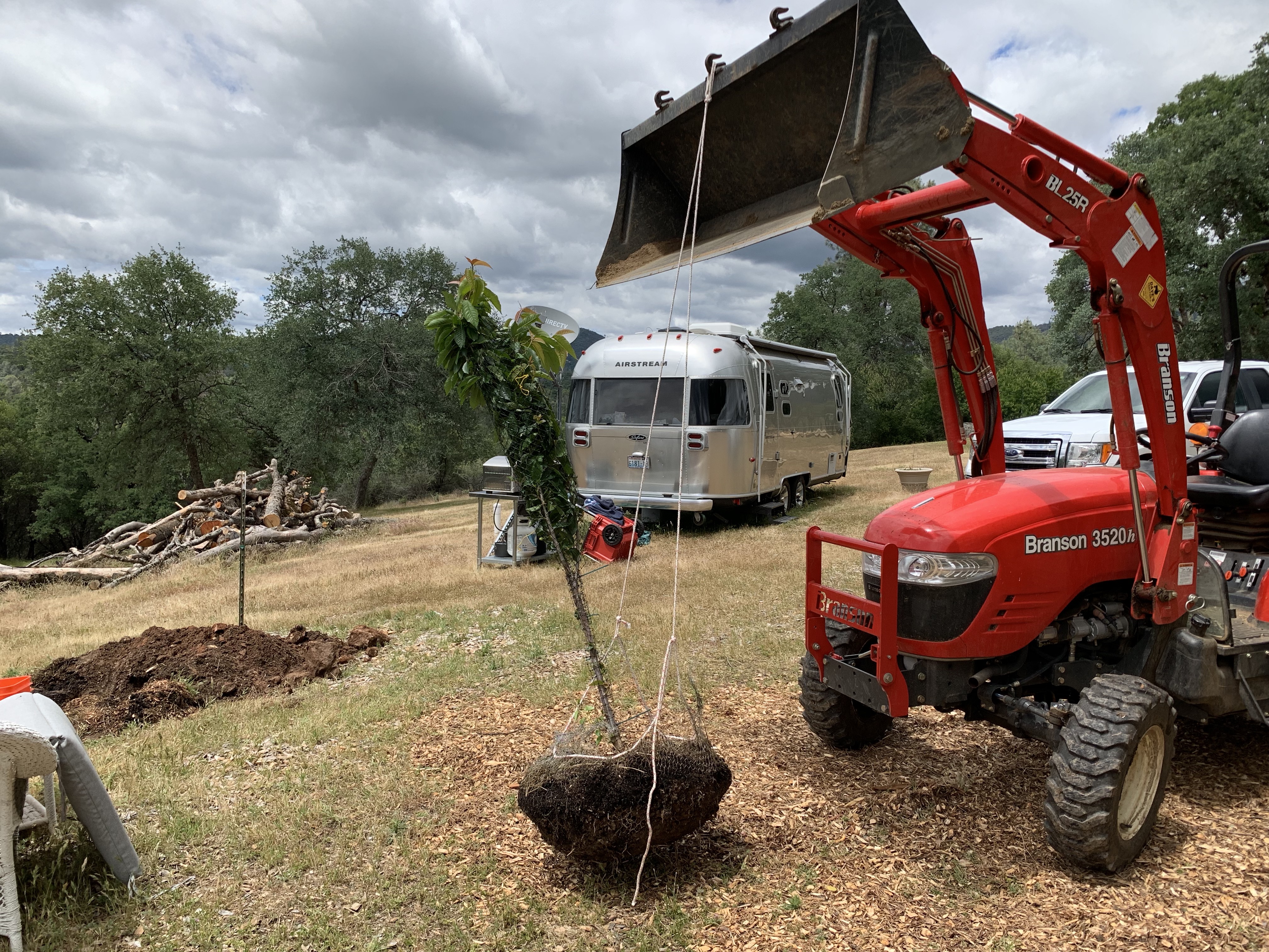

Re-planted one of my cherry trees. I wanted it to be at a closer elevation to the others so I can build a trellis and prune them in espalier-style.
The gopher wire is helpful when re-planting trees though I wish I'd done it right the first time.
