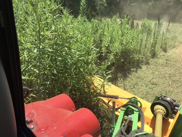

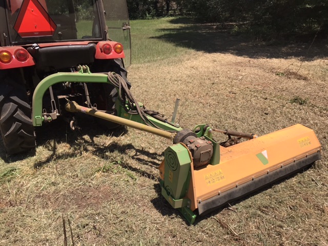

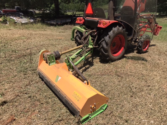

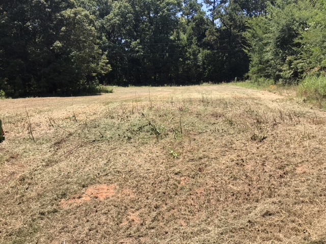

Finally got the new flail mower put together and tried it out today. Overall pretty happy with it痴 performance. My first time running a flail as Dad always thought they would not handle the work we always did on the farm. I think he would have been surprised. :laughing:
The pictures below show how tall the area I tested in was. The result was after only 1 pass.
BTW, my float system worked well with this mower. :thumbsup:

Looks like it did a fine job.

Nice attachment and it looks like it did a good job. Did you have an option between the Hammer or the Y-shaped flails and which did you get?
Thanks.
   / What have you done to your Branson today? #619
Thanks guys I look forward to spending more time with it tomorrow.
Bob, I did not ask if I could get knifes. It has hammers which is what I wanted. I debated back and forth with myself on this or a 6' BushHog brand shredder. This won because I have never owned a flail before and the versatility of offset and tilt. Should make mowing the bar ditch much easier.
One thing that I noticed is grass wrapped around the roller end and I could see it cutting the bearing seals. I am thinking of a way to add a scraper of sorts to keep the grass cut out.

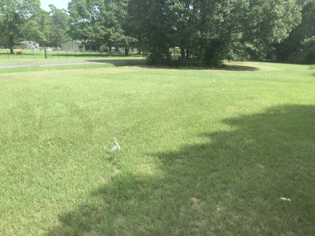

Apparently egrets are curious birds. They left the cows to follow the Branson and the flail mower. They only made a couple of laps then decided that big red cow won't stop moving. :laughing:
