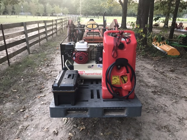

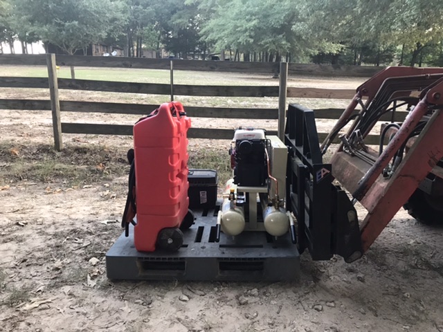

Thanks for sharing. I am in the process of setting up a service pallet that I can use remotely when needed. I still have some thinking to do before I start cutting steel. I am going to use a plastic pallet for the platform but I might need a little bigger one to fit everything nicely. I still need a container for grease gun and oils but pretty much have everything else.
I am going to frame behind the compressor with 2" box tubing and mount a retractable hose reel to that. Probably will use 1" for the rest of what I am framing but going trying to keep it light as possible. Here is a picture of what I am thinking so any ideas would be appreciated.
Nice setup K5. One thing that might be handy is an inverter for those times that you might not want to fire up the generator/compressor for AC power. The nice thing about the inverters are that they take up very little space, can run off the tractor's electrical system and would be located really close to the battery compartment. A good quality true sine wave inverter with cables that can push 12-14 amps is around $200.

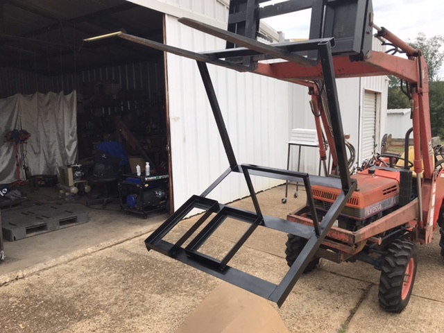

Thanks Bob, I have been working on the project some. Heat and MS do not get along! I get to shop around 4am and can go to about 7 or so before my body crashes. Weekends only.
I have everything welded and painted so next weekend will be final assembly. I look forward to cooler weather so maybe I can get some other projects done.

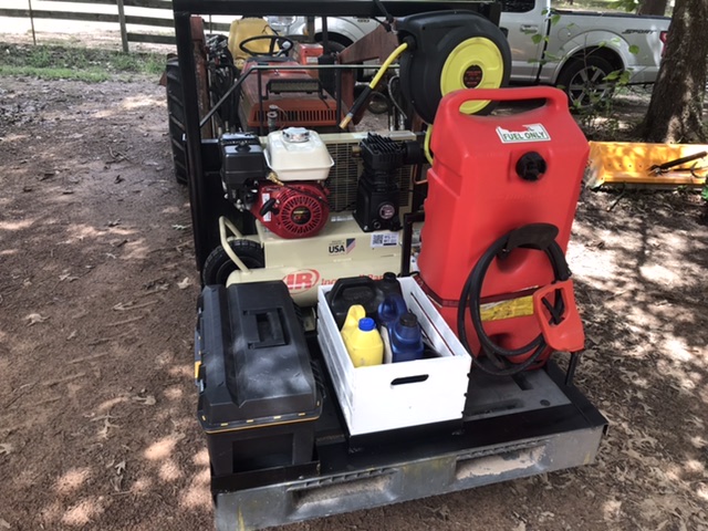

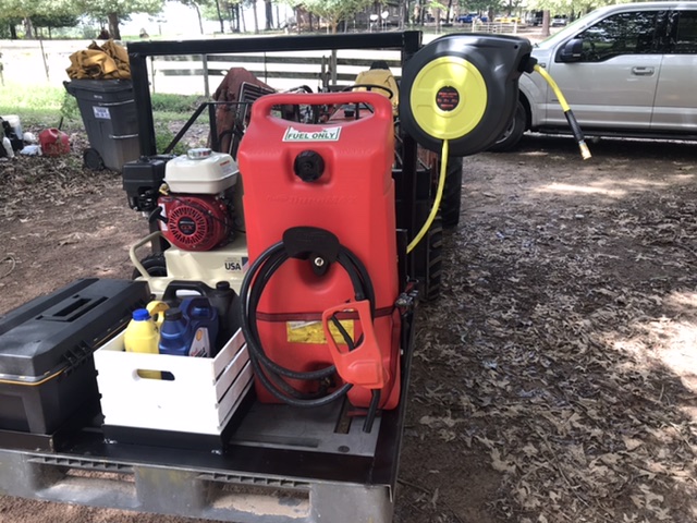

Well got the service pallet complete. Overall I am happy with the way it came out.

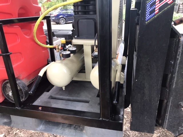

I had to offset one post to clear the handle on the compressor.

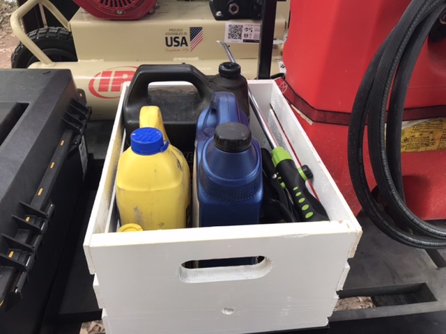

The little wood box I found holds fluids, grease gun and the radiator genie.

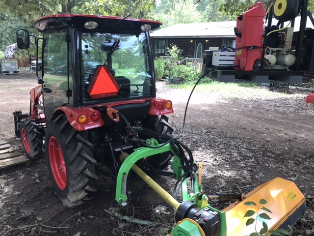

Here it is filling the Branson.
Thanks everyone for you suggestions. Just ran out of room to get everything on there. But this will cover routine maintenance.
   / What have you done to your Branson today? #648
Looks great K5. I like the swiveling hose reel and the layout looks well thought-out. The pull cord, tool box, fuel tank all face the right direction. I'd like to see a peak inside the toolbox. Also is that a tiller or a flail mower and is that a swing arm?
   / What have you done to your Branson today? #649
That came out real nice there K5.
Looks like that is an offset flail mower?
   / What have you done to your Branson today? #650
Thanks Guys,
Yes that is a ditch bank flail mower. I really like it even though it is a cheaper Chinese mower.
I will get a picture of what is inside the box when I finish gathering everything together. It just has an air chuck, blower and impact in it now.
