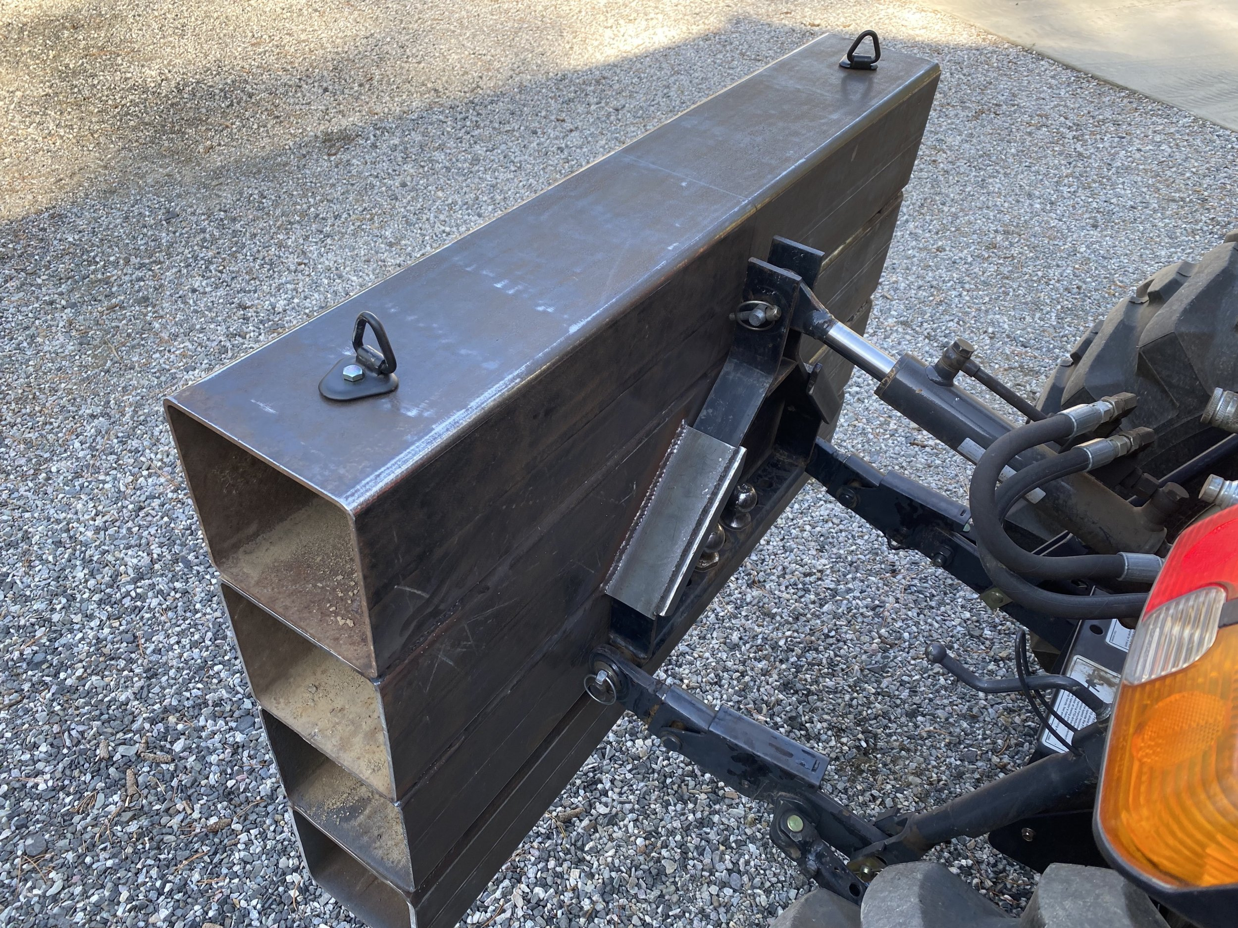

Building a counterweight, still in progress…

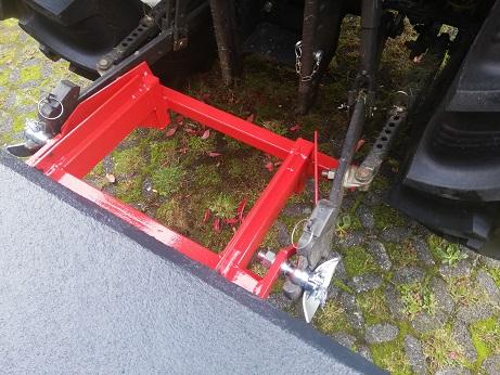

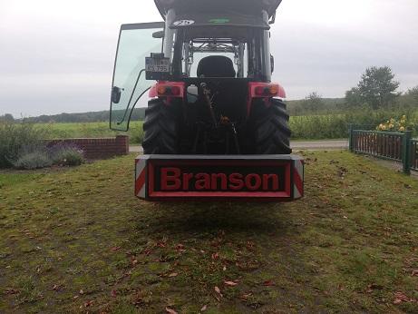

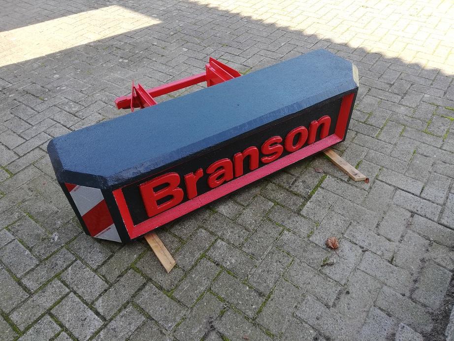

Speaking of counter weights, just saw this counterweight that Ralf over at the German Branson forum made. Really cool, easy to attach/detach using the lower link Euro hooks, plus the name is a nice touch. Weights around 1200 lbs.
That looks really good. Interesting he chose to make it a two point hitch. I am thinking that is a lot of stress on the lift arms. Do you see this design often on you side of the pond?
   / What have you done to your Branson today? #919
Honestly, it was the first time I've see this style. I think it's more popular towards the German area. It's still not as popular as the 3 pt ones but still some what popular. Quicke, a loader manufacturer, also offers the same style of counterweight.
I have seen 2 point counterweights but usually for the front 3 pt hitches and the pins are centered with the weight, the weight just kind of rocks back and forth on the arms.
I too have mix feelings about the arms, but is it really that much difference in stress to the arms versus a 3 pt mounted one, considering where the side links pull on the arm?

Yes, filling it with concrete. I’m looking to fabricate an auto latching system with a lever I can reach from the seat. Still mulling it over. I thought about a quick attach for the rear but it pushes out the weight further and It requires me getting off the tractor. Gonna add gussets to strengthen the “coupler”.
Also will likely add short “skids” to prevent it from tipping over. I’m open to further ideas, suggestions. Primary use is for logging with grapple & may add some tool holders & small platform to service my chainsaw and carry a second 24” chainsaw. (Smaller one mounts on the tractor)
