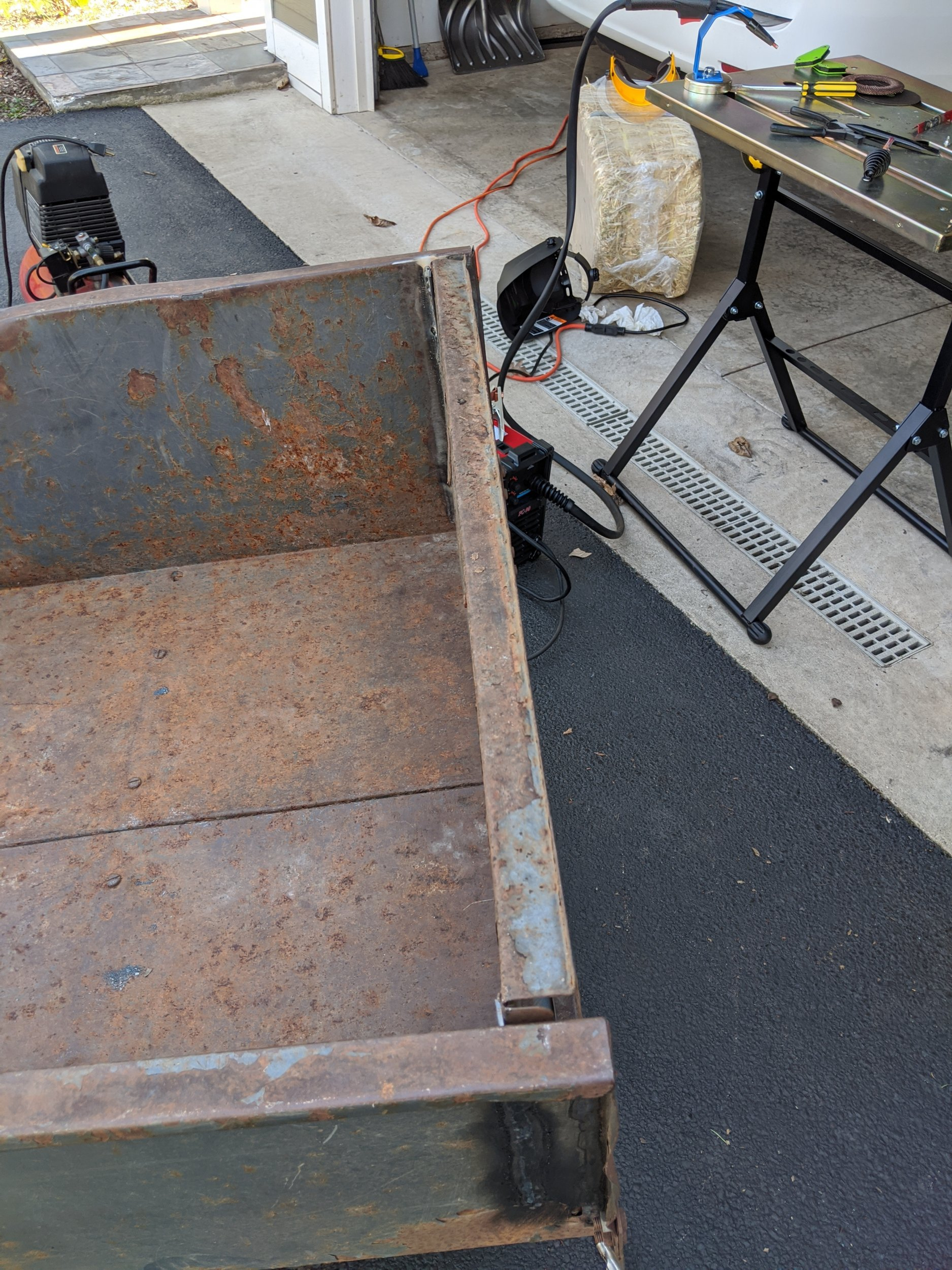

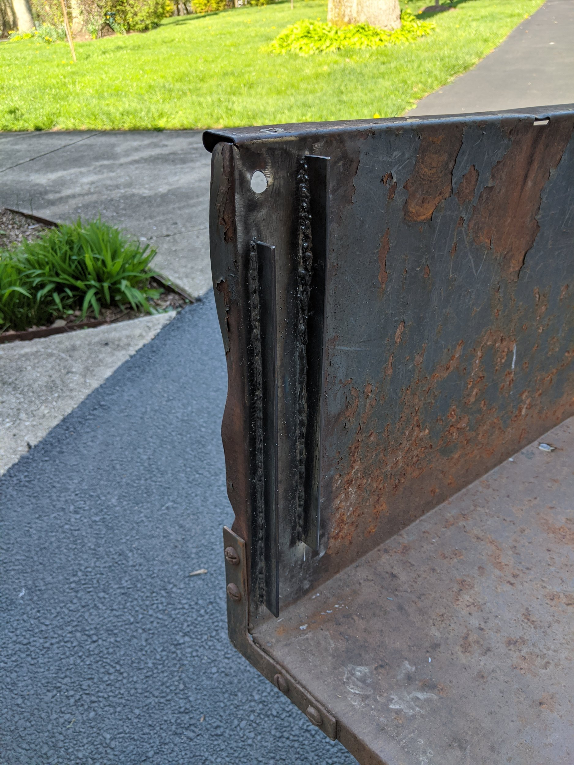

Yo D, I hated the pivoting back door on that cart, so I changed it...welded on some channel so that the door just slides off completely:

don't have pivot door on this, its slide up and out door. much like you made.
was the largest cart sold in this style back in 2006 or so, its pretty big. smaller carts used the swing door.

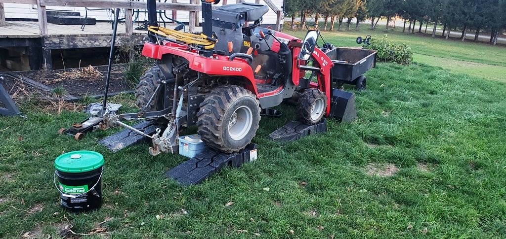

hydro done on my GC2400. accidentally put about 1/2 qt too much in it. should be ok, runs fine.

Mine's been slightly overfull by about the same mount for almost 2 years with no ill effects. Was at the bottom of the glass and added, does not take much to go from there to overfull. I can see the level when extend all the FEL cylinders.

yup, plus after I remove bucket a few times level will drop a touch.

The full level for the hydraulic fluid on a GC, is not critical.

if you overfill too much you can create a foaming issue. that ain't good.
1/2 qt....yeah not an issue
last time I serviced MY unit (no garage, level surface hard to find so I actually use levels 2ft and 4ft on tractor normally) I never noticed fill glass had been covered and I ended up adding extra gallon.
disconnect one loader line, connect hose from coupling to bucket. pull loader lever. it comes out pretty fast LOL
