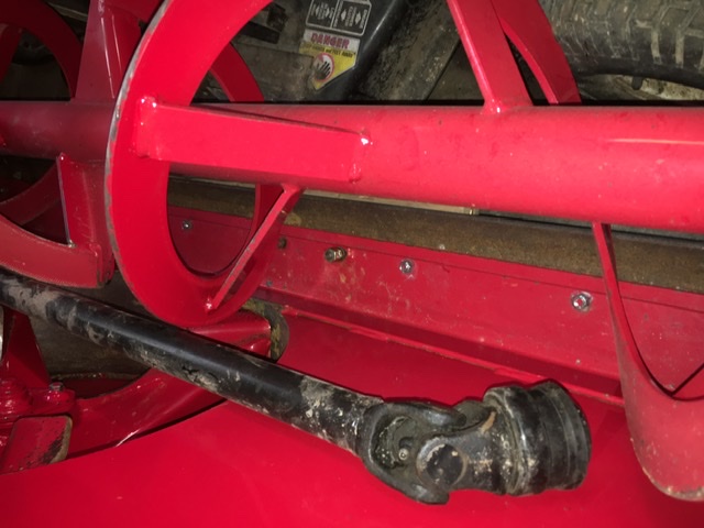

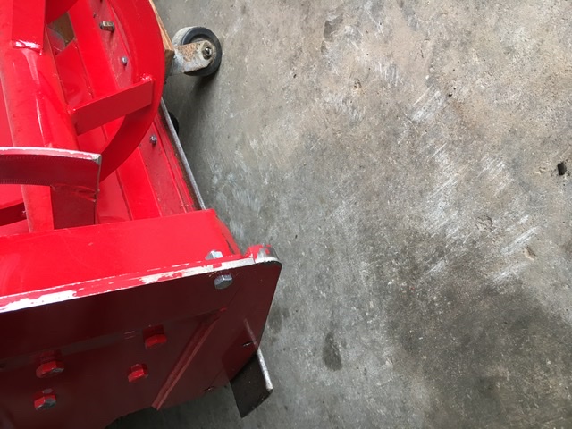

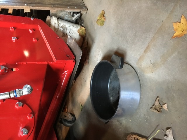

I solved that problem by attaching this full width ski on my front mount blower. It is a piece of flat stock, 6 inches by 86 inches, with the front 1 1/2 inches bent up at 30 degrees. Total cost is less than $50.
I thought I would need to remove it after I built up a layer of frozen snow, but it turns out that the blower is heavy enough to sink thru. Its on its third year, never removed it. It wont cut thru a pile of wet snow after it slides off my metal roof, tho. Had to remove the blower and use the FEL for that job.
I don’t know why my pics display sideways. They used to display correctly at one time.
EDEA1E19-2261-4618-B379-3EE907D0345F.jpeg6EAF4816-3820-4090-9108-79DDA21355C0.jpegE2A8D01F-5CE7-4539-A375-D057C6D61BFC.jpeg

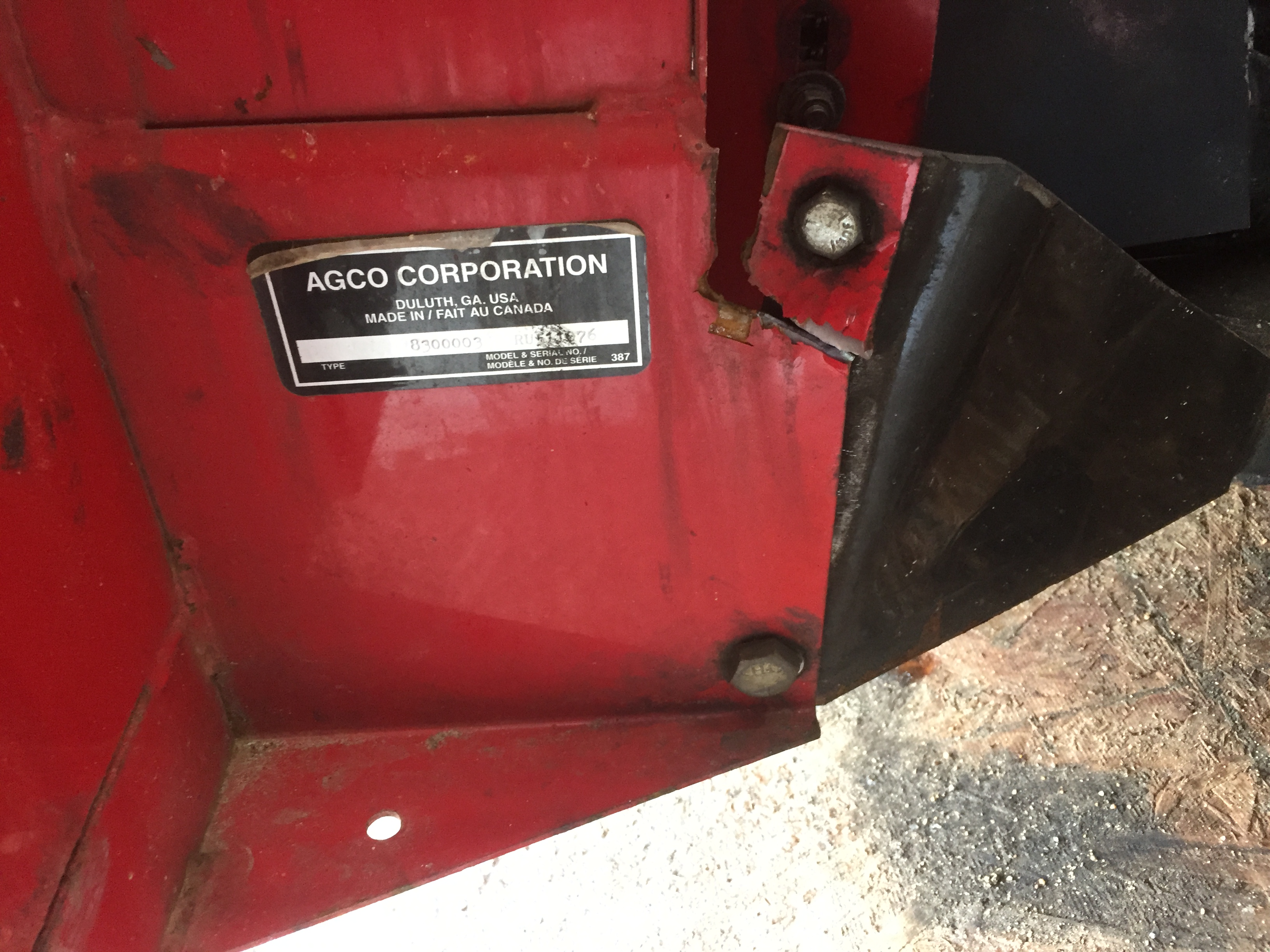

Those oem shoes are the worst. They wear out quickly and bend easily. If the backing of blower gets bowed out even a little (which it will) then the shoes are impossible to keep in place ie: they will slide down regardless of how tightly torqued. I started using 4" anti skid skateboard type grip tape on both the the backside of shoes and blower and over time that even proved ineffective. After years of jigging around with fixes and now on my second blower I've found the following fix: My second 2360 blower had holes drilled on the outside wing spanned for shoes that matched the reversible shoes used for the 63” Massey1410 which is the same as b2782b I purchased a set of these shoes then set the inside oem shyte shoes to a minimum setting of about 1/4". I can now quickly adjust the outside shoes between gravel and pavement levels quickly as well. Since using this setup I've gone through zero fan or auger shear bolts.
The original oem shoes mechanical integrity was compromised a little to meet a residential design goal. The marks left by the inward type shoes are are covered up with the tire tracks and the side edges of the blower leave a pristine edge. This leaves a clean and precise looking finish which is valued on a small scale residential level. Shoes attached to the outside wings of the blower catch snow and builds up some therefore the outside profile in a little messier and the rear tires do not clean this up.
Reversing the oem shoes works well on concrete or pavement but then the front edge digs into gravel rather than, relatively, floating over it and those constant extra forces bow out the back sheet metal of the blower even more and further promotes the bowing issue stated above.
This has nothing to do with my response to Irvingj however lol. I believe he raised his shoes so that they no longer ride on the ground and the weight of the blower is now riding on the cutting edge. Like Irvingj I've done my fair amount of landscaping with both setups.
If interested the shoe part#'s are:
Massey 1410 part# 4316367M1
Kubota B2782b part # 77700-02283
