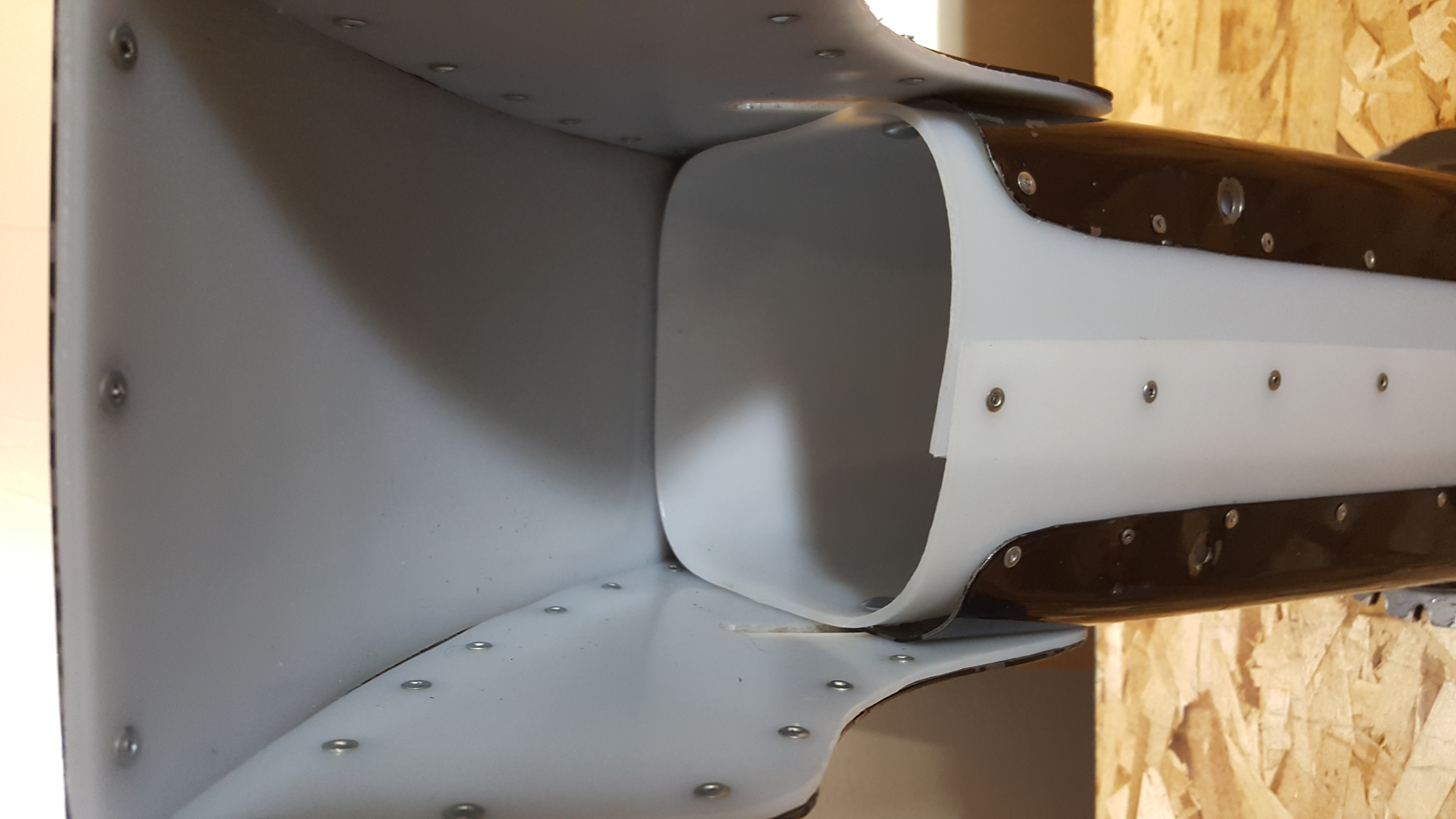

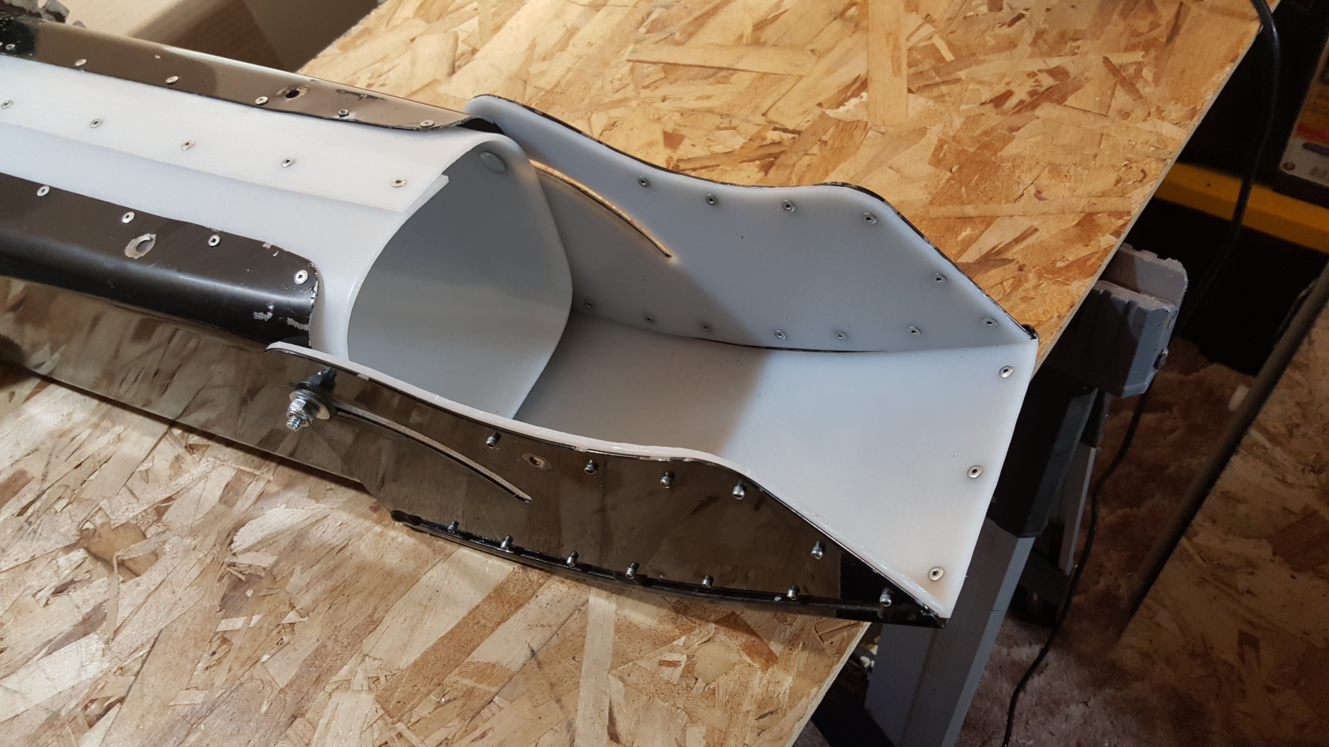

UHMWPE is tough but flexible... but for serious shaping, it needs to be heated. I used a small propane torch: just as the material BEGINS to get clear, it can easily be bent to shape... but then hold it in position for 15-20 minutes to allow it to cool. Once it's cool, it will return to its normal milky-white appearance. It really retains heat well and will definitely burn your fingers if touched too soon!

Is it due to time or is that plastic just hard to shape and attach ? Be nice not to get snow build up in the chute when done. 8-15 inches of snow expected for us between now and Saturday late afternoon plus high winds.
It's just me that any project takes 4 to 10 times longer to do.
UHMW, like irvingj said is easy to work with, I just cut it with tin snips (left and right handed aviation snips) and the radius slotted hole I drilled a hole at both ends and used a jigsaw then a file.
I heated my UHMW with an electric heat gun in one hand and a infrared thermometer gun in the other to check the temperature, once it's heated to about 160 to 180 degrees I then clamp it to the chute, let it cool and it stays to that shape.

I will eventually look into the UHMWPE later on, would work nice on the blade to keep snow build up off it, put like a 12 inch x 60 inch piece on the blade.
ePlastics seems to have a good price on this product.

I thought about lining the MF 2340 Dozer Blade, but I have not used it much in 11 years, it still has most of the MF paint job on it, which is pretty slick still, and I just spray it with 2 heavy flood coats of "Super SLICK SLICK Stuff" in the summer and let it sit for a few days in between coats.
I am still working on lining the snowblower, right now I am working on the 3 fan blades and the little discharge area just below the chute.
Here are a couple more pics of my slow progress:
