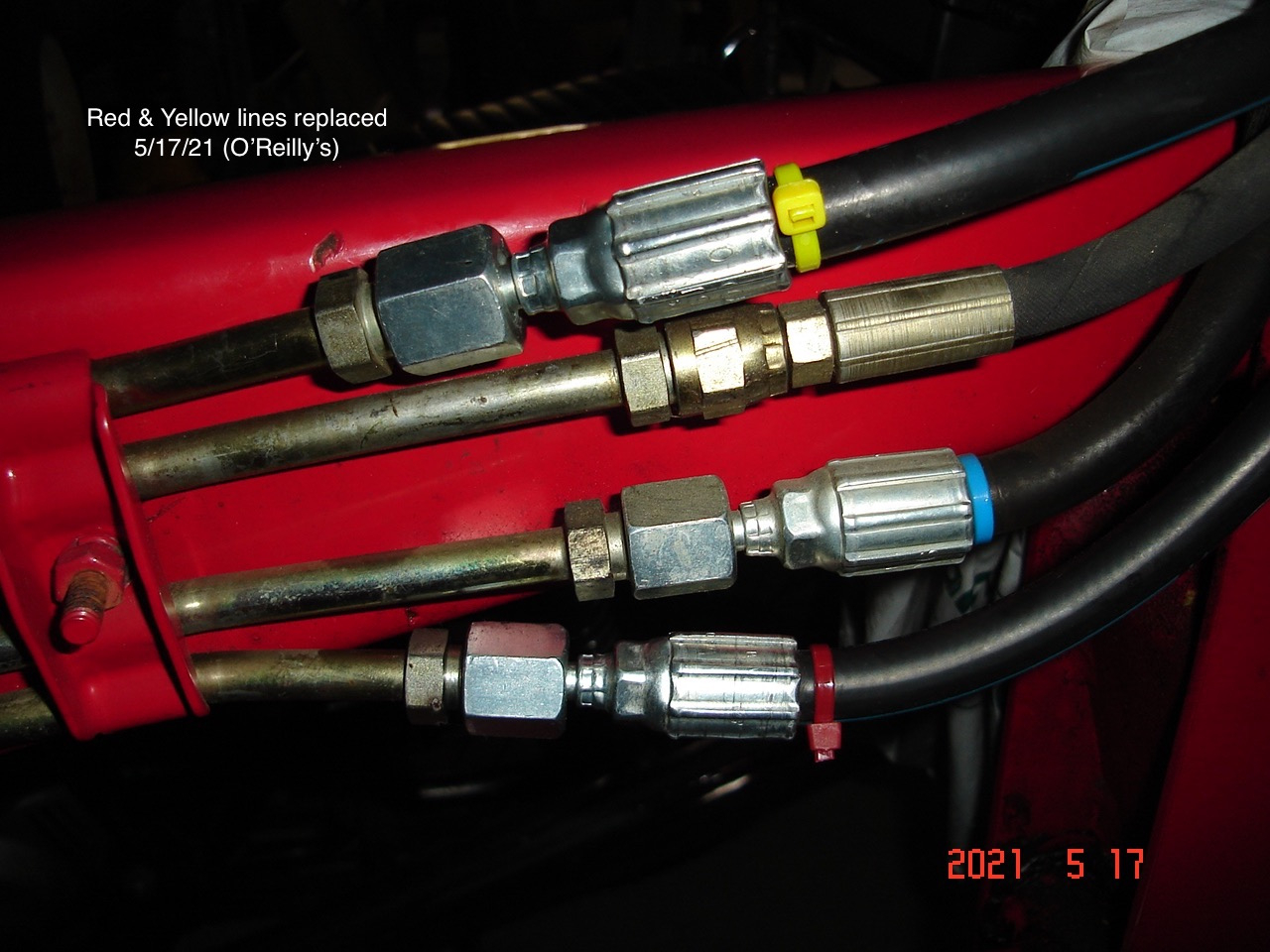

I was rather annoyed that I had to replace one of those same FEL hoses quite a few years ago, when the tractor wasn't that old. These latest two, OK, it was time. At least those hoses are easy enough to get to!
I replaced 2 yesterday, the red & yellow ones. All good now,; that leaves one OEM hose on, still looking fine. Since it's so easy to get to, I'll wait until it lets go.

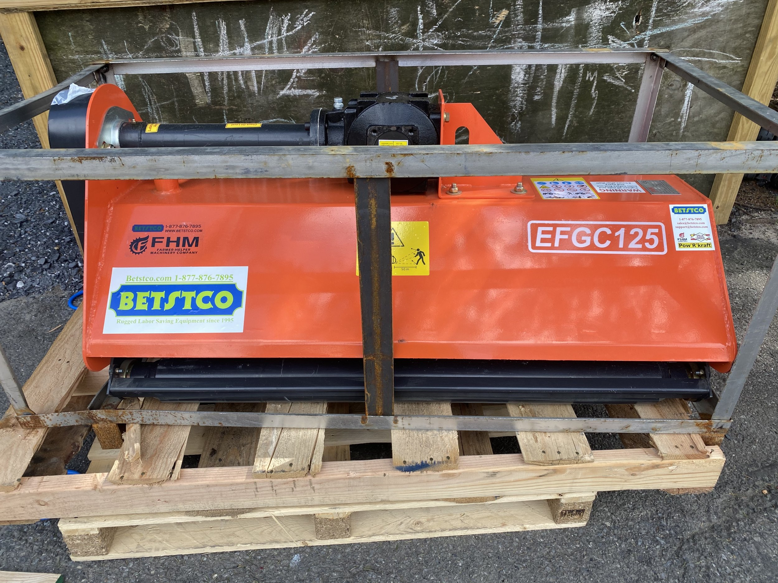

I took a chance on the Betstco FarmerHelper flail mower two years ago. So far, so good. The hammer blades they provided were lousy (inconsistent lengths / weights). Thankfully, Titan has replacements that fit and are all the same length / weight.

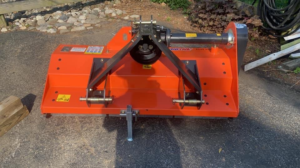

   / What have you done with/to your GC Series 2300, 2400, 1700 Tractor TODAY #935
All assembled and lined up. Assembly took about 45 minutes and packing was good.
@kenmbz
   / What have you done with/to your GC Series 2300, 2400, 1700 Tractor TODAY #936
Is that how you center the A arm I see it spread. Do the mounts toward the center also have holes to mount the A-Arm to shift it more over?
   / What have you done with/to your GC Series 2300, 2400, 1700 Tractor TODAY #937
Nope, lol, good catch. Moving it now
   / What have you done with/to your GC Series 2300, 2400, 1700 Tractor TODAY #938
Instructions show right to inside of mount and left in between mount. Mounts are symmetrical so reversed that. I wanted it centered on the machine, for my use.

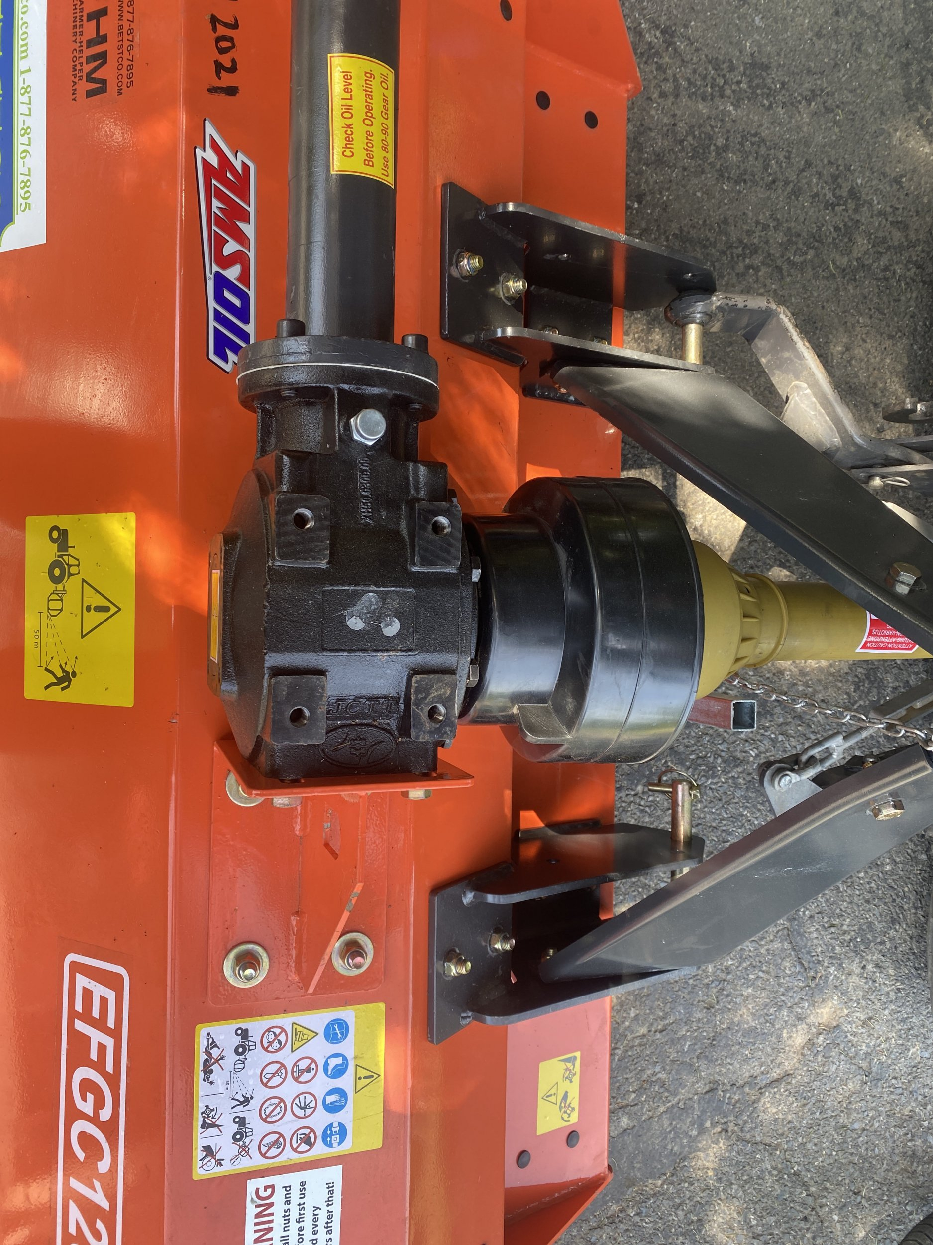

Didn’t have to cut the driveshaft, in cutting position is the shortest, with 4” or so of play.
   / What have you done with/to your GC Series 2300, 2400, 1700 Tractor TODAY #940
And a note, the actual flail drum spins for a good 5-10 seconds after PTO disengagement. That was surprising when the all clanked to a stop as o was getting off the machine. I did not see that in the book anywhere.
