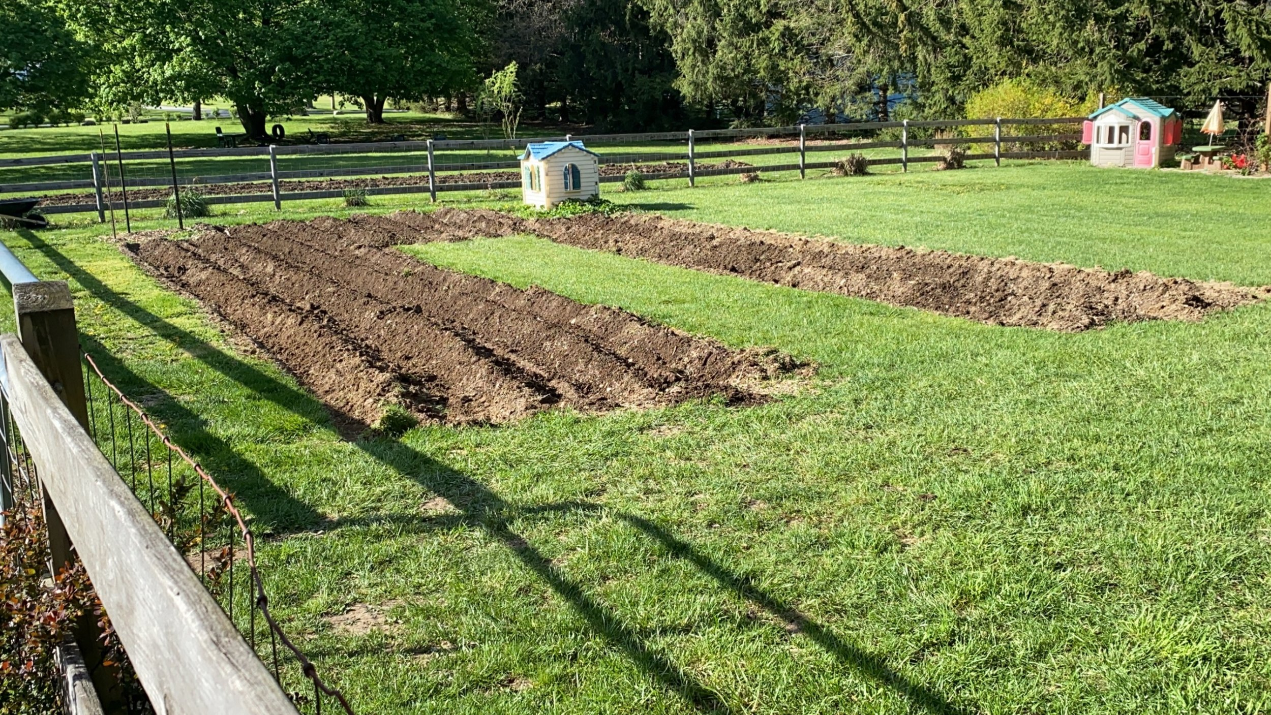

Then finally got to use my new Titan hiller at home. I used to spend a couple hours making rows by hand, was done in 5 minutes!
using my heavy hitch one tomorrow, sadly I am in rockier soil so can't use the furrower (drags the rocks) but 5 minutes per 30 ft row witha hoe takes care of that.

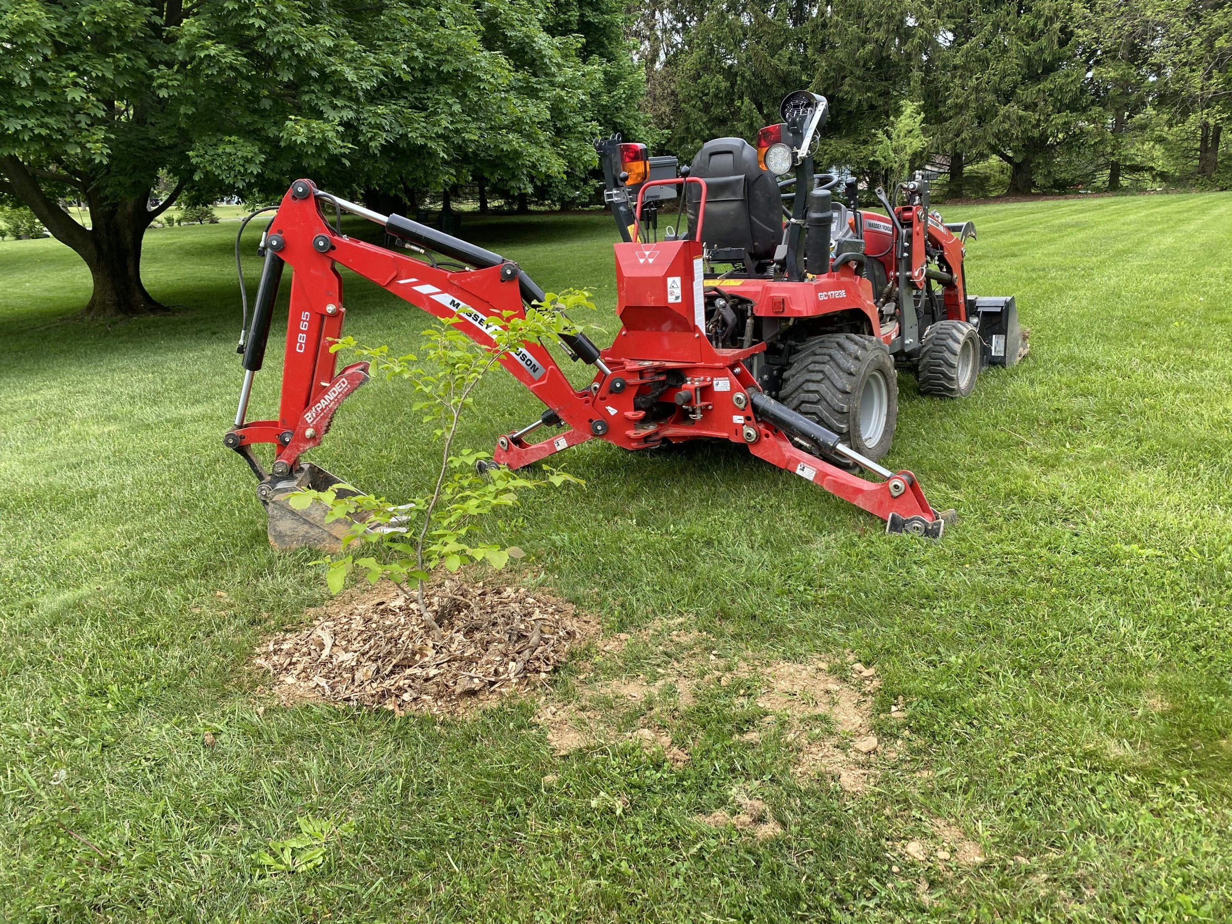

Sometimes I do stuff at home!
Witch hazel tree.

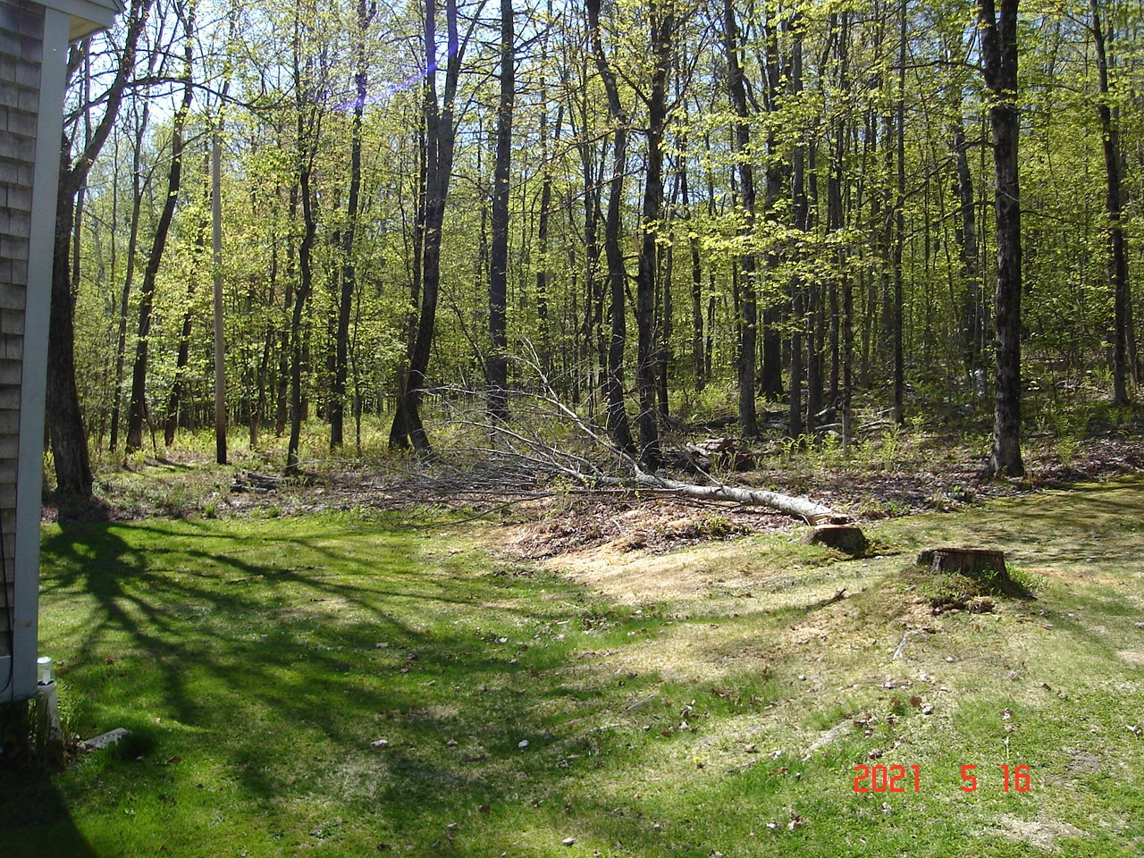

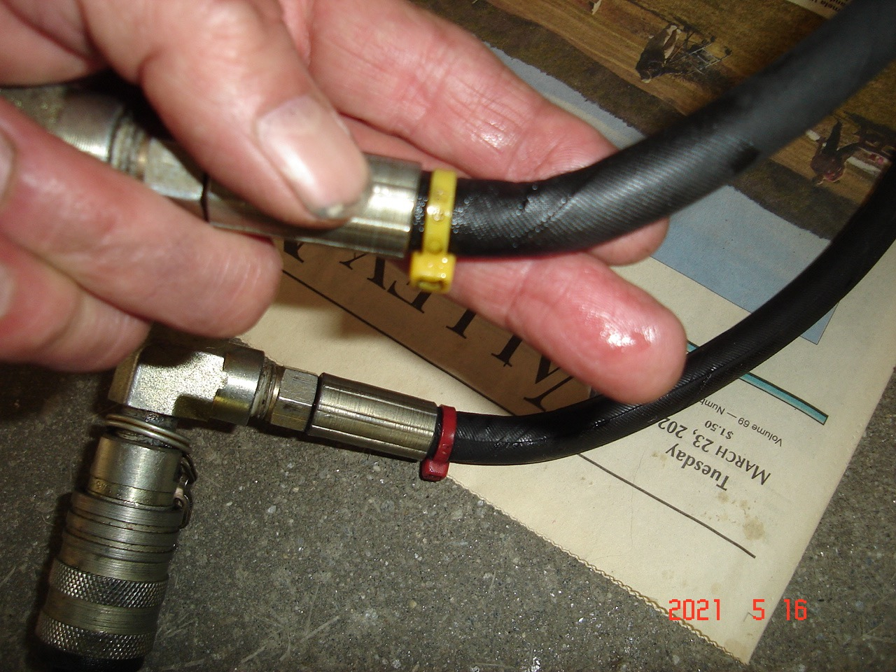

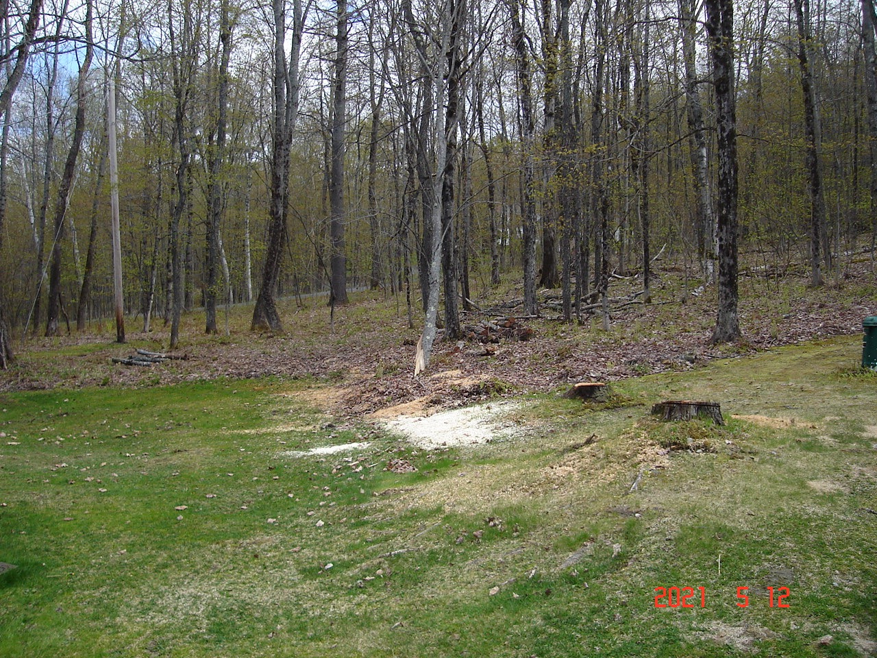

Successfully pulled a "widow-maker" (leaner) off another tree after cutting two trees down. Used FEL and a chain to lift the bottom & then pulled it to the right.
The Little Red Beast did it, but blew out a hydraulic line on the FEL. I got a nice shower.
Will replace that line and one other that looks shaky later today.

I guess 14 or so years, some hoses will go. Time to do a full inspection on them.
Good work on the trees.

Oh yes, last year I had to start replacing bad hydraulic hoses on my 12 year old MF.
The very first time that I replaced hoses are the 2 hoses for the snowblower "quick hitch" last winter, because I noticed the outside of one hose was looking very "wet" (was rubbing on the raw end of the 1/4" square bar that looks similar to a big lock washer and holds the hoses on the outside of the frame).
And yesterday, I just replaced the 2 hoses for the "backhoe's boom cylinder" that one hose had a pinhole leak hidden inside of the boom at the 180 degree turn for the hoses (MF had a raw end with a small burr at this location).
For me, I'm going to replace hydraulic hoses at the first sign of any "wetness" on the outside of the hose and hopefully I will avoid a hot/warm hydraulic fluid bath...
