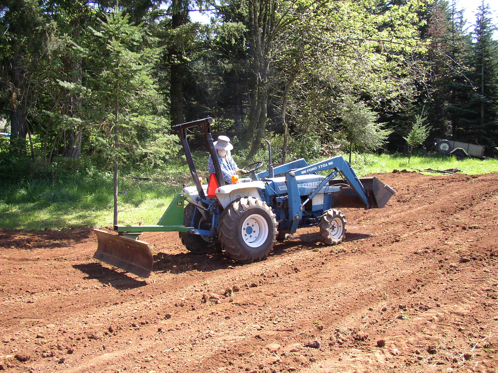

Here is what I have used for yard grading and it has worked out pretty good, however the ground will settle down in year or two unless you roll it down with something heavy.
This always works:
But also turning a 6' blade backwards and pulling it behind works surprisingly well:

Aha, so you did use grader blade. Question though do I have. You said - pulling it? Picture shows, you are pushing it, like a dozer blade, aye?
   / What implement best for turf grading with compact tractor? #27
No not pushing backwards.
I did the final surface leveling / smoothening by pulling a blade with the tractor going forward and the blade was reversed just like in my photo above. It worked much better than dragging a heavy old chain-link fence gate I tried first.
Prior to that I had done lot of bulldozer work in order to remove stumps & move dirt the way I wanted it, after which I did did lot of rototilling with an old 4' tiller.
The objective was to get proper drainage and reasonably smooth yard after lot of mature Douglas Fir trees were removed due to being too close to buildings.

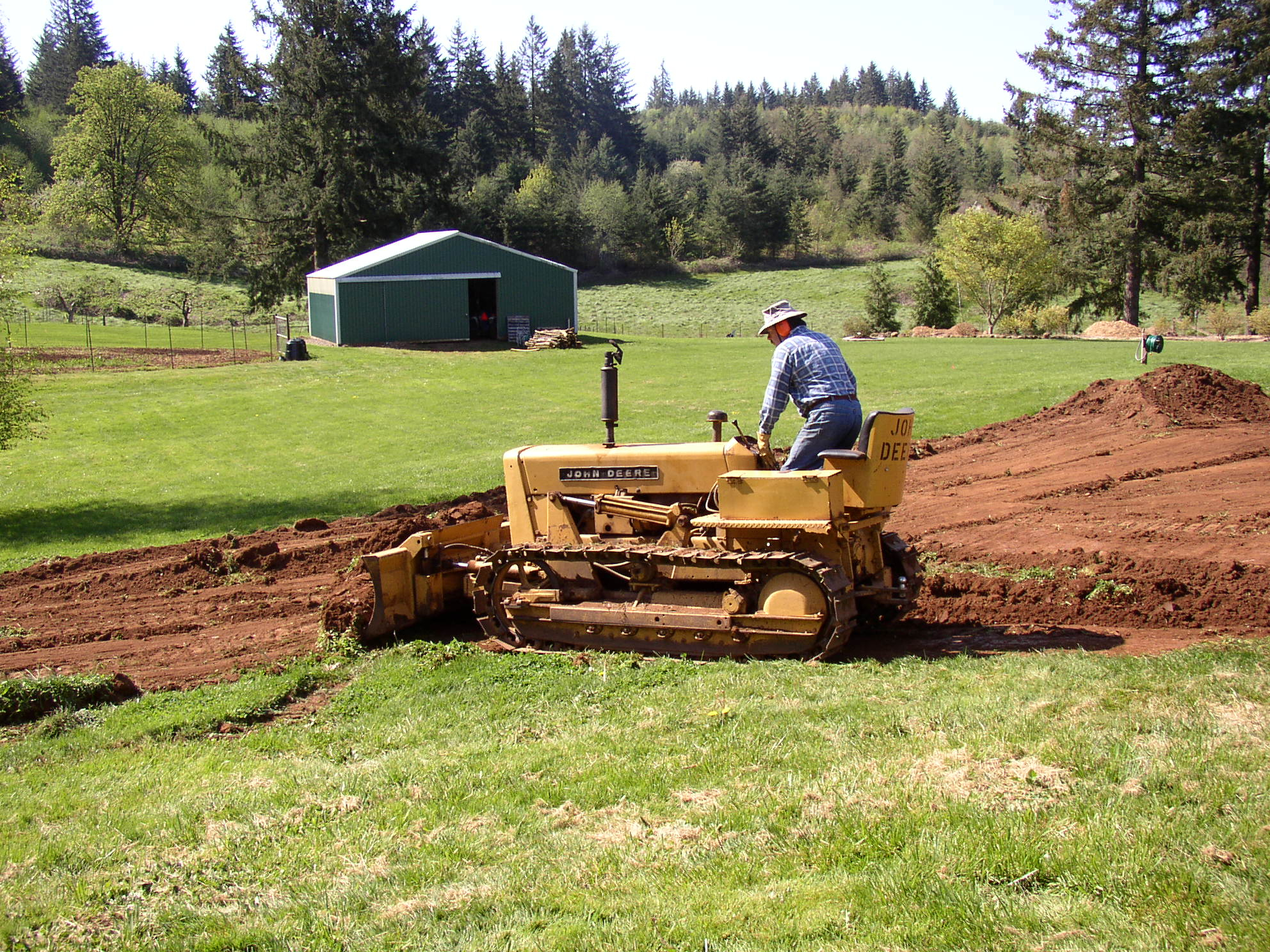

Gotcha. Did you use grading blade as blade though? Facing forward, as it should?
   / What implement best for turf grading with compact tractor? #29
Not much, I used my John Deere 440 ICD (6-way hydraulic blade) for most of the grading.
