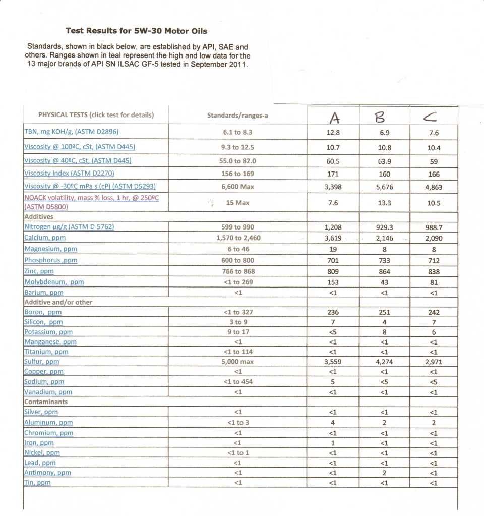

   / What is an "upcharge" on an oil change? #60
Which oil would you use?
Which one is likely the most expensive?
By cheap oil I mean oil made cheaply as opposed to sold cheap.
