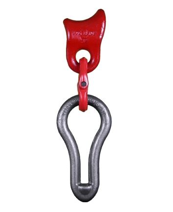

I use the keyhole on my choker chains because they don稚 accidentally disconnect. I found grab hooks on chokers will unhook frequently with the roll and tumble in winching.

   / What is the best way to install a grab link onto a chain? #65
Tools & equipment for small scale logging - YouTube
Found it. In the beginning of the video he shows how he uses both ends of the keyhole link.
His is fixed right into the chain. My issue is that the keyhole link I purchased is for 3/8" chain (only size I could find)
and it's going onto a 5/16" chain. And I would like to be able to easily mount it and remove it.
Need a way to get it on and off the chain and have it able to rotate for varied use.
Thanks, John - Now I understand the OP's intent. My Fransgard winch came with 3 similar chokers:
These are much nicer to work with than a "C" hook choker that I have.

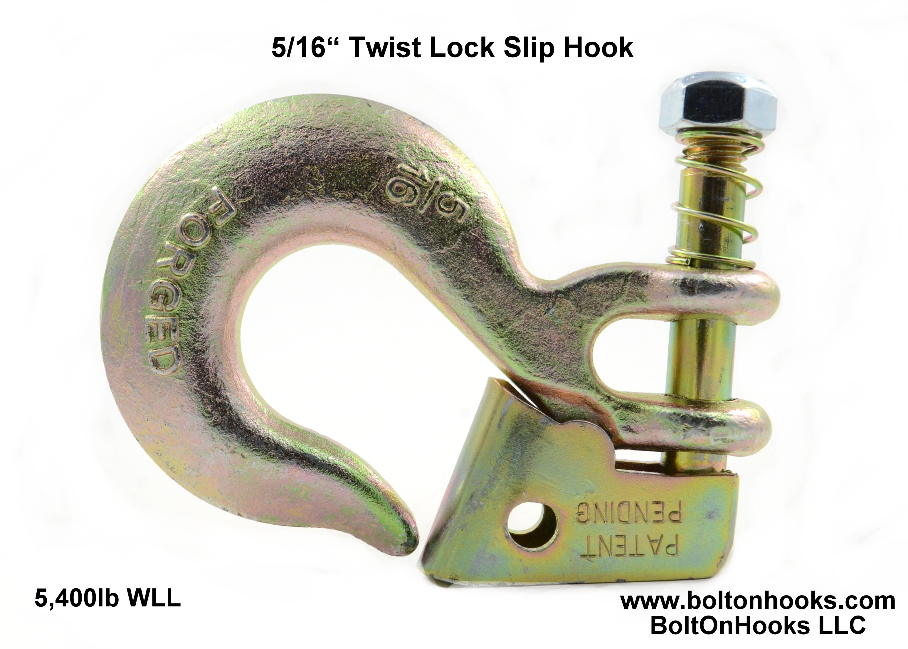

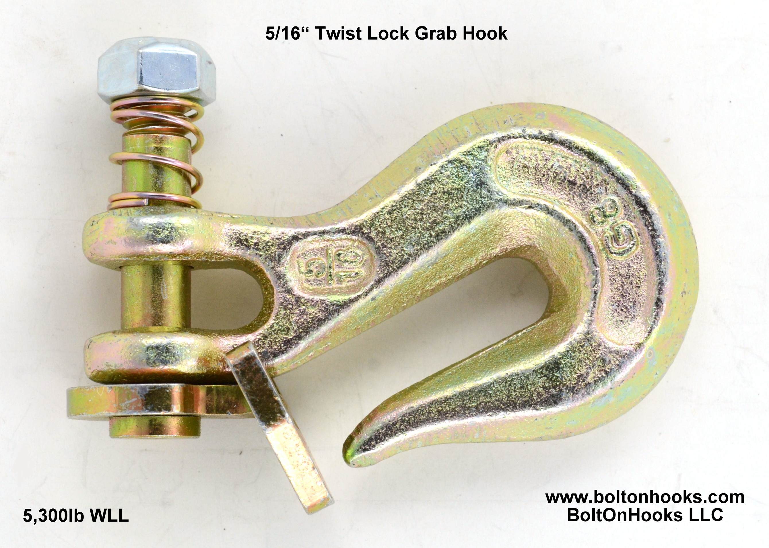

That little reverse curve at the tip of a hook is to keep the mousing in place.
But I sure wouldn't want to do that many times per hour.
Slip hooks with the little sheet metal safety latch don't last very long. This style is better.
Grade 70 Twist-Lock Slip Hook
Bruce
Bruce
I learn something new every time I read these forums - thanks for posting that!
For semi-permanent, DIY attachment of that grab link to a chain, a hammerlock looks like a good option:
