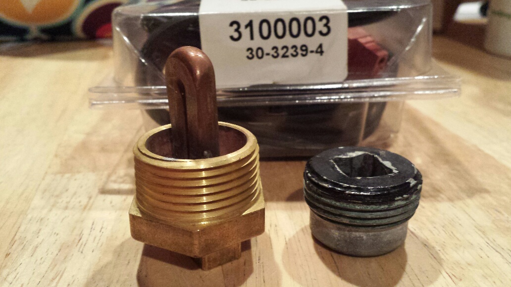

   / What is the cold starting like on the Yanmars with direct injection #12
Posting a pic of the ZeroStart 400 Watt 1 inch NPT Block heater, to the right is the plug that came out of my Yanmar LX.
Made in Canada.

Looks like I am going to lose a bunch of antifreeze when I screw out the plug. In other words the radiator drain won't drain the block. Is there a block drain point that would make it a bit more contained or catchable. Mine is fairly new and has red looking antifreeze. Anything special about Yanmar antifreeze?

I just bought a block heater from my Yanmar dealer. Yanmar started making them last winter. The dealer told me to remove the radiator cap to remove pressure and then put it back on good a tight. He said the coolant loss would be minimal with the cap reinstalled.

I don't see draining a gallon or two of coolant from the machine as a worrisome issue. Just don't drink the stuff. DO NOT use tap water as the dissolved minerals will plate out into the cooling system. Re-fill with distilled water and HD diesel coolant.

I lost all of 8 ounces when I installed my block heater, there is no need to drain the block. I topped it off with Zerex G05 coolant which meets Yanmar and John Deere spec. It also mixes with my Jeep and my wife's mini cooper.
http://www.valvoline.com/pdf/Zerex_G-05_AFC_Technical_Bulletin.pdf
The Zerex is neutral in color, it won't affect the color of the existing coolant in your LX. I bought mine at NAPA.
