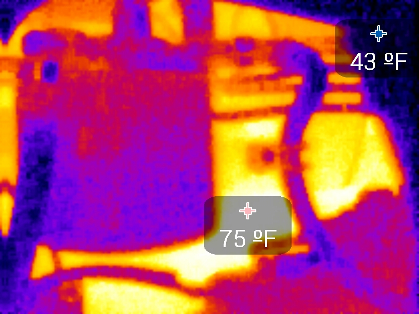

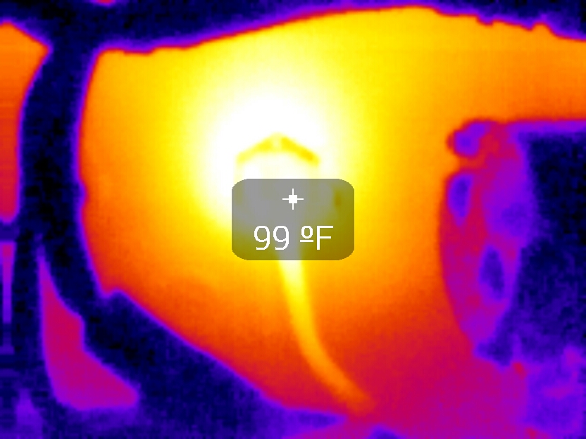

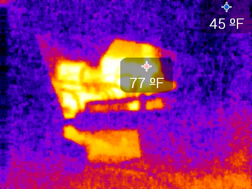

I picked up a thermal camera for my smart phone this week and have been playing around with it. Here are some pics from tonight after plugging in my block heater (same as raised on a deere's) for an hour. I thought ya'all would want to see them.
First, its in the twenties here in Southern Maine tonight.
Note, my garage is not insulated. I think the temps printed on the thermal images are a little high, maybe by 10-15 degrees, but you get the idea.
This picture is from the "passenger side" of my LX. You can make out the glow of the engine between the coldness of the loader arms and lift cylinder.
This picture is of the "passenger" side of the engine. That is the secondary fuel filter on the left.
Finally, this is the other side of the engine where the block heater is plugged into. The starter is on the right.
Pretty cool huh? The 400 watt block heater does a pretty good job on these 4cyl Yanmar diesels.

45F is not cold.
The outside air temperature was in the low twenties, the part with a 45 degree reading was inches away from a heat source radiating from the engine block.
   / What is the cold starting like on the Yanmars with direct injection #34
It sounded like the tractor was sitting in the shed with 45F ambient temperature around it. Even IF the engine would start at 20F without a block heater. The engine should still USE a block heater anyways. It's not going to break you to use 1/2 a KW and have the engine start and run like summer time. Less wear from having cold cylinder walls, less fuel contamination in the crankcase oil, less thermal stress, less wear on starter/battery/alternator, less stack smoke, less emissions and better fuel efficiency.
