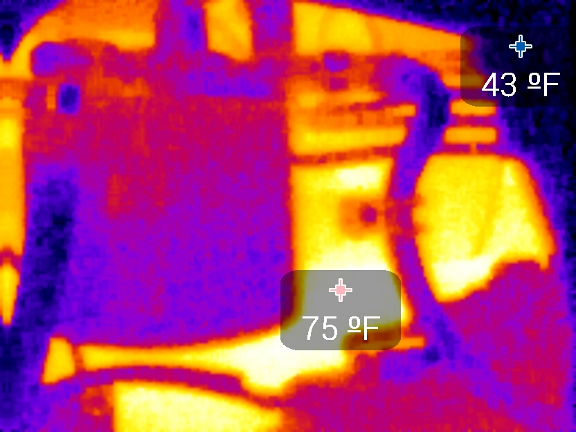

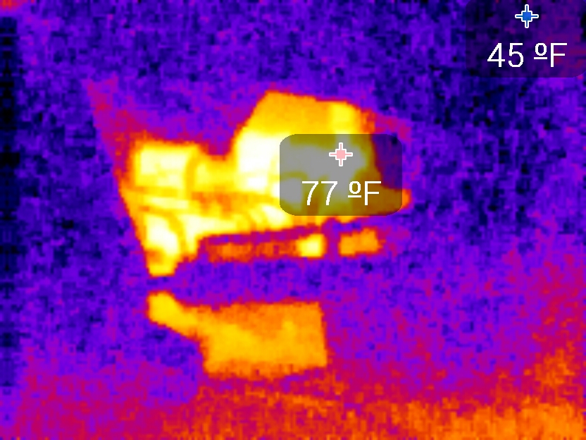

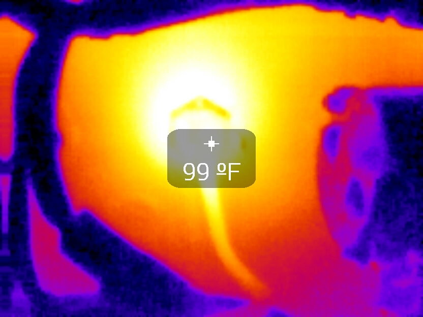

I picked up a thermal camera for my smart phone this week and have been playing around with it. Here are some pics from tonight after plugging in my block heater (same as raised on a deere's) for an hour. I thought ya'all would want to see them.
First, its in the twenties here in Southern Maine tonight.
Note, my garage is not insulated. I think the temps printed on the thermal images are a little high, maybe by 10-15 degrees, but you get the idea.
This picture is from the "passenger side" of my LX. You can make out the glow of the engine between the coldness of the loader arms and lift cylinder.
This picture is of the "passenger" side of the engine. That is the secondary fuel filter on the left.
Finally, this is the other side of the engine where the block heater is plugged into. The starter is on the right.
Pretty cool huh? The 400 watt block heater does a pretty good job on these 4cyl Yanmar diesels.
