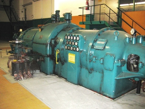

Stahl Laval (Ljungström) Steam Turbine Generator set.
The turbine consists of two opposite rotating halves with a generator on each end.
You have to sync the two generators together by flashing their fields and "locking" them together before you can put it online.

I'm a retired electrical engineer (both power and computers) and I'd love to know HOW you flash their fields and sync them - and how do you synch them with the online frequency?
GN
GN
It's been a long time (I'm retired now) but the rotating halves are going at the same speed, they just might not be in phase with each other. A common source was used to flash the fields and the output of the two generators fed a single breaker. You have two freewheeling AC outputs that would naturally sync up on the generator side of the breaker. There's no gearbox so the lagging side could easily come into phase, and then far as the output was concerned it was a single source. After that putting it online was the same as most gen sets, watch the synchroscope and have a sync check relay as safety backup. Although most PLCs do this automatically now, I've done it manually plenty of times.

Don't understand how 2 outputs are "free-wheeling". Yes, I've synched generators but always with internal synching electronics. Phase synchronizers. Does water turbine flow drive these generators?
