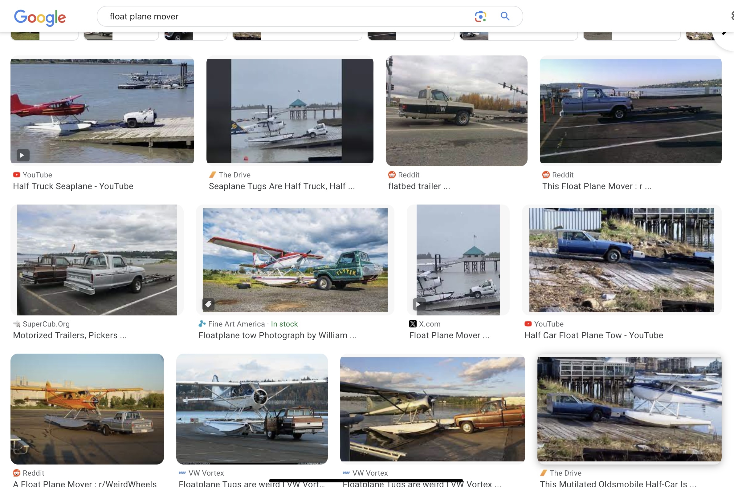

Check out Float Plane Movers... :ROFLMAO:
