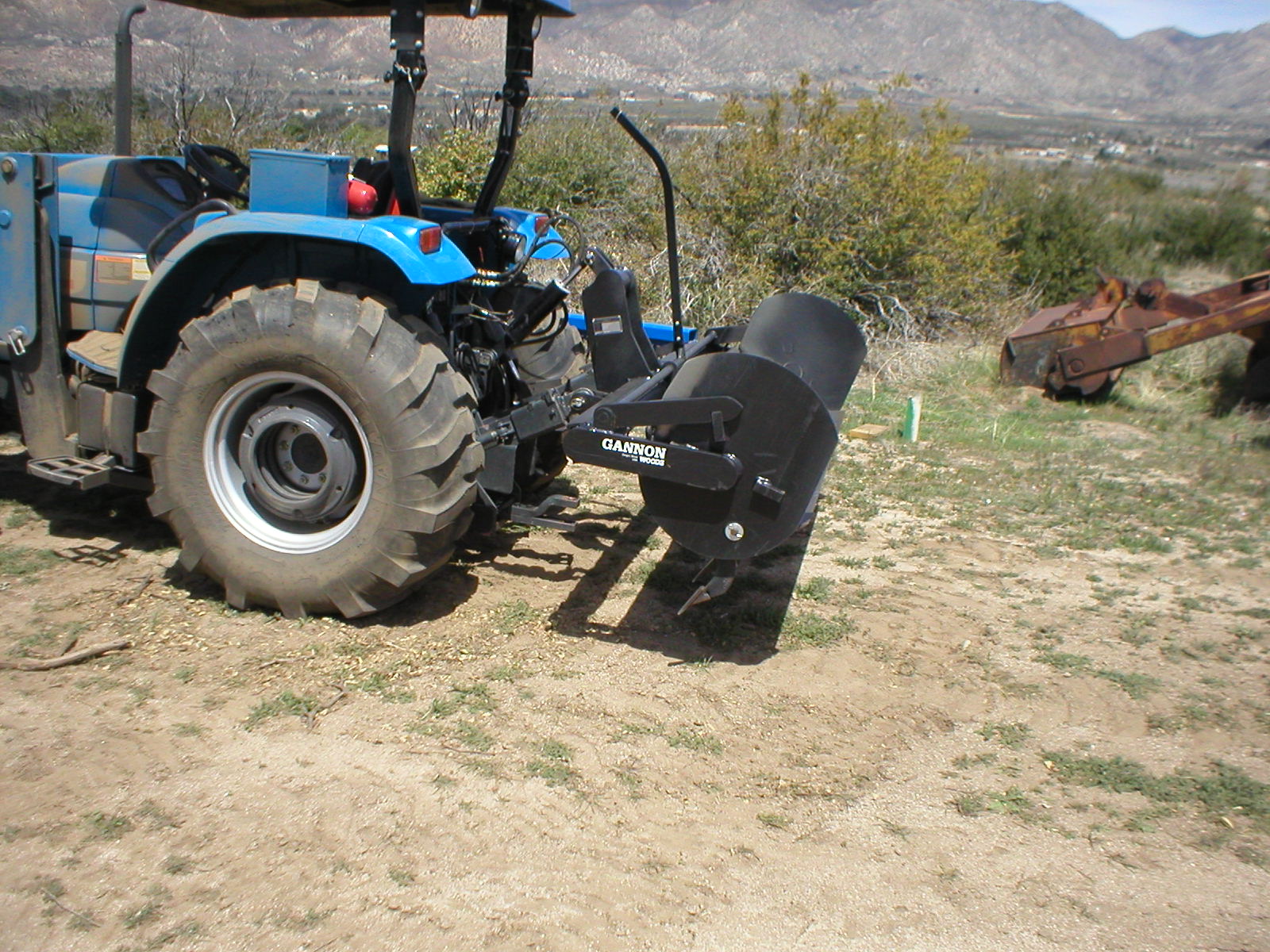

A couple of things, I agree that a 1200lb ROBB would be nice, but it has never been made. I have what I believe anyway, to be the largest heaviest Gannon ROBB that was ever built. 81" wide and 980lbs.
You might want to lengthen your top link to get the maximum from your rippers. You want your shanks to be straight down and the teeth will then be angled at the optimum angle. Your going to be down 10", so it will be a load on your tractor. Try it and see what you think. ;)
