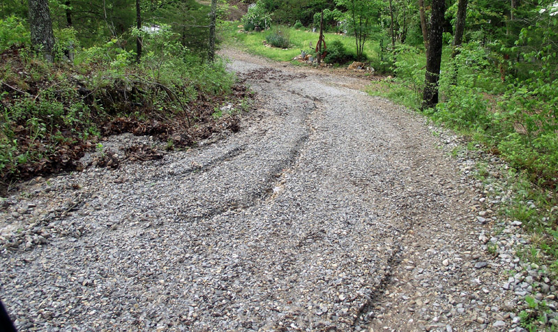

Okay, the OP was asking about box blades and you posted about your road grader. I was curious and clicked over to your link and saw a marketing picture of clean gravel being smoothed on a smooth path on flat ground. I just got a giggle in that their marketing picture conveyed little of anything useful except, perhaps, the tool is overkill for the task depicted.
The picture shows expensive rock hauled in. Done that more than once!
Around here, the Missouri Ozarks is seldom flat and usually rocky. The flat parts become the repository of all that expensive rock sluiced down from the new ruts formed by the occasional downpours. The BB is used to pull that rock back up the grade where it belongs. While doing that you can expect the BB to kick up softball-sized to bowling ball-sized rocks that sprout like mushrooms around here in the spring.
The right tool for this task is a BB:
Successful BB work is having your ruts filled, your gravel back up on the sloping drive, and a new pile of rocks at the top of the grade for FEL to cart away. If that is the job you have to do, I can't see buying the Road Grader and putting the BB on Craigslist.
And, really, I'm not criticizing the Road Grader. My frustration is the purveyors of all these attachments depicting them in pristine condition on flat ground under sunny skies. Trying to learn from marketing materials is useless.

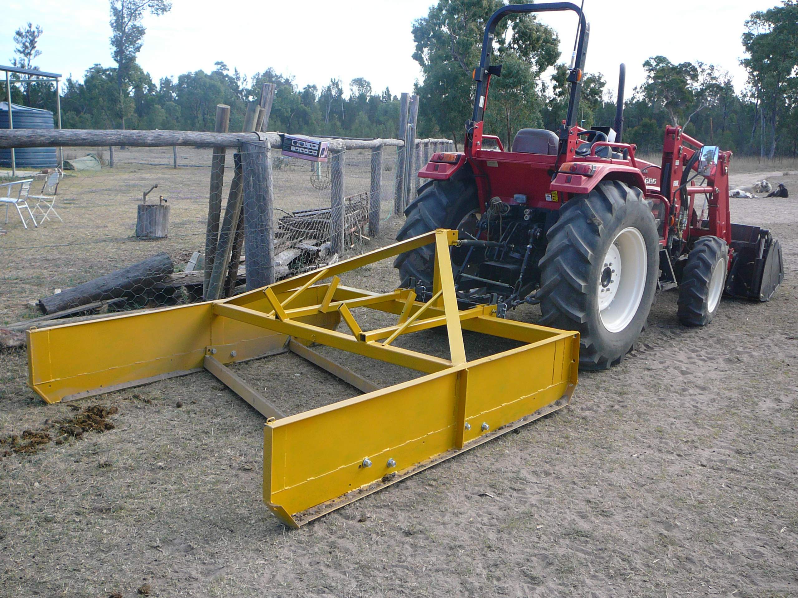

A couple of things to consider regarding Land Plane Grading Scrapers and road maintenence.
Everyone does not have all the "proper" material brought in for their roads.
Everyone does not have the water problems that others have simply because it does not rain a lot everywhere although some people may not think that is the case.
People that do have water to contend with, probably should have their road sloped in some way,(either a crown on the road or sloped to the side) so that the water does not run down the length of the road. That way the material does not run to the bottom of the hill as shown in some pictures that we so often see.
People that have these LPGS implements grade their drives more often, because it is so easy and quick, so their drives do not get bad and need any major repair. There drives are pretty much always in good shape because of this.
I have 4 types of implements for working my 2 3/8 miles of roads and fence line.
A rear blade
A box blade
A landscape rake
A LPGS
Once the roads were done, and that is with onsite materials only, I only use the LPGS unless I just want to pretty things up with the landscape rake.
I know that everyone's circumstances are different, but I am pretty sure that just about every single person that has a LPGS would not be without it. I don't think that you will find anyone that wants to sell their LPGS because it does not work and they just don't use it. The best that I can tell from people that have them and post about them, everyone likes them. There are no posts saying that they are no good. Some might be better than others, but there are NO bad ones that I know of.

I kind of don't get this. A hill like the one pictured earlier in this thread would need a ridiculous amount of slope just to get the water to run at 45 degrees. At a certain point, do you just give up and accept there's nothing you can do?

You put water bars in to divert the water off of the road. You never want the water to travel any long distance. With distance, that gives the water a chance to do the damage of eating in and moving material. Get the water off of and away from the road As Soon As Possible and the damage is minimal.
And you are correct, a LPGS is not always the right tool. It is a maintenance tool for most dirt-gravel roads. A box blade or rear blade is a build with implement and is what would be used to either build or do serious maintenance of a neglected road.
Once the road is shaped and at least some what in shape, that is where the LPGS excels. ;)

Bob, as you already know, a BB is a cutting tool that has the ability to transport moderate amounts of material. People struggle trying to use the BB because they don't quite understand that. I'm sure you do, as I do, and many others on this thread.
A Land Plane, Grader, whatever you want to call it, is a leveling tool that has the ability to transport very small amounts of material. It's much easier to use in leveling situations as the cutting ability is limited by the runners it slides on.
Each tool has it's place. And as I and others have said, we'd love to have one, just can't quite get over the cost for the amount of use we'd have.
