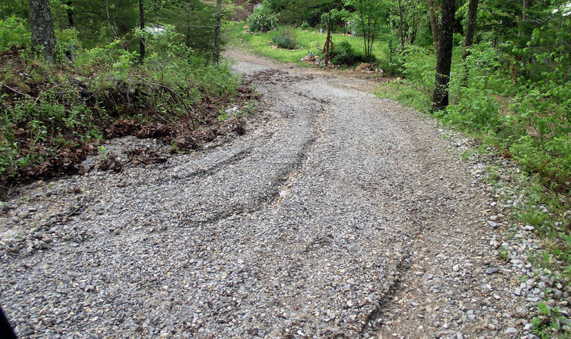

Okay, the OP was asking about box blades and you posted about your road grader. I was curious and clicked over to your link and saw a marketing picture of clean gravel being smoothed on a smooth path on flat ground. I just got a giggle in that their marketing picture conveyed little of anything useful except, perhaps, the tool is overkill for the task depicted.
The picture shows expensive rock hauled in. Done that more than once!
Around here, the Missouri Ozarks is seldom flat and usually rocky. The flat parts become the repository of all that expensive rock sluiced down from the new ruts formed by the occasional downpours. The BB is used to pull that rock back up the grade where it belongs. While doing that you can expect the BB to kick up softball-sized to bowling ball-sized rocks that sprout like mushrooms around here in the spring.
The right tool for this task is a BB:
Successful BB work is having your ruts filled, your gravel back up on the sloping drive, and a new pile of rocks at the top of the grade for FEL to cart away. If that is the job you have to do, I can't see buying the Road Grader and putting the BB on Craigslist.
And, really, I'm not criticizing the Road Grader. My frustration is the purveyors of all these attachments depicting them in pristine condition on flat ground under sunny skies. Trying to learn from marketing materials is useless.
