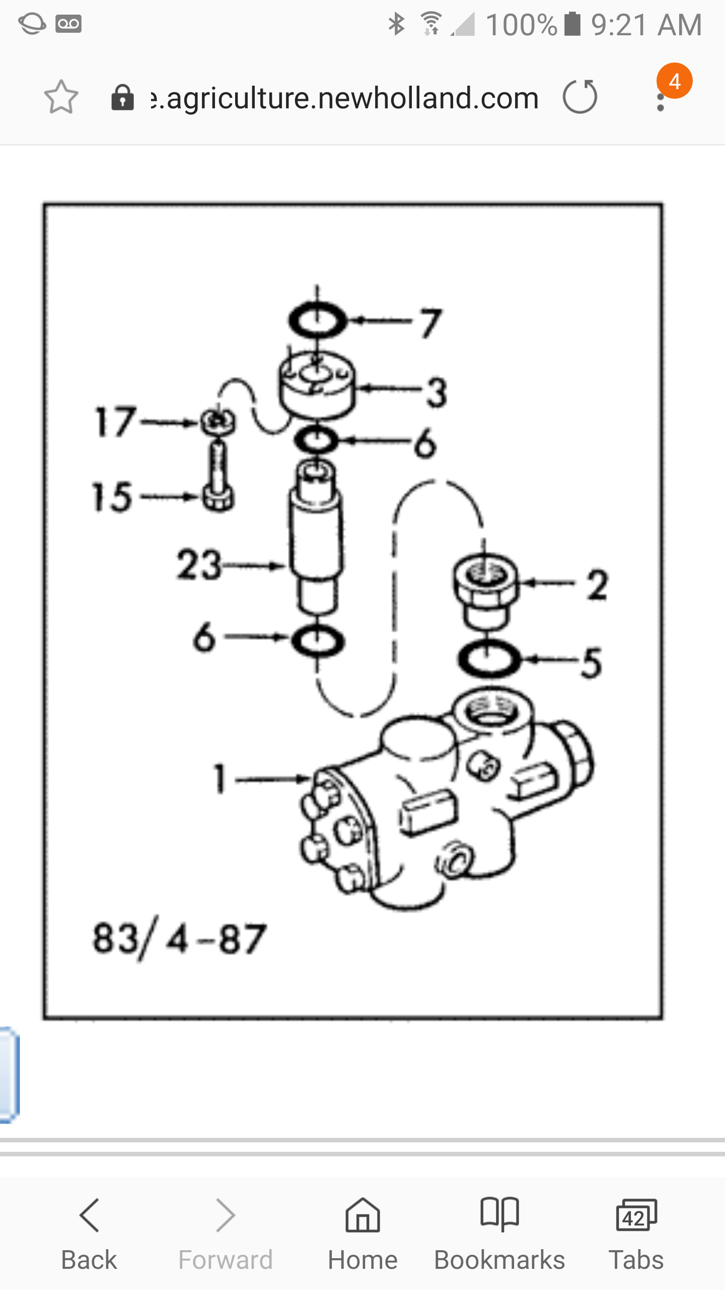

Go to www.newholland.com
Select agriculture
Upper right "Parts Store"
Find Parts By Model
Search for Model, enter 1710
Select 1710 3 Cyl Compact Tractor
Front Axle & Steering
03F02 Power Steering Tubes 1510 & 1710

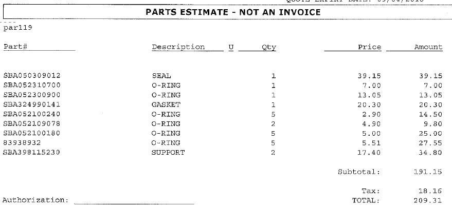

Here is an invoice I got from my local New Holland dealer. Parts are the 3 point hitch seal and o-rings, a gasket for the 4-wheel drive lever, and all the o-rings on the priority valve.

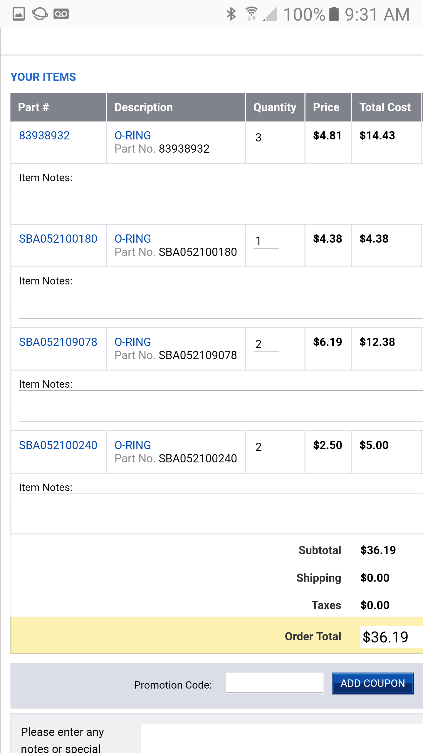

Another question on this thread. I looked up the parts as eric suggested but total was 60 plus dollars!! Seems mighty steep for .50 cent O rings. Does anyone know the sizes I need to just order directly?
Might consider to buy a set of assorted metric Harbor Freight O-rings and try to match with the one you need replacing. If it works fine and if it doesn't then you are out of $10.
JC,
   / What is this and how do I fix it? #39
True, i guess i can try it! I wonder if those are rated for the hydo fluid.
   / What is this and how do I fix it? #40
They have both Viton and Nitrile for the same price. Viton would be a better.
