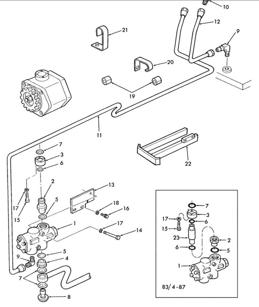

What is this and how do I fix it?
   / What is this and how do I fix it? #41
Update:*I fixed the leak, just in case anyone ever needs to do this. Its easy and I can probably*do it now in 10 minutes.
Step 1: get tools,rags,and orings for job.
Step2: remove small line that goes from valve, (looks like a thin brake line).
Step 3: remove bolt at the bottom of diverter valve. ( it is a banjo bolt with 2 orings, one on top of hardline hose and one where bolt meets hose.)*
Step 3. Remove bolts that hold diverter plate/mount to frame. Slide diverter down and off. It will have 1 oring inside diverter where tube slides in. This oring was torn on mine.
Step4 take off 3 10 mm bolts that hold tube to actual pump. (There will be another Oring inside the round oriface that holds tube. This oring was also torn and needs to be replaced.
Step5 put it all back together.*
It is very easy*to do and when you do it you will see why it leaks and how ****** a design it is. Hopefully the guy that designed that got fired!
   / What is this and how do I fix it? #42
Nolo thanks for the info. I am having the same issue with my Ford 1510. Can you tell me what tools you used to remove the large banjo nuts? I don稚 have a wrench that wide that will fit in those spaces. Thanks again
