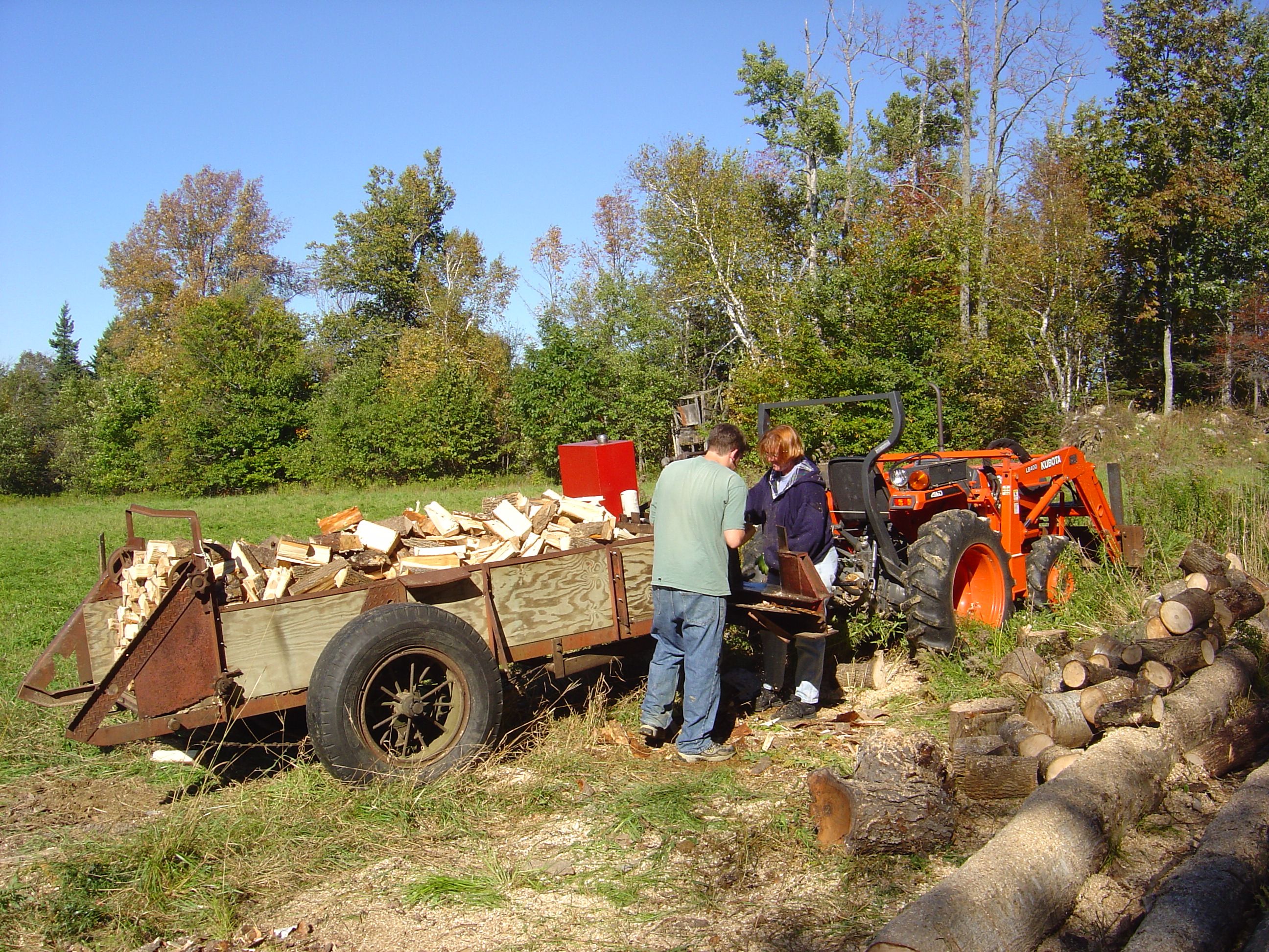

One of our best trailers was a manure spreader that we modified. We kept the live-bed, but moved that by a lever-hand crank instead of being wheel-driven. We then put our wood splitter on the hitch and could toss firewood right from the wood splitter into the bed of the trailer, then at the wood shed hand-crank the firewood off it.
It really worked well, and saved a lot of extra steps.

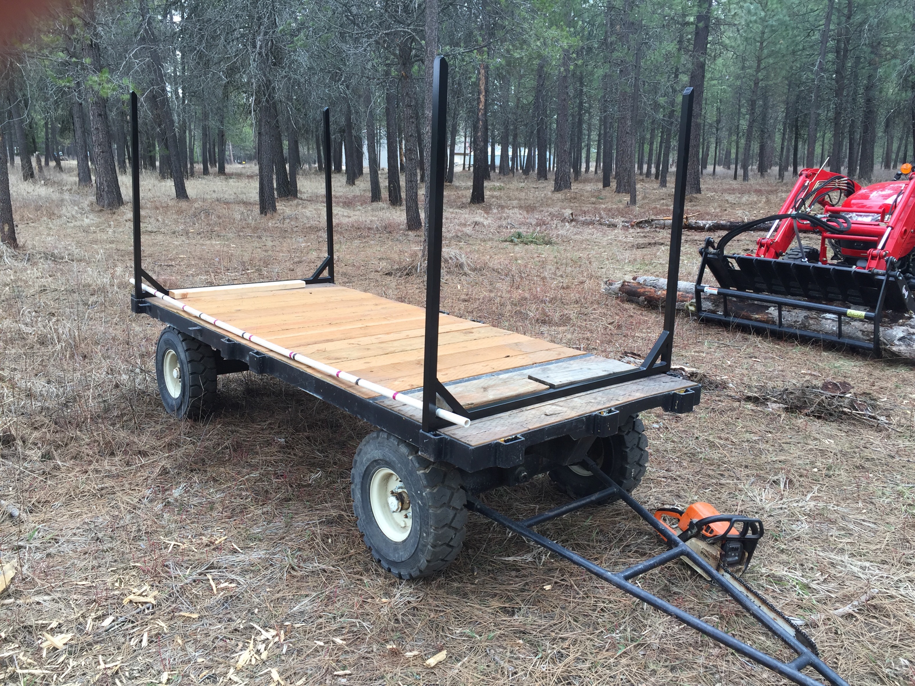

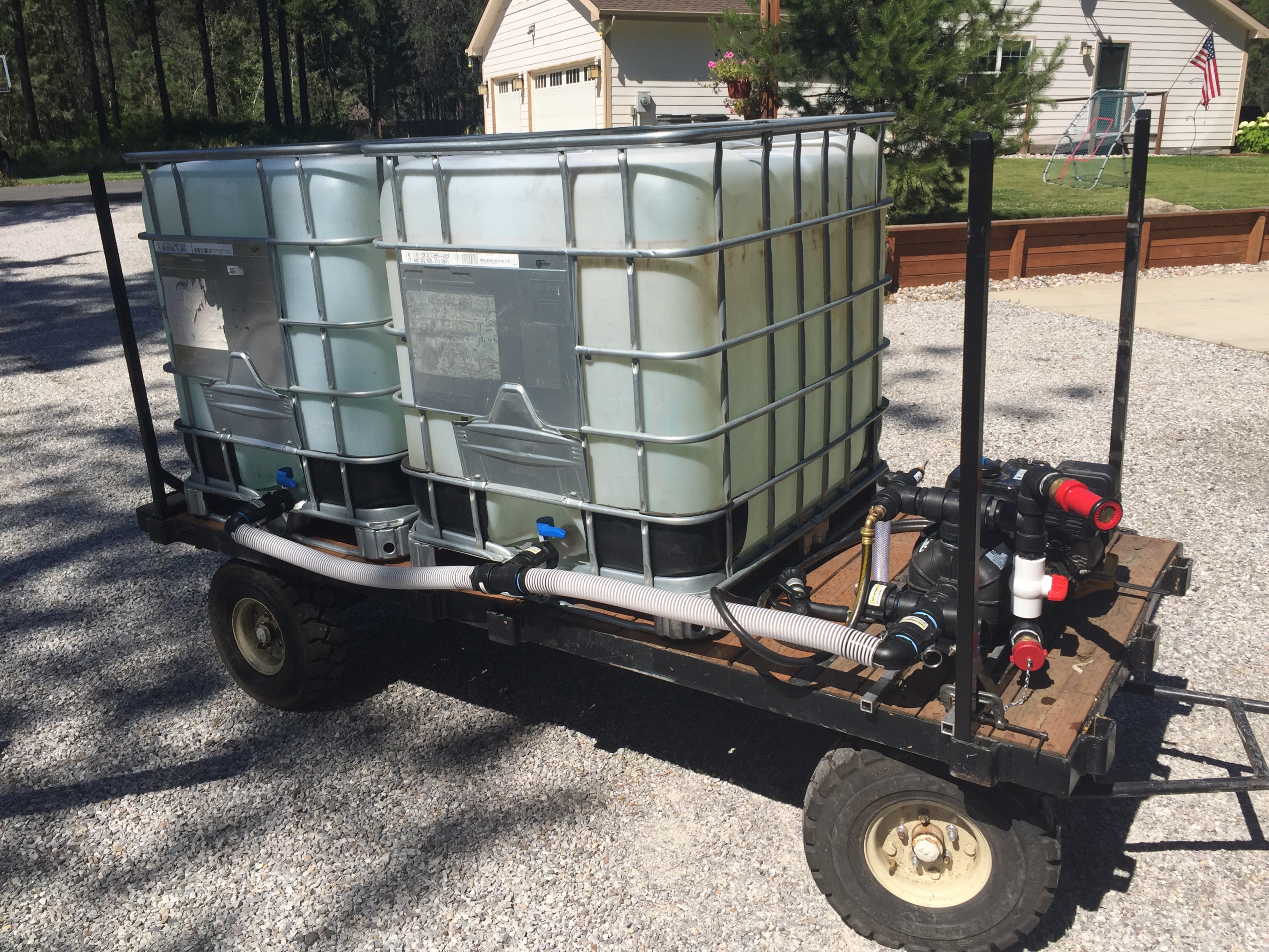

If you get lucky, you could find a former military surplus trailer. This was made in 1953 and has a 6,000 lbs capacity. It doubles as a fire rig during the hot dry summers carrying 2 x 275 gallon totes with a pump.
My price for the trailer? $0 I was buying a large square tubular steel for a project and spied this off to the side with rotted wheels. He noticed it and said to take it if I can! I estimated that I put in $250 buying new 10-ply tires & new 2 by’s and I was in business already. The fabricated removable uprights and the fire setup came later.
