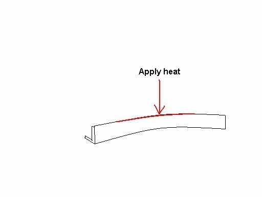

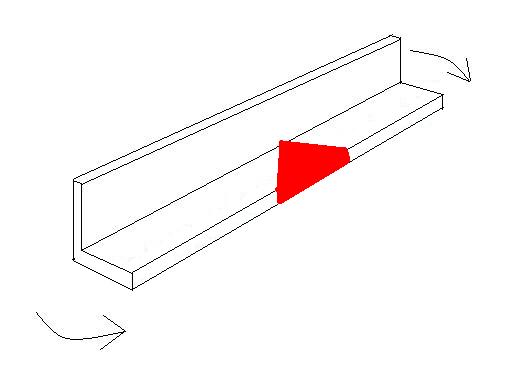

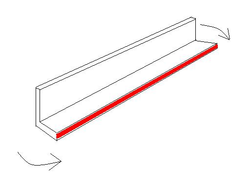

Copper plate for backing then tack weld it alternating the locations to keep the angle straight. It is going to be a challenge to keep it straight. Bolting the other angle to the one you are welding might help a bit to keep the welds from drawing too much but you still need to weld opposite side from the bend as the previous weld cools it is going to contract and pull the angle.

Angle iron, as with square tube is easy to bring back straight after welding.
