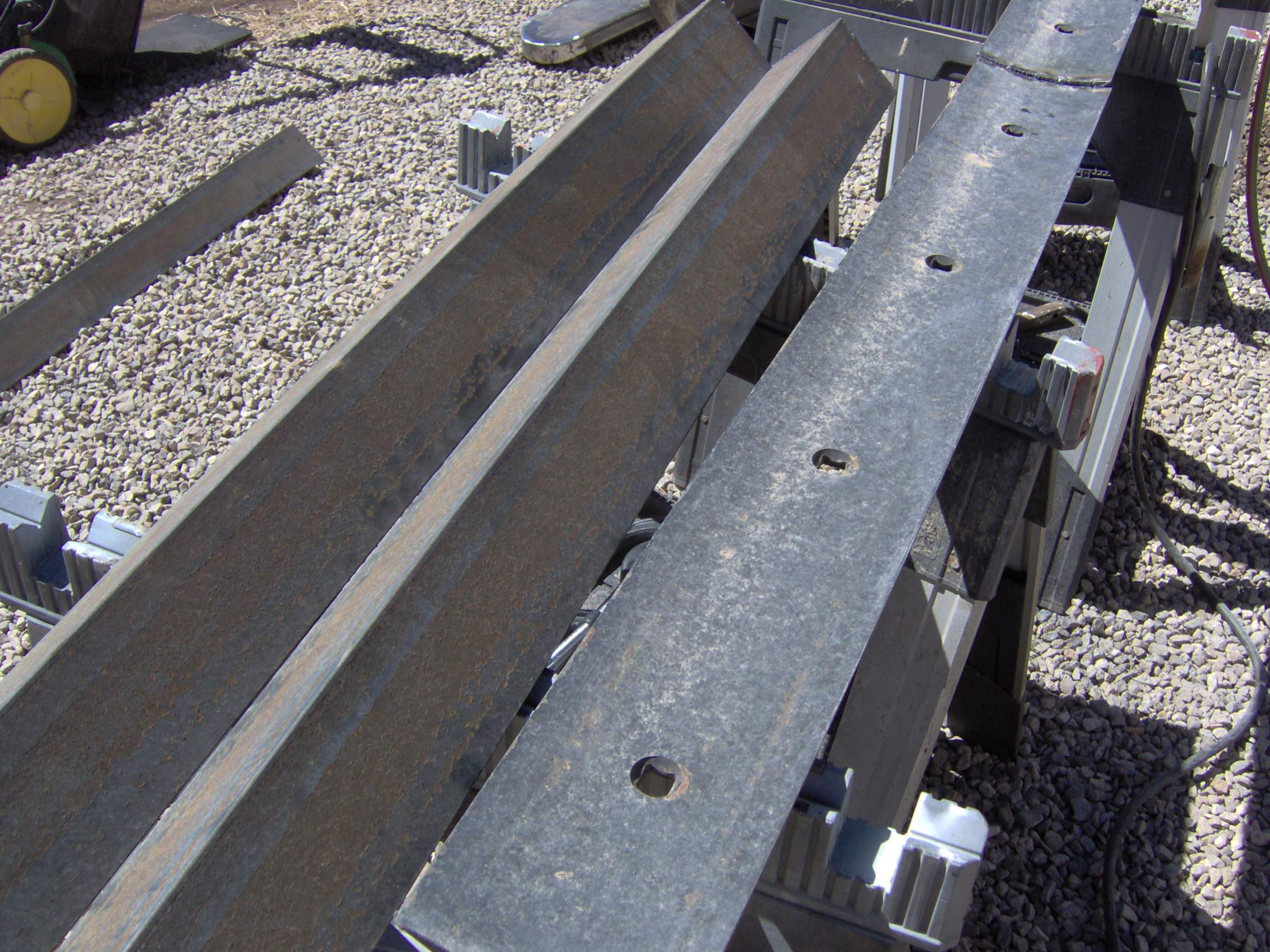

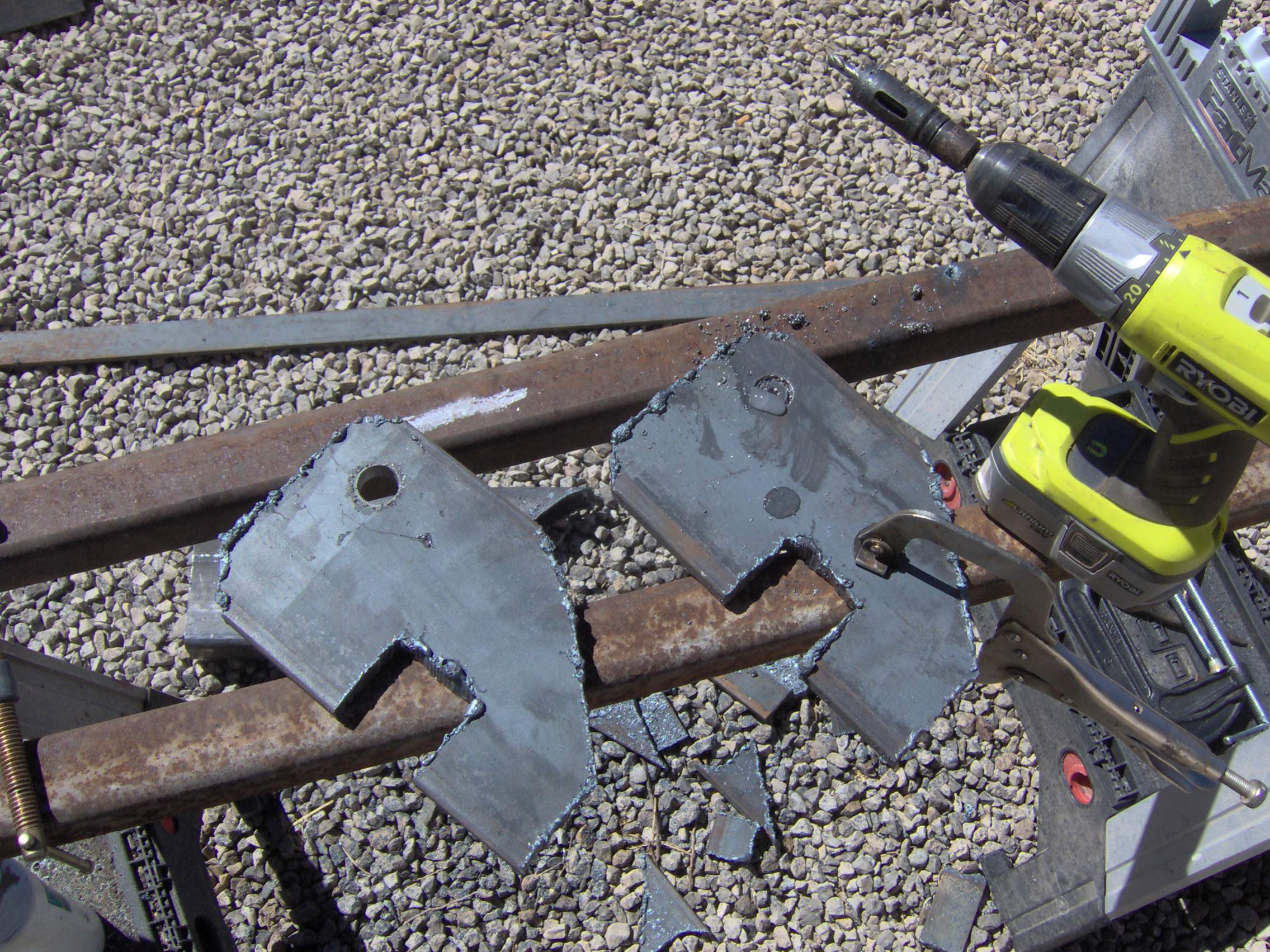

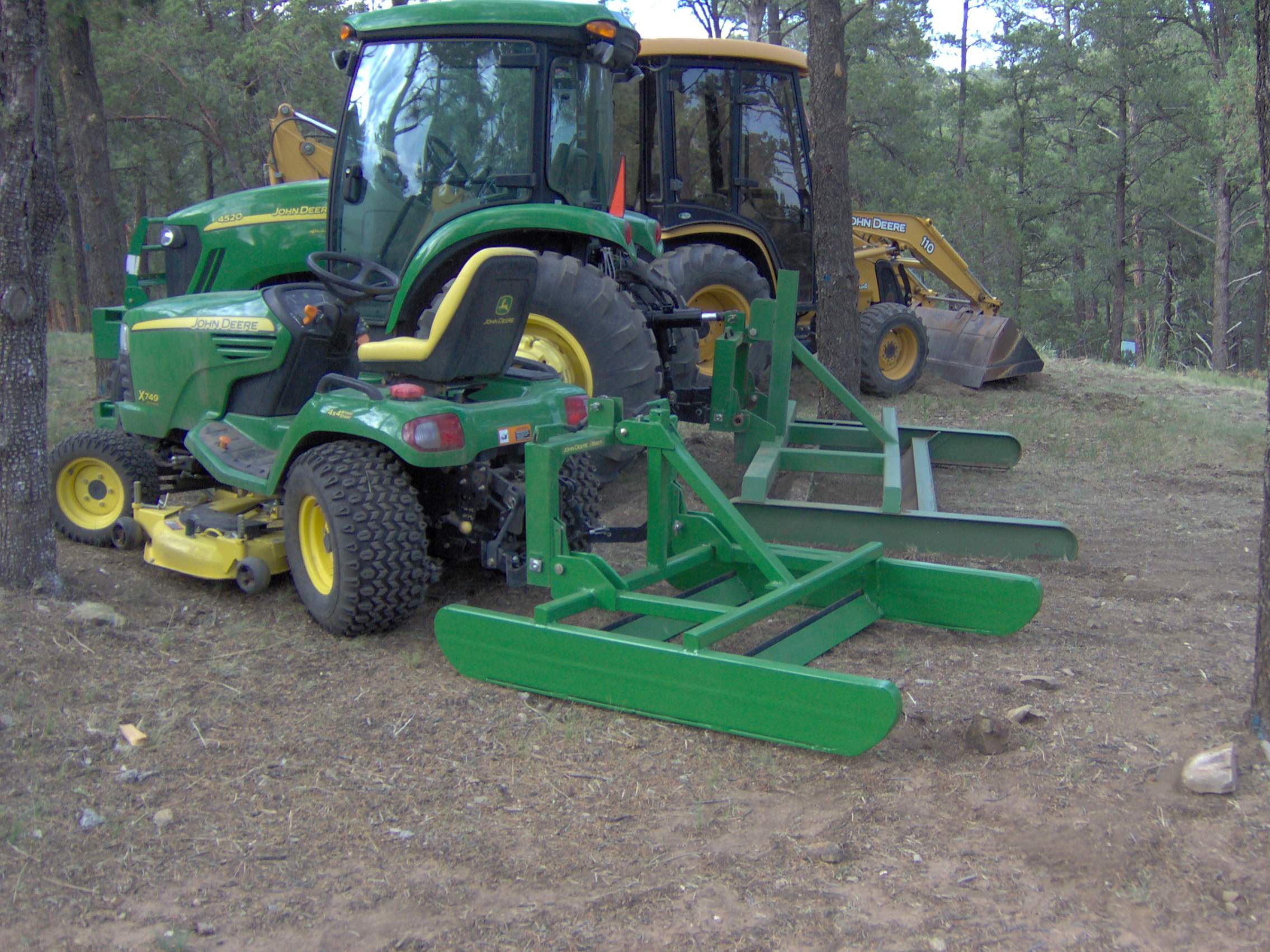

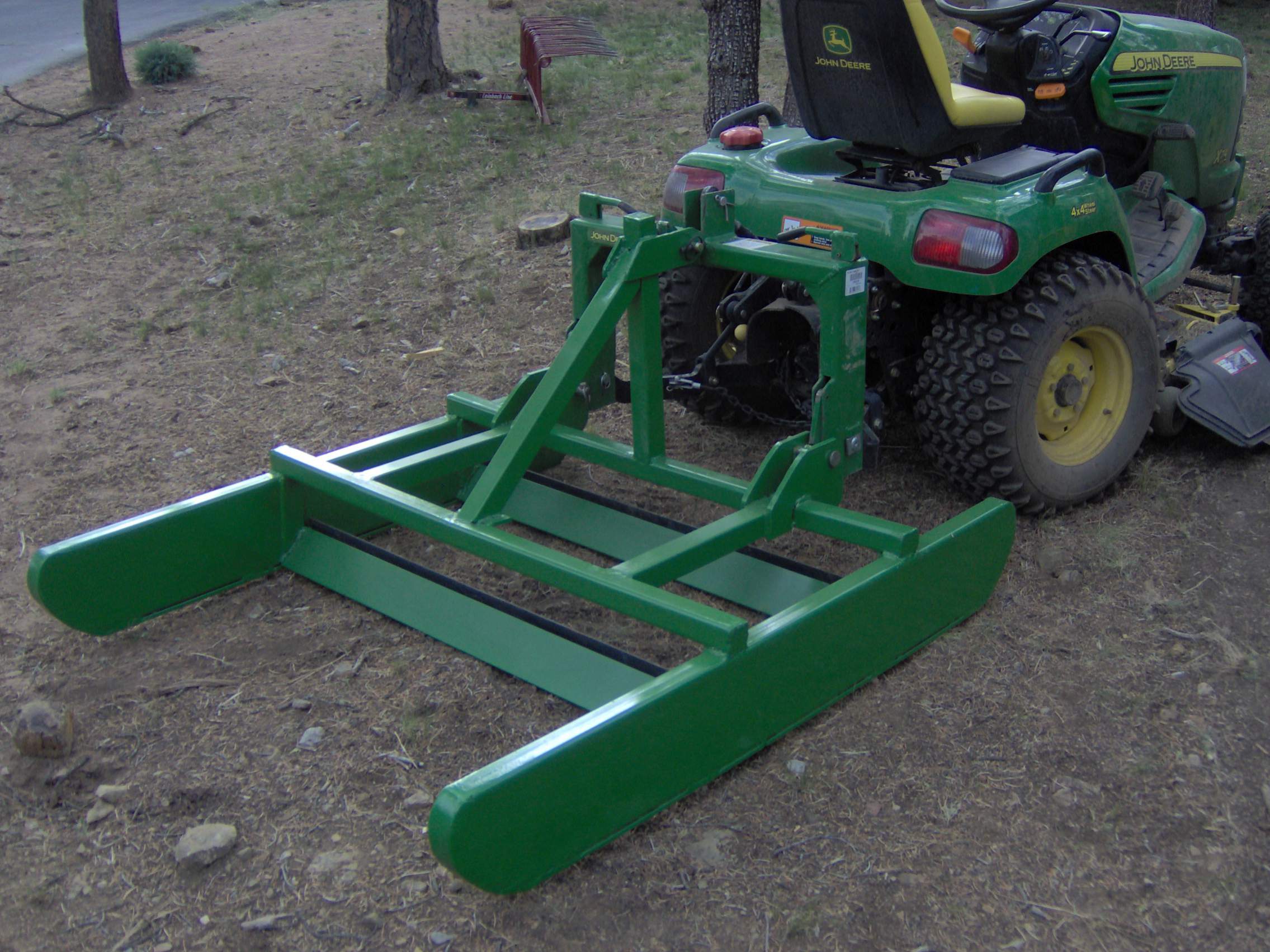

Last year when building a new landplane I posted a picture of what I used to drill the mounting holes. While I have a large drill press and lots of other various tools I know that most of the guys don't have as much to work with. I used a very limited set of tools to build this implement, torch, stick welder. grinder, chalk, clamps and saw horses. I drilled the holes for the 5/8" plow bolts with a holesaw Lenox or Milwaukee I suspect and cordless drill. Worked pretty well with no problems maybe three minutes per hole. Clamp the new blade over the bucket and use the holes in the blade as a guide for good line up. I can usually remove the pilot bit if the blade is a close enough fit and have less material to remove.
While I would not use this method for machining intricate parts to tight tolerances it works well enough for mounting a new blade on your bucket. If that didn''t work I would have torched the holes and been good to go.
