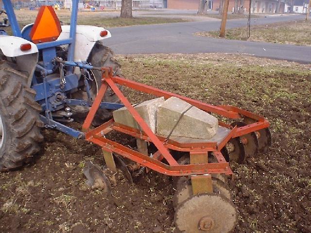

Re: What now? Disc won\'t penetrate
Picture.
Wait for a rain. As soon as the soil is dry enough to not stick to the discs try it. Our ground here gets so hard that it can not be plowed with a 235hp 4wd tractor with duals. After a rain it is no problem.
