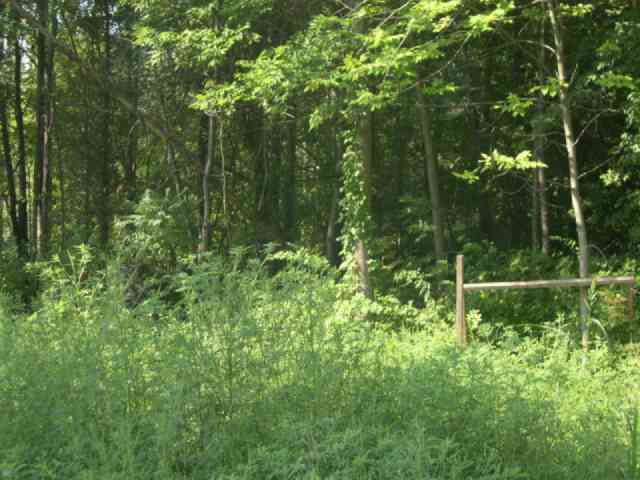

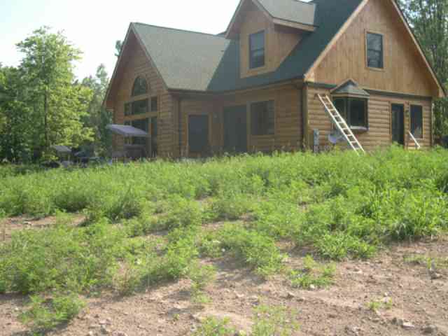

If I did this right there should be a couple of pictures to follow of my weed farm. This is my lawn /forums/images/graemlins/crazy.gif, I had it leveled out 2 months ago and waiting for fall to seed. Tried running my 3 pt. disc over this mess but ground is to hard. Way to rocky to bush hog or till and york rake just glides over the weeds. I want to try to get the rocks out myself without hiring a harley rake and operator. But between work, vacation and building this house myself I lost the "War of the Weeds" /forums/images/graemlins/tongue.gif. My question is: what is the best way to apply weed killer to stuff this tall and what's the best kind /forums/images/graemlins/confused.gif. If I do plant in the fall is there enough time for the chemicals to be absorbed into the dirt so it won't effect the grass seed...
Thanks -Sarge
