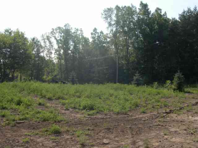

Not sure if your tractor will handle a rockpicker or not. But I guess you could rake them once weeds are cut.
Do a walkaround search for the big rocks, get everyone inside, set you cutter higher and GETRDONE!
Spray with Roundup, or generic equiv and surfactant after. Lawn will be safe to plant well before fall.

I've started to bush hog down the rain forest and appreciate everybody's advice on spraying. I'm trying to figure out the best way to apply to a large area /forums/images/graemlins/confused.gif. I'm looking into a tow behind spray rig from TSC /forums/images/graemlins/cool.gif
