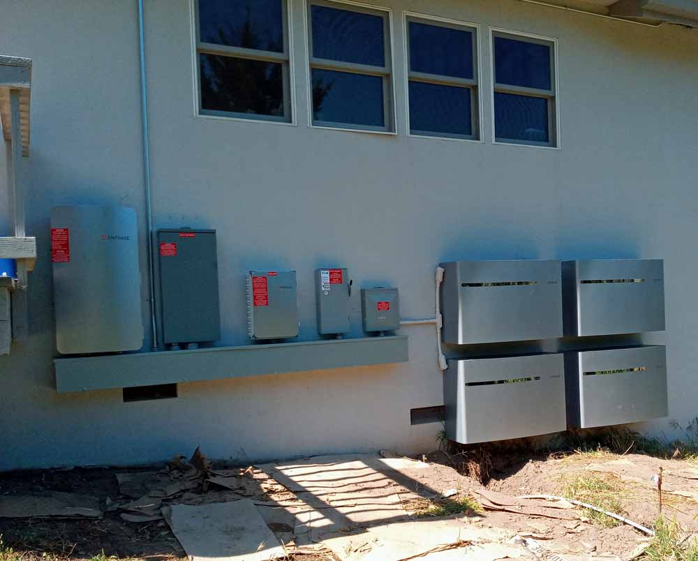

Our new neighbor on 5 acres just got their new Enphase solar system installed and working. 34 LG panels (13KW), with 4 Enphase batteries. $85K total up-front cost. Credits this year from the taxpayer will probably be about $30K, state and federal.
The switch to batteries when the power fails works seamlessly. The owner wants an EV to use more electricity as they now only have a PHEV. House is 3500sf with no shade and new A/C system. The lead time to get this system installed was just a few months.
I like the idea of battery backup (with or without solar panels) but I get no sun in the winter months.
We get very little sun November through February here, and we still had a less than 5 year ROI on solar. Since at the moment PG&E lets you bank energy generated in the summertime for use during the winter, it might work for you as well.
Try PVWatts for an estimate on how much solar you can put in. I know someone who just put in a big solar system and 5 Tesla Powerwalls in your area.
All the best,
Peter
I use 12KWh per day, year-round, for the past 20y. No A/C, since I have all-concrete house that stays cool. I do like the idea of a Li-ion backup battery, even if I don't have any panels.
Tesla did not even bid the neighbor's project. Not sure why, but others in our area have complained that Tesla quotes one #, then the project costs 50% more. Also, if you get their batteries, you must get their panels.
What is your electric use per day? Even with lower panel costs and subsidies, it is interesting you can make it work economically.
