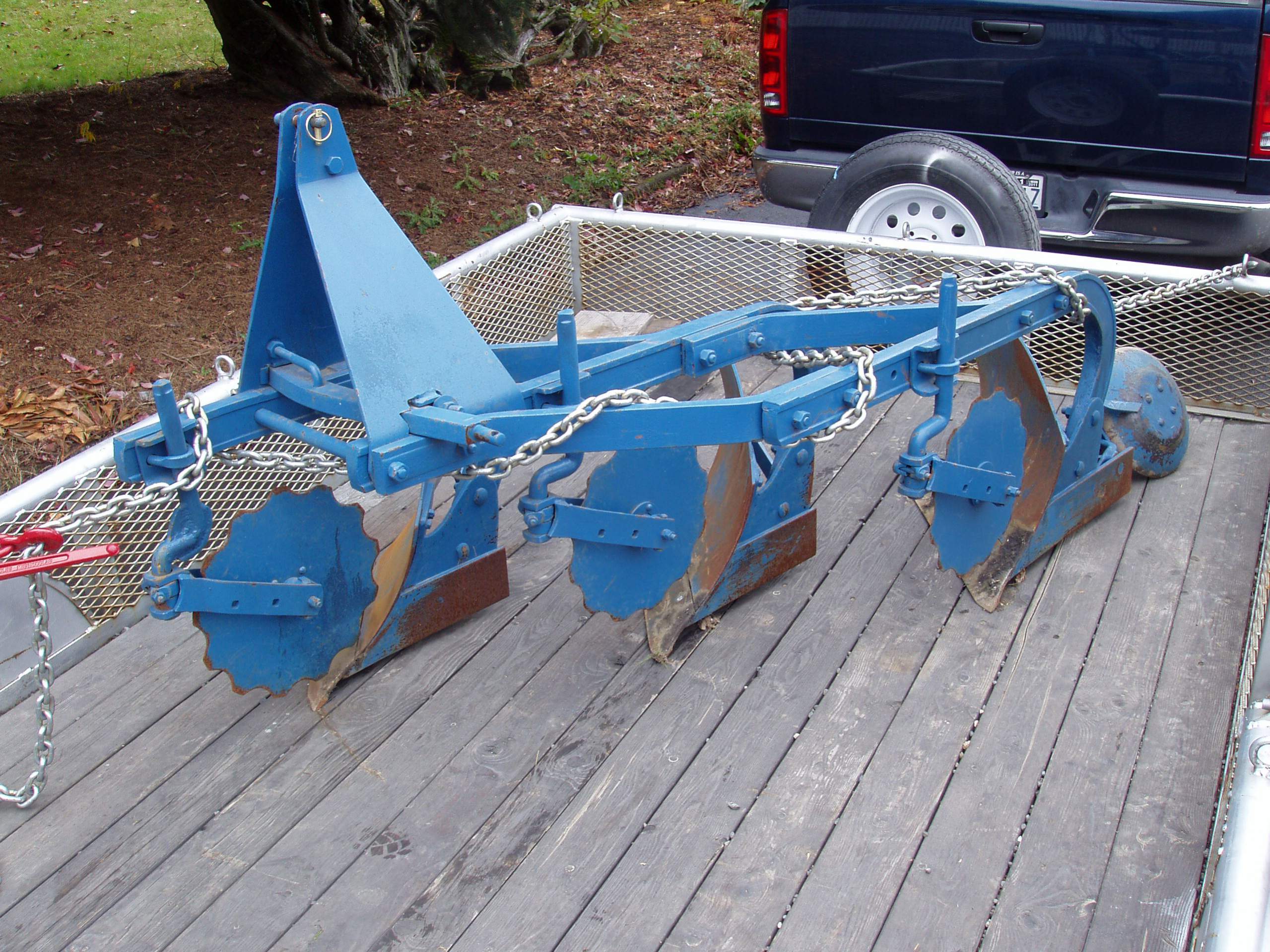

I'm pulling 3 16" and at 8" depth with my Mahindra 5530 4wd Turbo, AG1 tires, no ballast. The plow is a Ford/Dearborn 10-209 with coulters.
Paid $495 from a dealer.
